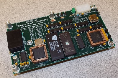

Each chip on the board has an MLCC bypass, as seen in the below image.
File comment: POC V1.1, Showing Bypass Caps
Here again, the MLCCs are placed as physically close as possible to the end of the device at which the VCC connection is present—you want the connection between the MLCC and the VCC pin to be as short as possible. Note that the clock oscillators are also bypassed—they can be a fertile source of noise.
