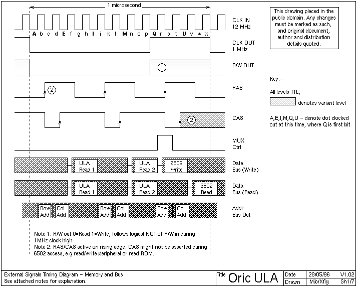

Re: How fast can the 65C02 or 65C816 run with "cycle stealin
See the Oric for an example of three accesses per cycle in a 6502 system:
