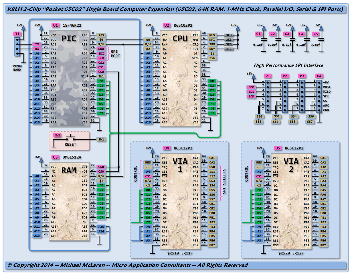

Posts: 633
Joined: 13 Feb 2013
Re: Another Bootstrap for a ROM less system
Post by Michael »
cbscpe wrote:
Note that this is only a concept. Before I jump into this I first wanted to check if this really is feasible or if there is something that is obviously wrong or will not work.
You should be able to get this to work. It seems similar to the "blind loader" method I implement using a PIC in my designs (which include the address decoder function in the PIC as well).
I've included example loader code below which copies a pseudo ROM image from PIC flash memory at $E000..$FFFF to 65C02 RAM memory at $E000..$FFFF.
Good luck on your project, Sir.
Cheerful regards, Mike
   *  R65C02 Reset Sequence (decoder off), FFFC = ioloc             *
     reset_pin = 0;             // reset lo
     cyc_rd(); cyc_rd();        // 2 clocks
     reset_pin = 1;             // reset hi
     cyc_rd();                  // clock 1
     cyc_rd();                  // clock 2
     cyc_rd();                  // clock 3
     cyc_rd();                  // clock 4
     cyc_rd();                  // clock 5
     cyc_wr(io_lo);             // clock 6, Rd FFFC = ioloc lo
     cyc_wr(io_hi);             // clock 7, Rd FFFD = ioloc hi
   *  copy code to RAM (decoder on)                                 *
     tblptrl = 0x00;            // point to rom image
     tblptrh = 0xE0;            // at E000..FFFF (8K)
     tblptru = 0x00;            //
     do                         // copy rom image to ram
     { loader(0xA9);            // R DF00 A9, LDA #$nn
       asm tblrd*               //
       loader(tablat);          // R DF01 nn
       loader(0x8D);            // R DF02 8D, STA $hhll
       loader(tblptrl);         // R DF03 ll, aaaa%256
       loader(tblptrh);         // R DF04 hh, aaaa/256
       loader(tblptrh);         // W hhll nn, write op
       loader(0x4C);            // R DF05 4C, JMP ioloc
       loader(io_lo);           // R DF06 00
       loader(io_hi);           // R DF07 DF
       tblptrl++;               // bump pointer
       if(tblptrl == 0)         //
       { tblptrh++;             //
         put232('.');           //
     } while(tblptrh);          // until rollover from 0xFFFF
     crlf();                    //
   *  complete the reset (jmp (fffc)), run 6502 code                *
     loader(0x6C);              // R DF00 6C, JMP ($FFFC)
     loader(0xFC);              // R DF01 FC
     loader(0xFF);              // R DF02 FF
     loader(0xFF);              // R DF02 FF (extra cycle)
     loader(0xFF);              // R FFFC ll
     loader(0xFF);              // R FFFD hh

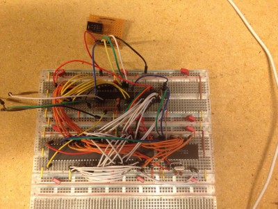

Almost finished breadboard layout
What is missing are the various pull-ups (IRQ, RES, NMI ...) and a final check and then I will power it up.
