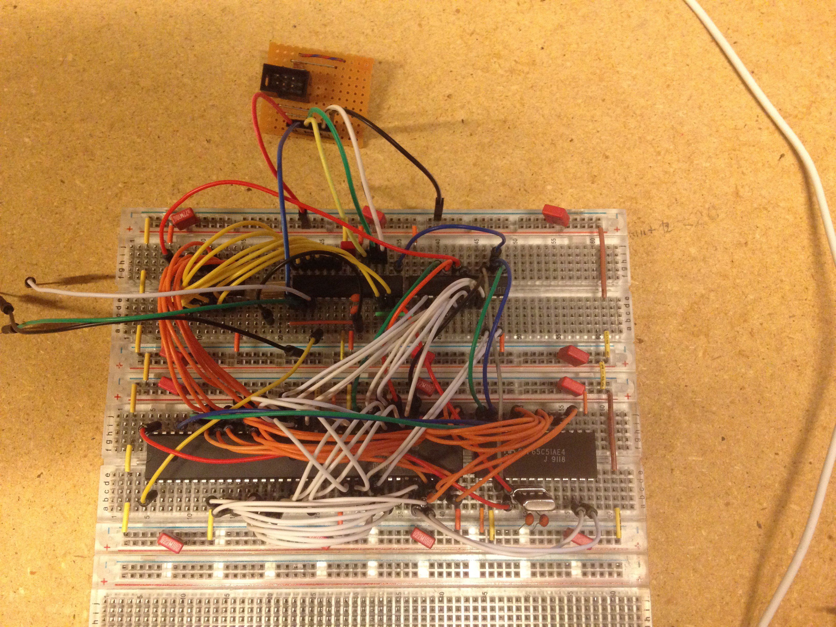

Hi,
several times there have been topics regarding bootstrapping a 6502 (or other systems) and the issues regarding slow ROMs in fast systems. Currently I have solved that using a DP-RAM that is used to bootstrap the 6502 and at the same time is the frame buffer for the VGA output.
But now I wanted to make a system without a video controller and with much less components. So I came up with the following solution.
File comment: CPU, Memory, Decoder and AVR
bootstrap-design.pdf [24.75 KiB]
Downloaded 232 times
Note that this is only a concept. Before I jump into this I first wanted to check if this really is feasible or if there is something that is obviously wrong or will not work.
The memory decoder is a simple decoder that supports two memory maps selected with IML (short form for Initial Machine Load). When IML is Low addresses $0000 to e.g. $BFFF will select the RAM for read and writes, addresses $C000..$C0FF decode to one of the IO select signals and for addresses $C100..$FFFF selects the RAM only for read accesses. When IML is High the RAM is only selected for write cycles, but not only for $0000..$BFFF but as well for $C100..$FFFF. Bootstrap is achieved via the AVR that controls RESET and PHI and during startup makes the 6502 think that he reads a ROM image, when in fact the AVR just emits the bytes that would be expected.
Here is the AVR code I have written so far for that purpose.

The trick here is not to control the address bus. Instead after a reset of the AVR we control the PHI2 via Software and put out the bytes the 6502 would read when we really had a ROM. The ROM we present is rather small, it is a RESET vector and 3 instructions that just write immediate data to the memory in a loop. As the RAM is write enabled this loop can now load a ROM image. After the image is loaded IML is de-asserted and the 6502 is RESET and start the ROM with it's own reset vector

I think the broad idea is sound - and simple - and a good idea. But I haven't reviewed your code or anything.
You should be able to get this to work. It seems similar to the "blind loader" method I implement using a PIC in my designs (which include the address decoder function in the PIC as well).
I've included example loader code below which copies a pseudo ROM image from PIC flash memory at $E000..$FFFF to 65C02 RAM memory at $E000..$FFFF.
Good luck on your project, Sir.
Cheerful regards, Mike

PostPosted: Tue Jul 21, 2015 7:34 pm
Posts: 491
Location: Switzerland
Hi Jeff,
ok now I get a clearer picture of what you meant. As for the AVR pins, when set as input (DDRD.n=0) they have a very high impedance. I already have started the prototype
File comment: Almost finished breadboard layout
What is missing are the various pull-ups (IRQ, RES, NMI ...) and a final check and then I will power it up.
