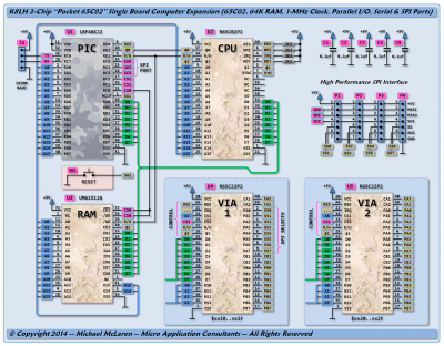

Hi,
several times there have been topics regarding bootstrapping a 6502 (or other systems) and the issues regarding slow ROMs in fast systems. Currently I have solved that using a DP-RAM that is used to bootstrap the 6502 and at the same time is the frame buffer for the VGA output.
But now I wanted to make a system without a video controller and with much less components. So I came up with the following solution.
File comment: CPU, Memory, Decoder and AVR
bootstrap-design.pdf [24.75 KiB]
Downloaded 233 times
Note that this is only a concept. Before I jump into this I first wanted to check if this really is feasible or if there is something that is obviously wrong or will not work.
The memory decoder is a simple decoder that supports two memory maps selected with IML (short form for Initial Machine Load). When IML is Low addresses $0000 to e.g. $BFFF will select the RAM for read and writes, addresses $C000..$C0FF decode to one of the IO select signals and for addresses $C100..$FFFF selects the RAM only for read accesses. When IML is High the RAM is only selected for write cycles, but not only for $0000..$BFFF but as well for $C100..$FFFF. Bootstrap is achieved via the AVR that controls RESET and PHI and during startup makes the 6502 think that he reads a ROM image, when in fact the AVR just emits the bytes that would be expected.
Here is the AVR code I have written so far for that purpose.

The trick here is not to control the address bus. Instead after a reset of the AVR we control the PHI2 via Software and put out the bytes the 6502 would read when we really had a ROM. The ROM we present is rather small, it is a RESET vector and 3 instructions that just write immediate data to the memory in a loop. As the RAM is write enabled this loop can now load a ROM image. After the image is loaded IML is de-asserted and the 6502 is RESET and start the ROM with it's own reset vector

I think the broad idea is sound - and simple - and a good idea. But I haven't reviewed your code or anything.
You should be able to get this to work. It seems similar to the "blind loader" method I implement using a PIC in my designs (which include the address decoder function in the PIC as well).
I've included example loader code below which copies a pseudo ROM image from PIC flash memory at $E000..$FFFF to 65C02 RAM memory at $E000..$FFFF.
Good luck on your project, Sir.
PostPosted: Mon Jul 20, 2015 12:43 pm
Posts: 491
Location: Switzerland
Hi Michael,
thanks for confirming that it works (as can be seen by your project). That's good to know that you already managed to put it into practice. In the meantime I thought about two extensions to my initial design. First I will add a 3-state buffer between the AVR and the data-bus, to avoid conflicts at the falling edge of PHI2 when the AVR is still driving the bus and the 65816 will emit the bank address (the goal is to use it with 65816 of course) and the second change will be that I will connect VP to one of the AVRs input so instead of counting the number of cycles after reset is de-asserted I just wait until VP is asserted (even the number of cycles after a reset is known and fixed) to start sending bytes.
