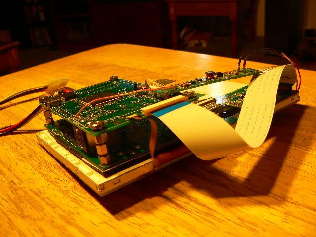

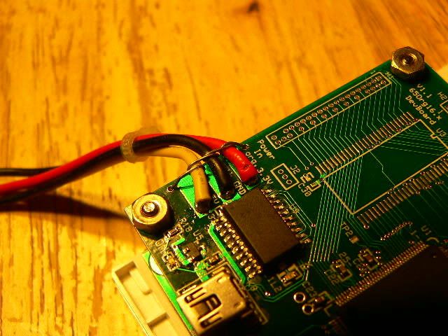

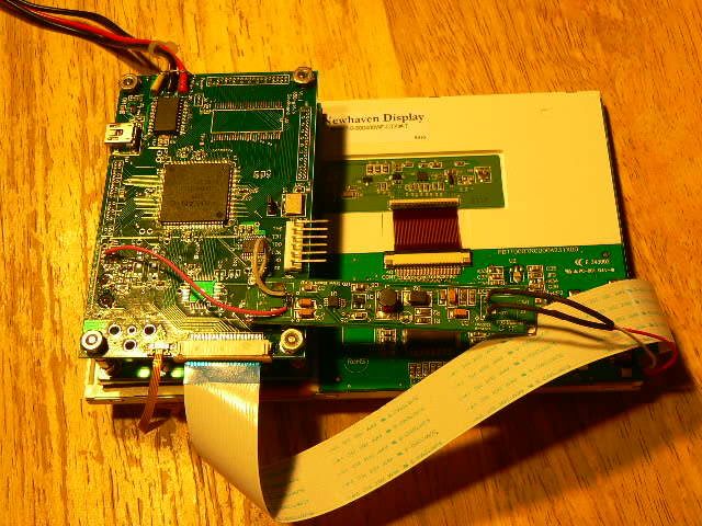

Here are some pics of the construction. No soldering errors this time!
Errors: Silkscreen is covering where I wanted to solder main power wires, but those wires have been secured the way I've envisioned!
I've used 3M double sided tape on a V1.0 board and use it as a mount for the V1.1 (on top) with some vertical standoffs to position it to make room for the PS2 keyboard connector that is shown on the left, on the bottom. Also in the forefront, is the 4-pin .5mm FFC, for the touchscreen panel, and the 20-pin 1mm FFC cables and connectors, for the TFT display.
Here you can more clearly see the interconnections. The small board on the bottom right, with 2 wires going in on the left and 2 wires going out, is the DC-DC converter for the LED backlight driver for the TFT. I initially tried 3.3V in, but it was using large amounts of current as it was dragging the 3.3V supply down to 2.5V. Thankfully no damage was done to the board.

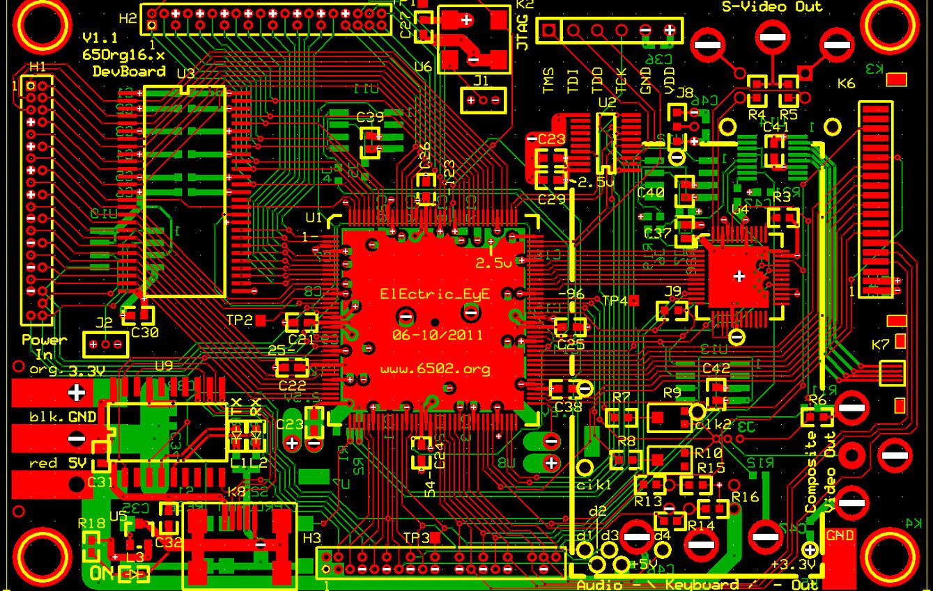

Here is the V1.1 DevBoard Layout:

EDIT (1/20/2012): Added Board Layout and Schematic.

PostPosted: Sat Oct 29, 2011 10:32 am
Hi EEye
could we have a link to your v1.1 layout please?
Ta
 Post subject:
PostPosted: Sat Oct 29, 2011 1:15 pm
Hi EEye
Ta
Sure, here it is. It should be updated to the final tonight, but what you see in the link now is next to the last "progression", i.e. I had 15 progressions before V1.1 was completed. (1 via was switched from H1 to near U13, and labelling is different for audio.). I was really starting to go off on a tangent for the audio. In the end I think the sound board will be a daughterboard utilizing the 3 Headers, and not just the pins as I have them labelled.
 Post subject:
PostPosted: Sat Oct 29, 2011 1:31 pm
Thanks! I was a bit confused because this 144-lead FPGA looks on your photos like it has only 72 leads - must be just because they can't show the detail. Soldering at 0.5mm pitch wasn't too bad?

PostPosted: Sat Oct 29, 2011 2:37 pm
I had used 640x480 for the camera for small pictures. I got some decent detail with the closeup on the first pic though, despite the low res...
As far as soldering, as what's been said before in other parts of the forum and the internet, using flux is critical. I use a needle like dispenser with a fine point. I used no solder at all on the FPGA. The flux allows you to see the solder flow underneath each pin.
What has not been mentioned so much is the condition of the eyesight of the one doing the soldering work! I am extremely near-sighted, so when I do my soldering without my glasses, I see it very clear about 2-3in from my eyes. When I do need magnification when things are suspected short, I use clip-on lenses with my glasses. Talk about eye strain!

P.S. The board layout link has been updated and now reflects 100% what is seen in the pics.
