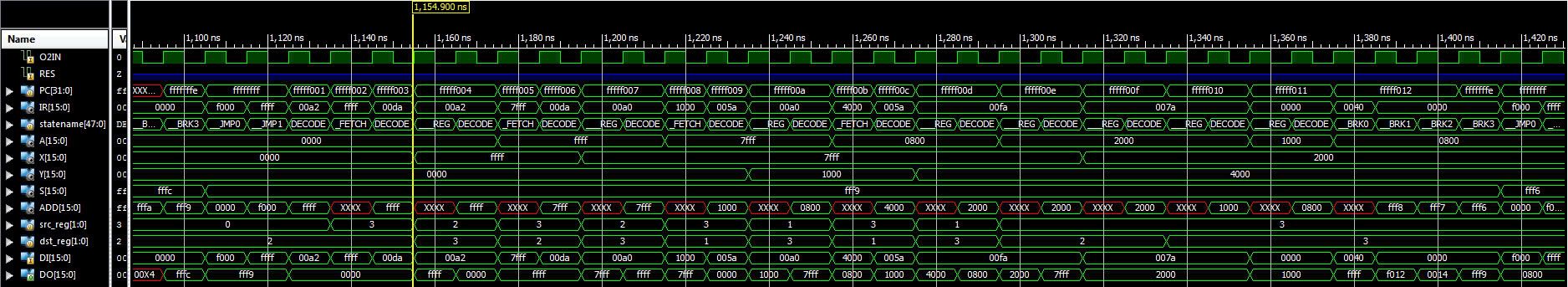

PostPosted: Wed Sep 07, 2011 3:27 pm
Ok, I can't say I'm learning yet. I thought doing PHX, PHY, PLX, and PLY would have been easier, but I am still digesting the flow of it. At the same time I had to make adjustments to my testbench to accomodate the 4Kx16 .bin file that Bitwise's assembler makes. I was using address decoding for 8Kx16, for my earlier experiments using a hex editor. I really need to look at the HDL equivalent of the address decoding and study it. So many wires in schematic entry is a pain, especially when working with 32-bit addresses!
I'm happy to say a simple program I've made below appears to be running in ISim.

I need to head out for abit, but when I return I can run a Sim and post it. Which signals should we be focusing on? I know we will want to look at PC[31:0], IR[15:0], statename [47:0], X[15:0] and Y[15:0].
and also A, S, AI, BI, ADD, DI, DO, src_reg, dst_reg. That should cover most of the data path between stack and registers.

PostPosted: Wed Sep 07, 2011 5:41 pm
I was able to fit the entire loop of the program I previously posted, into the pic. I thought the src_reg and dst_reg were 16 bits looking at the code, after all they are transferring data between the A,X,Y, and Stack registers. I wish I could tell if it was working.
 Post subject:
PostPosted: Wed Sep 07, 2011 5:46 pm
They are 2 bit wide, and only contain the index of the register. See lines 75-82. So, whenever src_reg is equal to 2, that means that X is the source.
By the way, your code isn't working. The PHX instruction should cause a state = PUSH0, but it's going to REG instead.
This is because the $00da opcode is covered by line 893:
8'bxxxx_1010:   state <= REG;   // <shift> A, TXA, ...  NOP
You'll need to change that pattern so it doesn't cover the new opcode(s)
