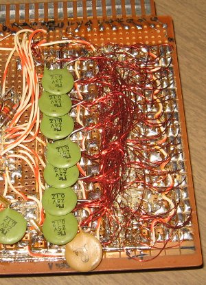

Do you think .25mm is too fine? I don't know what it is like to work. I'm concerned it'll be a bit like hair and won't be stong enough to take the loads or hold its shape once bent into position.

These people (roadrunner) sell wiring pens and plastic combs (which they call glue strips) - somewhat cheaper than verowire's parts, I gather.
Their wire is 0.15 or 0.19mm!
The plastic combs help a lot with keeping the result tidy - you end up with manhattan routing rather than point-to-point. Like this (our 65816 add-on for a Beeb):

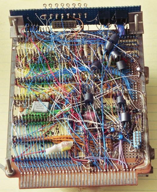

micro_brain, here is the back of an LED display board I made for my first home-made computer (shown here), using enameled wire that was about .35mm diameter:
This was in 1985. It was much harder to work with than wire wrap, but I wanted the board to be thin. Yes, I did break some wires, because they had to be bent back and forth to give access to adjacent places I was soldering, and there was also the problem of defeating the enamel insulation accidentally with the soldering iron while trying to solder a different wire next to it. I would never do it again. Wire-wrap, when done correctly, is faster, totally reliable, and probably allows better density.

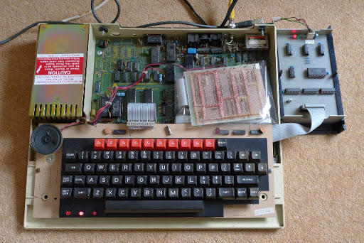

Below is my wire-wrapped workbench computer (with outdated pictures and diagrams shown here before subsequent expansion), with wall-to-wall parts, obviously done with wire-wrap:
Your ideas will never stop evolving, even to build what you think would be best at the time you start the build. I have done a few iterations though and evolved and expanded my primary workbench computer for nearly 20 years now. For many of those years I was planning my next workbench computer to have more I/O (especially different expansion buses), more speed, more memory, etc., but as I gained experience with what I had on the workbench, I found ways to expand it which breathed new life into it, and I began to see that the expansion buses and various things I thought I needed were not only unnecessary, but were getting so complex that I wouldn't live long enough to carry out my ideas.

Thanks for the great advice and lovely pictures! Liking the Beeb, Ed. Gareth, I thought about the possibility of accidentally going through some insulation whilst soldering another wire, and I am going to have to pay close attention to the routing to try and reduce the possibility. GS's back picture doesn't look as dense as your LED board, so I may be in luck.
Fortunately, the Vero pen turned up this morning so I could start as I have all the other components apart from the 6502 and EEPROM programmer / eraser (from China - TOP853).
I have to say, I'm not sure what wire is in the pen, but it looks awfully thin to me... still... "Who Dares Wins" :)
[EDIT : OMG It's .2mm!!! Argghhh!]
