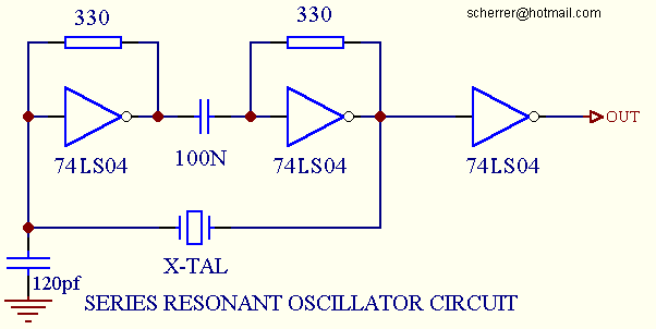

I found something that looks similar to the crazy 24Mhz rig I have ended up with:
The author's description states that it outputs the fundamental frequency of the crystal; I assume this means 8mhz for my crystal (ie, perfect). In order to implement it I only need a pair of caps; I have the resistors and there is a spare inverter on the LS93 for the buffering.
Any comments..? Can anyone explain the effect of the capacitor / resistors on the output frequency in plain English, please?
Web page is here http://www.gaby.de/z80/uexosc.htm

That's a good find. I can't explain it, sorry. The capacitor to ground looks somewhat like a low-pass filter, I think. (Because high frequencies see capacitors like shorts, so they see the capacitor as a short to ground, whereas low frequencies see capacitors like opens, so they don't see the connection to ground.) The resistors, as I understand it, are just biasing the inverters to their mid-points so they act as sensitive amplifiers.

Ed's and bogax's explanations are probably as good as you'll get, as resonant oscillators involve some rather heavy math with the S-plane and so on, which is why it's often best to just use the complete crystal can oscillator modules. Otherwise, even with experimentation, you might come up with something that seems to work right but then goes nuts when you build it again with a slightly different layout or unforseen operating-condition changes come along, whether it means different temperature, different amount of stray capacitance or inductance somewhere, etc..
As for the decoupling capacitor, there should be one of .1 or .01uF from the +5V pin to the ground pin on the IC with the connections and leads absolutely as short as possible from the capacitor body to the IC pins. This is for reducing inductance, not resistance.

TTL oscillators never worked for me. I've always had much more success with CMOS CD4069 inverters. The CMOS oscillators have much higher values for the resistors in the oscillator circuit, hence my earlier comment about the values being too low. If they're correct, then I guess they're correct for TTL...

- fit a 100nf cap between the inverters in the clock circuit. The clock runs at 8Mhz just fine, with the 470R resistors. I haven't bothered with the 120pf earth cap.
