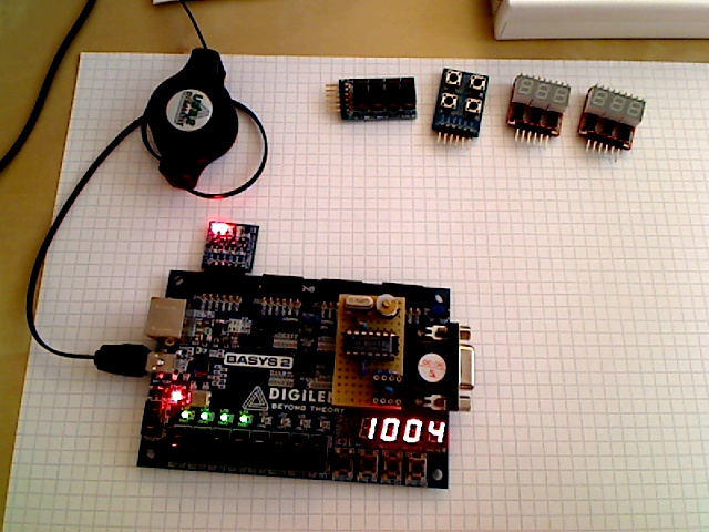

Hello BigEd,
I have made a picture of my small setup that I use to play with the T65 core.For different reasons I unfortunately have not made big steps until now.I also single step through hardcoded programs.I use the T65 version from fpgaarcade.
I have tried to understand a little how the T65 core works.
The big parts are the ALU and the MCODE modules.Both are pure combinational modules as far as I understand.
I have also commented the MCODE module with the instructions.It is very difficult to find something in this *very big* "case ... when" statement.
The main signal that lets all things flow is the "MCycle" in the main loop.Every instruction defines a "LCycle" for last cycle(?) and depending on the IR (instruction register) and the "MCycle" several control signals and multiplexers are set.
I have not understood where PHI1 and PHI2 are! Every time I do one step, one PHI1/PHI2 cycle is done.I thought I would have to do two steps for one cycle because the 6502 is working on both edges of the clock!?
Anyway,first I have to connect two more 7 segments from OHO so that I can also see the input and output data busses.I would also like to be able to see the MCycle and LCycle signals for the current instruction.OHO has some example code to control the modules.
The onboard switches and leds I would like to have them as I/O ports.
I will also take a look at the other 6502 cores but personally I will stay with the T65 because I have already spend much time with it.
Also the work you are doing with the visual6502 is very interesting.I cannot run the program,I only have the windows explorer and it is not working,I do not know why,I have no knowledge in java.
Ok,this is much work to be done!
Greetings,
Vassilis

Hi Vassilis
good to hear of your progress and see your setup.
visual6502 is taking all my time at the moment. It's javascript, not java, but you do need a modern browser. It's possible IE9 might work. Chrome works well- it's an easy download/install and very uninvasive. You don't have to lose your normal browser.
As for clocking, the modern convention is that everything uses edge-triggered flops, and all the combinatorial logic sits between the flops. The 6502 used transparent latches, with two non-overlapping phases, and was able to place logic between any pair of latches. It's harder to design things that way, but it offers more freedoms. The result: people probably had to work quite hard to code up in a modern design style, but they did it.
I think the main part of chip behaviour - visible from the pins - which cares about clock phases, would be the databus being undriven during phi1. That's a simple fix to the pad tristates. (It might be that the interrupt inputs care about the clock phase, but it would be difficult to see that difference in practice.)
Maybe you can share your commented T65 code and it could be merged back ... somewhere? I'd be interested to see it, anyway.
RDY is an important signal to watch out for, since if it's asserted close enough to the phase-2-to-1 transition, it will not be recognized and can introduce accidentally introduce a wait-state.
