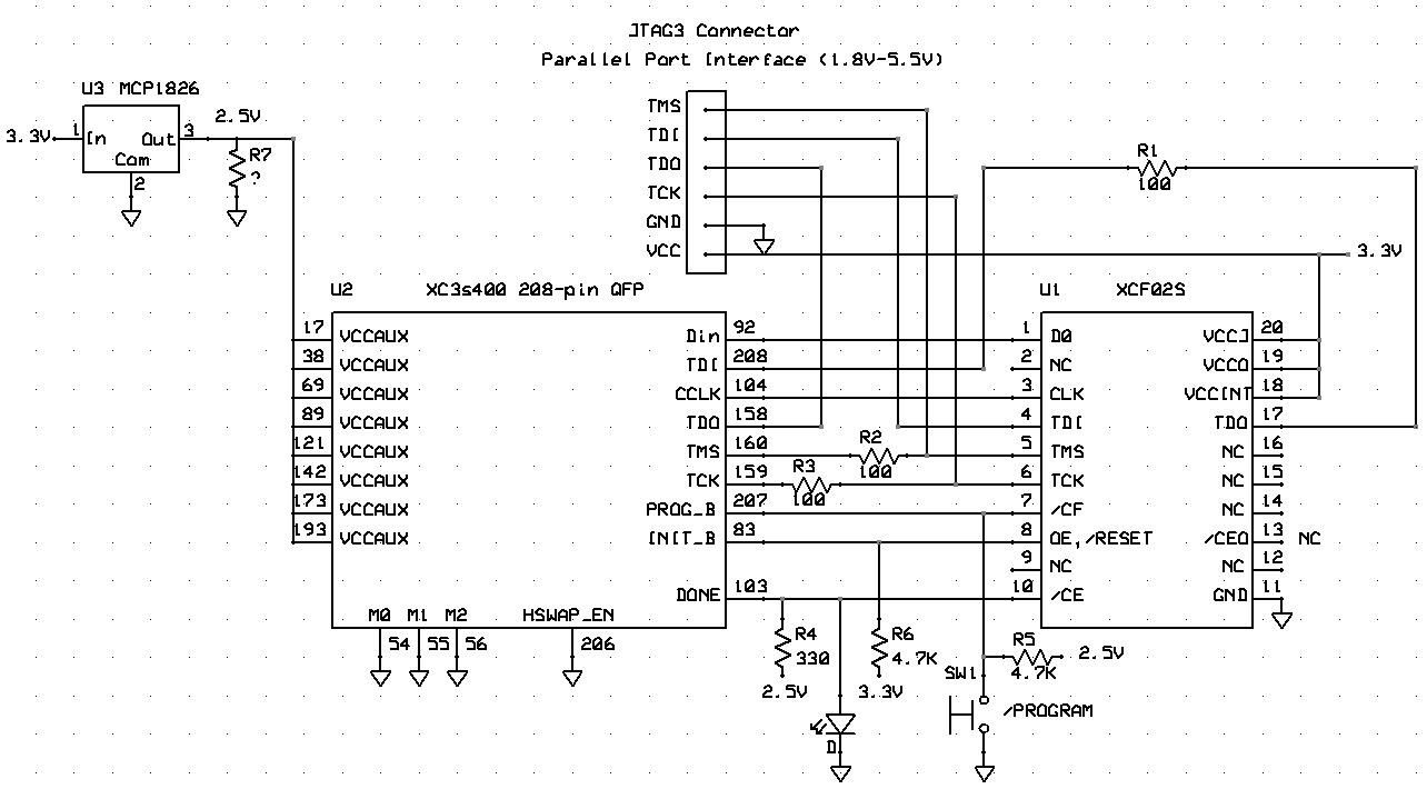

Speaking of JTAG, I almost forgot I'm using a serial config PROM in Master Serial mode. I'm new to this, but this much I have gathered from the Spartan 3 Configuration Guide on Pg.82, the associated appnote and the Digilent schematic mentioned b4.
I am unsure what to do about the resistor from VCCAUX(2.5V) regulator to GND mentioned in the appnote (R7 below, when the pic updates...). The value there is ~240ohms. In the Digilent schematic it is a 2.2K resistor?!...

I wired all power connections and most of the schematic above, including power to the DS1085L, except the LED, PROGRAM button, and R7.
Very hesitantly switched power on while iMPACT was running and did a boundary scan. Guess what? The smoke came out all over the place! Just kidding, iMPACT saw the XCF02S PROM and the XC3S400 Spartan 3!!!! I may have the courage to leave the power on abit longer now...
Time to power up the scope and check out the anticipated 45MHz (with my 40MHz probes :cry:) out of the DS1085L... No bypass caps yet.

Got the voltage levels correct, locked the pin assignments. Wired the display connector. Rewrote the display init, and clearscreen routines for original 6502. Assembled it, and saved the file as a binary image (.65b). Renamed it to .bin. Opened it up in a hex editor and added the reset vector. Converted the .bin to a .coe file with your .coe converter (version 2). Went back into ISE and updated the ROM using Block Generator. Successfully resynthesized everything and generated the .bit program file. Powered up the 6502SoC and went into ISE iMPACT and successfully programmed the PROM using the PROM file formatter. iMPACT sees the PROM and FPGA and I can read device codes from both, also blank checked the PROM, and it is not blank.
So my JTAG interface seems reliable, however nothing is happening when I push the /PROGRAM button. No clock signal out of the FPGA (pin 3 of the PROM). I realize I still have not put in an R7 (pg.6), which may prevent the circuit from 100% functioning, but I think I should still see some kind of clock signal. Will check my wiring.
WOOPS, found 47K resistors. Should be 4.7K. I need better lighting! Forgot to wire the mode pins and hswap pin. Now getting 6MHz out of the FPGA for a sec after powerup, and when pressing /PROGRAM button.
Reread the configuration section on the datasheet and changed a few things to comply...
PROM voltages on PG. 8 of XAPP453 and Pg. 47 the Spartan 3 datasheet are not jiving... Going to be trial and error

HOORAY HOORAY HOORAY!!!!!! Success!
Initially I saw constant activity on the databus. When I hit the /PROGRAM button, the display's /CS line would go low for 3 times then stop. Looked like something was crashing, so I divided the Phase 2 internally down to 10MHz and brought it out to the display and bam! It worked!
I think the display is the limiting factor. There are 2 software delays present in the init routine. Could be it's not getting enough time running @45MHz. I think the core is running fine @45MHz as evidenced by the active databus. I will try lengthening the delays.
I will post an updated schematic of the JTAG interface soon. Now the fun begins!
After a few more tests (Down to 2.8MHz right now), I can say the display is getting data and the screen is clearing. But when I try to INC the 3 color variables, which are stored in zero page, in a simple loop, the colors are not changing. I do a JSR to the CLRSCR routine within the loop and it appears to be running smooth, meaning the data stored in the stack for the JSR/RTS is being written/read successfully. Also, the reset is not working, it locks the system up. So not everything is perfect yet. I think I will start a new project file and re-input everything fresh, even though this version of ISE seems much more stable than earlier versions.
This is what I have for the JTAG interface.
