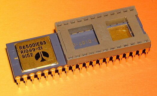

I think the perfect format for the '265 would be one like this one:
This is a Rockwell 6500/1EB chip. It's a complete computer in a chip, like the '265 is. But instead of a masked ROM, you have a socket that is wired to the address and data bus lines of the internal 65xx core, leaving the rest of the chip pins as "ports" and things like the clock, reset, power, NMI and others.
So you can write your code, burn it in an eeprom and plug it in the chip, that will run it as a ROM and its internal RAM. That way you can test your code, build prototypes and be sure that your design will be ready for mass production runs, using masked ROM. OR Use it like this in the productions runs, to be sure that the code could be fixed or updated later.
But again: the 65xx family are for me chips meant for MCUs, not computers. Yes, the '816 do have several optimizations as you experts say to be faster, but the way the memory is managed talks about the not need of having large chunks of code or data directly or linearly addressable like a computers CPU would need. Most of the programmers say that it's hard to get large amounts of code filling the memory so those 64K banks do perfectly fit the purpose of it.

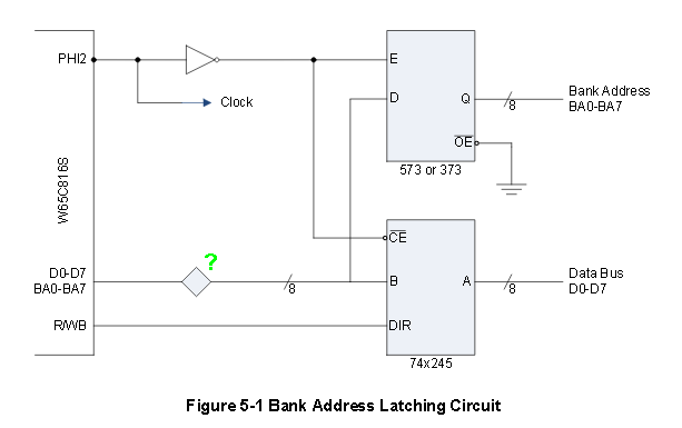

What about the hardware part of this? In its original form, having the chip work at its full data and address buses handling capabilities require the use of an external 'chipset'.
If you want to design a SBC that would act as a microcontroller, like many people do, having the chip short of external circuitry woukd be enough. But if you want to design a full 'user friendly' computer with sound and graphics and such fancy things, then you would have to look for vintage chips, go the FPGA way, look for chips that would work with the 816 as it is or again, design a chipset to handle the full 24 bit address bus and a 16 bit bus that isn't designed but can be implemented.
Can any of this affect the popularity of the 816?
Posts: 3526
Re: Not much love for the poor 65816?
Usually the hardware varies from pretty darn simple to mildly challenging. But you mentioned an un-usual goal, and I'll briefly deal with that before addressing commonplace scenarios.
A 16-bit data bus is an unusual goal, and in this post I show how a couple of latches and tristate buffers can implement that, for purposes such as connecting to that S1D13506 chip of yours. And your thread here deals with much the same subject. Sadly, 16-bit transfers don't double the speed of everything. That's because the '816 itself can only move one byte at a time over its 8-bit bus. But there is a significant speedup from having less code to execute. Specifically, there are fewer instruction bytes to fetch when only a single, 16-bit transfer is coded, as compared to coding two 8-bit transfers.
Moving to a more commonplace setting, most of us have seen the simple recipe below, taken from the '816 datasheet. (BTW I think the weird little diamond symbol merely denotes that that part of the bus is bi-directional. :) )
This is not a complicated circuit, nor does it involve a lot of chips. And it'll "play nice" with the rest of the system. Data Bus D0-D7 is very happy go lucky (ie, undriven 50% of the time, and thus extremely tolerant in regard to contention issues), and the '573 makes all the Bank Address bits available just as if the '816 had had 8 extra pins added. IMO this simple circuit results in a setup that's just as friendly as a 6502 or 'C02. Highly recommended. Just follow the recipe!
It's possible to deviate from the recipe and get an even simpler setup. The '573 can be omitted if you only want 64K and thus have no use for the Bank Address bits. And some forumites report success with bypassing (ie, omitting) the '245... which means memory and peripherals will "see" the BA bits on their data pins during Phi2-low (instead of the bus floating at this time). I'm not surprised by those folks' success but IMO bypassing the '245 may lead to trouble for beginners, whom I encourage to stick with the recipe.
