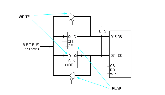

Well, here's an outline of what I had in mind for connecting to a device with 16 bit wide data bus, and I suspect it'll work for almost any chip, including S1D13506. It's just a question of whether you consider the extra logic to be justified by the benefit the S1D13506 (or other chip) provides.
The elements I've shown could be built as
  • a pair of 74xx646 registered transceivers (two 24-pin chips), or
  • two each of 574 and 541 (four 20-pin chips), or
  • a PLD could hold them.
There will also need to be some glue to wiggle the various control lines. The details aren't immensely intricate.
Interface to 16-bit device .png (7.64 KiB) Viewed 1665 times
Here's the behavior I had in mind. For performance reasons, I chose to exploit the '816 or '265's ability to generate both bus cycles with a single instruction (ie, with the m bit in the P register =0).
  • Read:
    cycle 1: 16 bit read of IO device. Lobyte straight to 65xx bus; Hibyte to temp reg.
    cycle 2: temp reg (the stored Hibyte) to 65xx bus.
    Write:
    cycle 1: 65xx bus (the Lobyte) to temp reg.
    cycle 2: Temp reg to IO device. 65xx bus (the Hibyte) to IO device. 16 bit write to IO device.
In your code you'll need to stick to simple loads and stores such as LDA BIT STA STY etc. Instructions like that always deal with the lowbyte first. But R-M-W instructions (INC DEC etc) are a no-no -- a minor limitation to keep in mind. The write portion of a R-M-W instruction will deal with the high byte first (according to WDC's '816 datasheet) and thus won't work as expected with this circuit.
