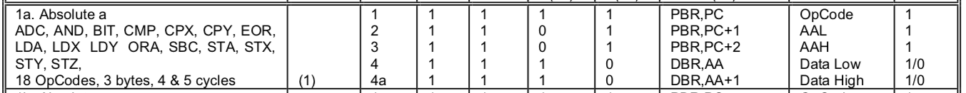

PostPosted: Tue Dec 15, 2020 2:42 am
Yes, that is true, RMW instructions operating solely on memory are affected by the M flag, just as ALU instructions involving the Accumulator are. The wrinkle is that read and write operations must each take 2 cycles to transfer 16 bits over an 8-bit bus, and for the interface circuit first proposed, the order of those half-transfers is important. Reads are always low address first, but writes are sometimes low address first (eg. STA) and sometimes high address first (eg. TSB, TRB).
A circuit which assumes low address first (as above) and thus latches reads on the low address and commits writes on the high address, can still be used with the 8-bit versions of the R-M-W instructions, provided they are always used on both bytes in the correct sequence. However, that won't always give the correct results without some finagling. A circuit which commits writes on the low address would work for 16-bit RMW instructions but fail on plain 16-bit stores.
