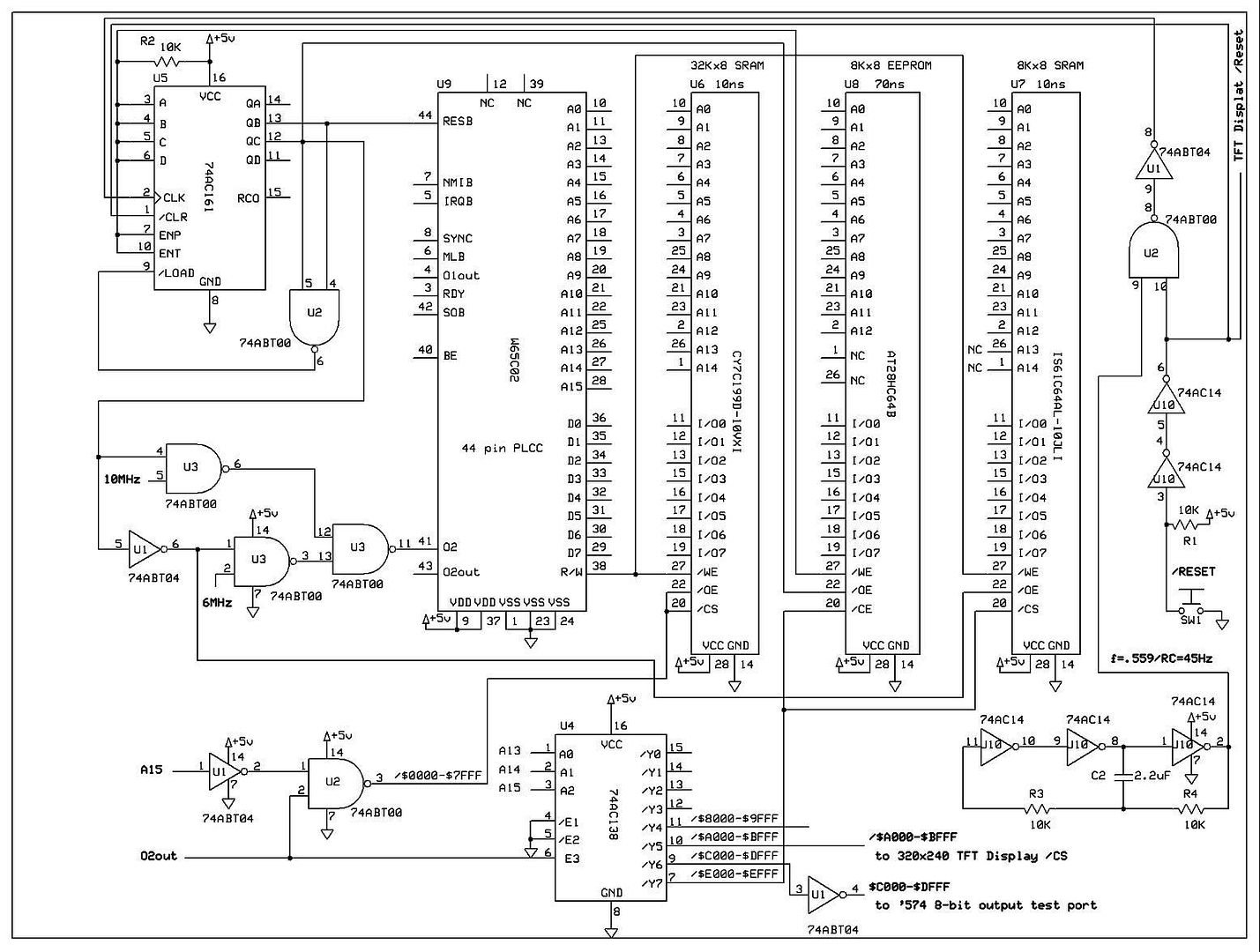

I got it working reliably up to 10MHz running the "OS" from 10ns SRAM and using all ABT TTL (except 1 AC138 which has a max prop delay of ~10ns). Using wirewrap is probably one of the main speed limiting factors.
Now it's time to replace all the discrete logic and use a 7ns ATF22V10C. Going to try using Atmel's free WinCupl & WinSim.
Once I get the SPLD progammed correct, it'll be time to make boards :)

Here's the final schematic:
10 MHz with a mess 'o wires is pretty good. Sounds like you're on your way. :)

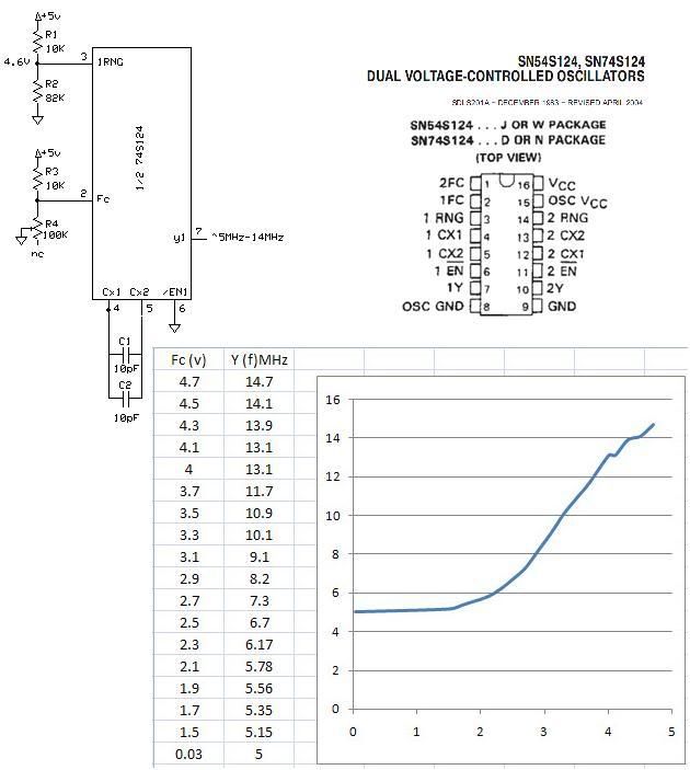

Just thought I'd share this. It's a 50/50 duty cycle variable frequency generator. Only available in "S" series TTL. It can go up to 60MHz, sort of a current hog, but I used it and even though there is a little bit of jitter looking at the waveform on the scope, it is reliable for phase 2 in on the W65C02, even up to 10 MHz. The jitter did not seem to interfere with code execution. Also, it has sep, analog and digital grounds. I made the table from my measurements.

PostPosted: Fri Jan 29, 2010 2:02 am
Ain't gonna work...
For some reason, apparently the Atmel 22V10C part has a different programming algorithm than a GAL22V10. Daryl has had the same problem trying to program the Atmel part. Since the G540 programmer I used to program the Atmel EEPROM is not officially endorsed by Atmel to program their PLD's and since the G540's manufacturer recommended using the original GAL22V10's (thanks to both for responding to emails very quickly), I started looking up "qualified" programmers. Cheapest I found was about $350...
In the end, to make a long story short, I happened across the "hack-a-day" sight (I know someone else in here linked to the site before, they are top notch). I Googled a beginner tutorial on CPLD's and they do have a very well written up little blurb for beginners. I chose a Xylinx kit for $50.
http://hackaday.com/2008/12/11/how-to-p ... ices-cpld/
But, I can already see I'm going to have to modify it and remove the surface mount XC95xx chip and put a 44pin PLCC socket in there with a higher speed version. As hackaday pointed out PLCC and/or 5v devices seem to be a dying breed. I was able to pick up a few 10ns versions.

I know I should've started out learning PLD's from the simplest IC's, that was my intent. But I'm going to try my hand at learning Verilog with the software that is coming with the XC9572 eval kit. Even these kits have been discontinued by Digilent, only old stock is selling. How far behind am I!... Looking forward to learning Verilog, and the other tools, and work up to the Spartan 3 series FPGA... After doing some research, Xylinx becomes the obvious choice, just because of their support software.
I also found out by posing a few questions on New Haven Display's forums, that the max frequency for the E (phase 2) signal on my 320x240 TFT display is 10MHz, which explains my top 65C02 speed. So I'd bet money my CPU section can go above this if I had a display that could handle the faster speeds. Their 640x480 8-bit display can go up to 55MHz. Even though it uses a different controller IC, data seems to be written in the same manner, so my software will be compatible. When I get some spare $, this display will be my next purchase. I really want to see if 14MHz is a conservative rating for WDC's 65C02. 20MHz would be very nice.
So my plan is, when I get the new 55MHz 640x480 display, to use it in my current wirewrap design with the latest schematic posted on this thread (I WILL be replacing the 'AC138 with an 'ABT20 dual 4 input NAND gate, 1 gate will address the EEPROM & SRAM and the other gate will address the display, I just need to find a PDIP version)... The old display I'll be using, since I know EXACTLY how it works, with a new wirewrap board using the XC9572 for memory decoding, since speed will not be the issue (successfully programming the CPLD will be the issue), I'll run it at 6MHz, and continue to update that project on the Fuel Injector Pulse Width Analyzer thread.
