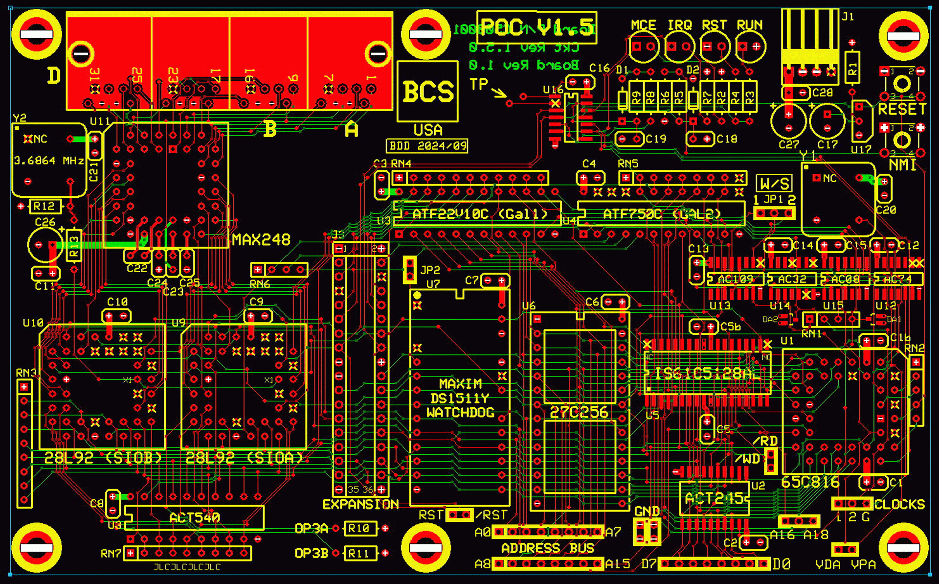

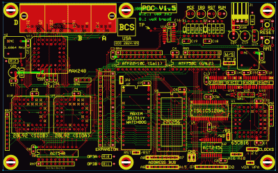

I’ve got a PCB layout done for POC V1.5. The board dimensions are 6-1/2" × 4", and it is in four layers.  I found that by positioning the SRAM and the data bus transceiver east-west, it was easier to make the connections without an excessive number of vias.  I also tinkered a bit with the schematic to add numerous test points that I can use with the logic probe, scope and/or logic analyzer to observe circuit operation.

Nice board layout, BDD. I assume the inner layers are the power.
But so many pullups? Doesn't the GAL pull to the rail? Or is it an open collector output?
And I'm unsure about the db[0..7] outputs after the buffer from the processor... high bits of the address? I'm only vaguely familiar with the 816.
Posts: 9425
Re: POC Computer Version One
The inner layers are power and ground.
A GAL has TTL-level outputs, not CMOS, with a guaranteed VOH of 2.4, well below what constitutes a valid CMOS logic 1 in a 5 volt system.
In my post about the GAL test rig I built, I mentioned that I did some output voltage checks.  I discovered that while a GAL could drive its unloaded outputs a little past 4 volts, the voltage quickly deteriorated with loading.  Assuming that an unambiguous CMOS logic 1 occurs at 70 percent of VCC, that would be 3.5 volts in a 5 volt system.  A GAL’s outputs barely stay in that range under load, so there is a risk of noise-sensitivity.  Of course, “under load” when driving a CMOS input mostly means charging parasitic capacitance, since CMOS devices draw virtually no input current when the voltage is steady.  Hence the use of the pullups is mainly to assist the GAL in charging the parasitic capacitance.
The 65C816 multiplexes the A16-A23 address bits on D0-D7 during Ø2 low.  A transparent latch, GAL2 in this design, is used to capture and latch those bits—actually, A16-A18—and drive them onto the corresponding inputs of the SRAM.  When Ø2 goes high, there is a small amount of overlap before the 816 stops emitting A16-A23 and starts treating the data bus as a data bus.  This overlap gives the latch enough time to close on the rise of the clock before the 816 “turns around” the bus.
However, the overlap period also creates a window of opportunity for bus contention.  During a read cycle, /RD will be asserted right after the rise of the clock and the selected device will start driving the data bus, possibly while the 816 is still emitting A16-A23.  The resulting contention may inject of a lot of noise into the power and ground planes due to the momentarily-high current flow.  The transceiver, which will be in the high-Z state during Ø2 low, will remain in that state during the overlap period, thus closing the bus contention window.
The bus pullups prevent floating while the transceiver is in the high-Z state.  The transceiver also acts as a level converter, as both the SRAM and ROM have TTL-level outputs, whilst the 816’s inputs are CMOS.

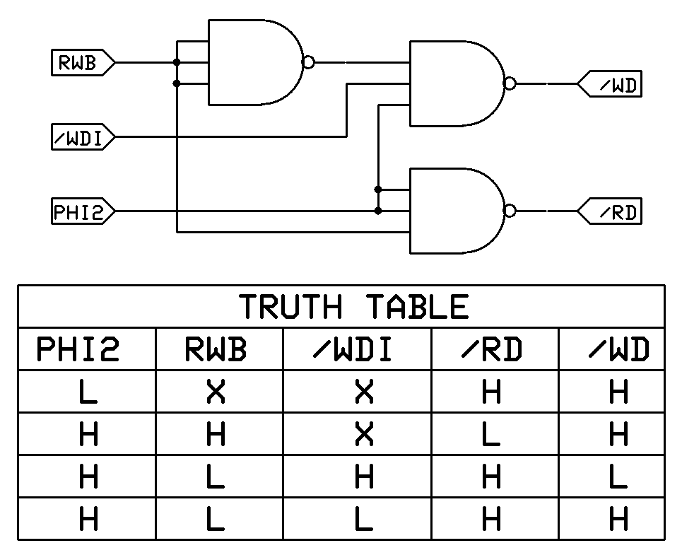

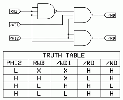

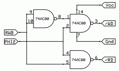

All well and good, but the discrete read/write logic that I have used in earlier POC permutations blindly assumes that when Ø2 is high, it’s okay to read or write.  Here is the discrete read/write circuit I have used in older POC units:
Read/Write Generation
In order to implement write-protection, I modified the above circuit so I can prevent /WD from being asserted when the effective address is $00D000-$00FFFF and ROM is mapped out.  It’s a simple solution:
Read/Write Generation w/HIRAM Write Protection
Operation is similar to that of the first circuit, except if the /WDI (write data inhibit) signal is driven low, the /WD output can never go low despite the MPU being in a write cycle.  The CPLD logic will assert /WDI if the expression VDA || VPA is true, the effective address is $00D000-$00FFFF and ROM has been mapped out.  Using a -7 version of Microchip’s ATF1504 CPLD, I’d expect that /WDI would be asserted about 19 nanoseconds after the fall of Ø2.  With a 20 MHz clock, I would have about 18ns of timing headroom before the rise of the clock.  Adding to that the time required for the NAND gate to react to the high-going clock input, and I think I will have bulletproof HIRAM write protection.
There are probably other ways of accomplishing this, but it is, as I said, a simple solution.  I was hoping to keep the discrete logic to an absolute minimum, but unless I go to a larger CPLD package, e.g., PLCC84 or QFP100, I don’t have enough I/O pins to put all the logic into the CPLD.
