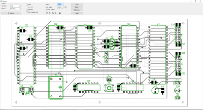

Here is the best I can do within Diptrace:
- Billy

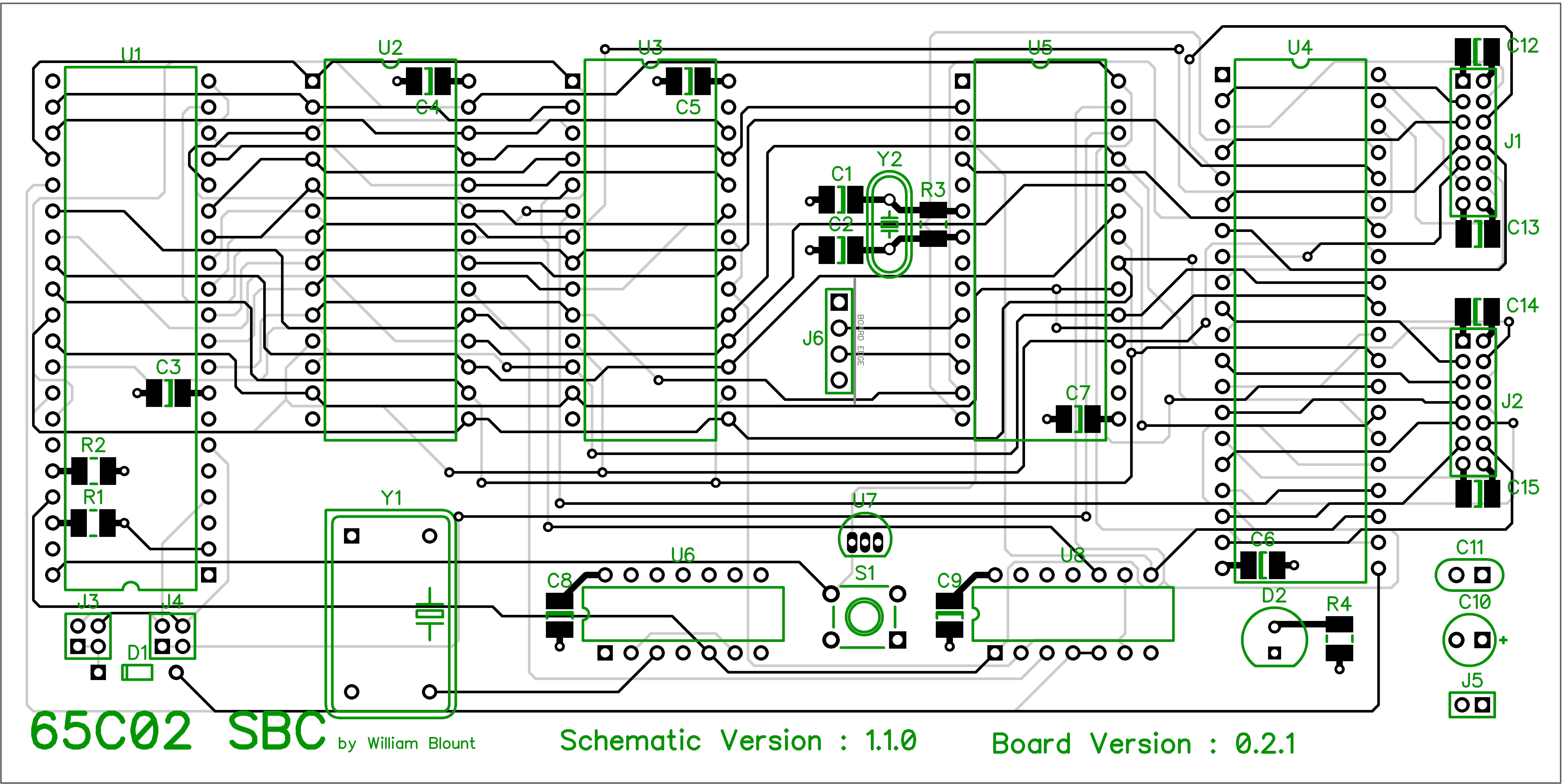

That being said, there is nothing that GrafX-2 can't fix ;)
- Billy
Just an opinion, but you have some traces that are too close to device pins. For example, look at pins 5, 6 and 7 of U6. A sudden slip of the soldering iron could gouge the solder mask on one of those traces and possibly cause a bridge. Passing a DRC is not a guarantee that you won't run into trouble.

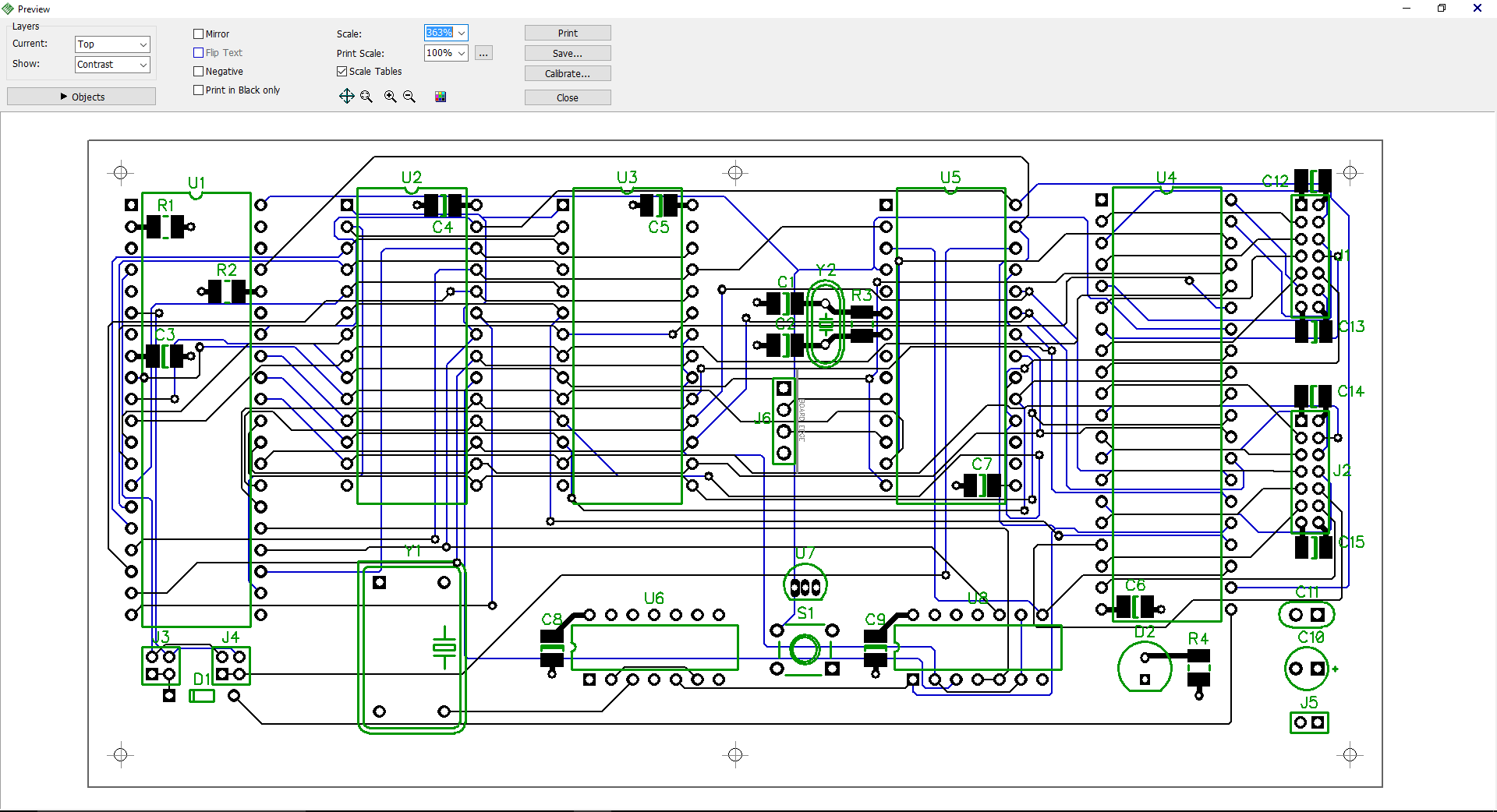

I have changed *my* DRC to a minimum of 0.015" between traces and a trace width of 0.01" (up from 0.008" for each). I have also tried to do a bit more of the routing by hand (although I must admit, I did eventually give up and let the auto router finish the job).
Here is the current version:
- Billy

As BDD pointed out, the previous version had quite a few traces that were dangerously close to where I was going to be soldering. As such I have tried to make sure that the traces are at least a *little* further away from the pads.
- Billy

This revision looks much better to me - no places where two tracks on the same layer squeeze between two pins. There are still a few places where the wires are approximately that close, but it's away from the soldering points. Personally, if the tools allow, I'd do a little manual tidying to space close wires a little more - moving towards a 0.05 inch grid, to the degree that's reasonably possible, without being purist about it.

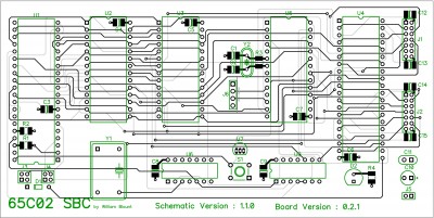

I have made a few changes to the top layer that should put all of the traces a safe distance from each other (see attached):

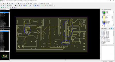

I had a few concerns about these regions on the bottom of my board, but I figure that 15 mil spacing is probably fine (and I am pretty good at soldering so I don't think I'll be breaking through the soldermask):
