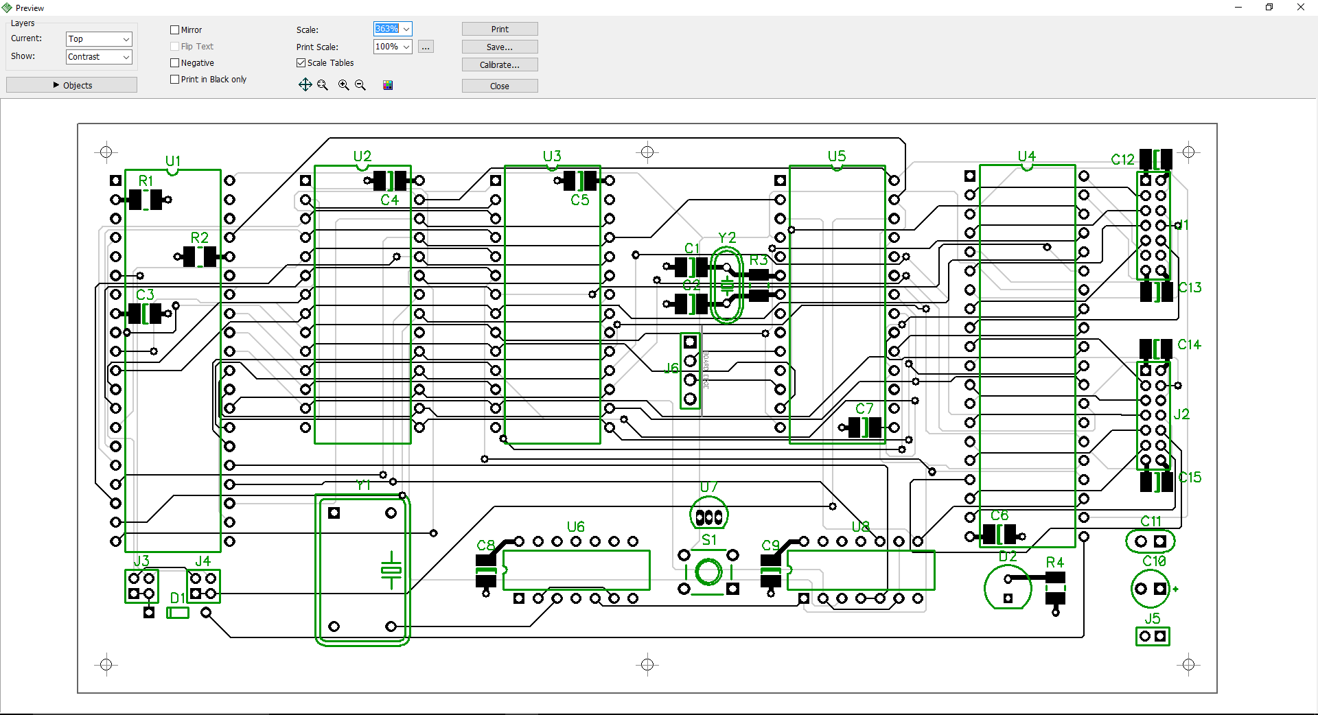

Finished my board layout and have submitted it for review by my parents and EE instructor (as well as an online DRC from the PCB manufacturer I am planning to use).
I do hope that those caps and resistors aren't too small to solder by hand ;)
Here are a few pics (well PDFs really):

PostPosted: Mon Apr 25, 2016 4:00 am
Posts: 8544
Have you run the DRC yet? Whether you use it or not (I don't), do a good visual on every layer. At first glance: Traces look too close to U5 pads 15-24 on the bottom layer. Even if you use an autorouter (which I don't recommend), do a good manual clean-up when it's done.
It will make it a lot easier for someone else to check it if you have one diagram with all the layers, each one shown in a different color.

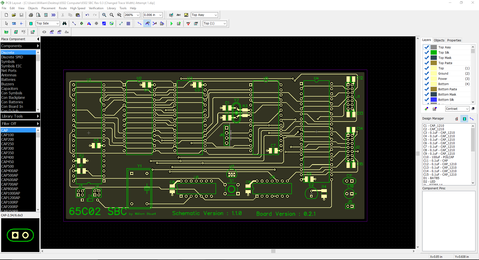

PostPosted: Mon Apr 25, 2016 4:14 am
Joined: Thu Mar 31, 2016 1:26 pm
Posts: 60
Location: Austin, Texas
I have run a DRC (both in Diptrace and with the potential board manufacturer) and everything is >= 8 mils apart.
Here is the best I can do within Diptrace:
- Billy

PostPosted: Mon Apr 25, 2016 5:22 pm
Posts: 8507
billylegota wrote:
That being said, there is nothing that GrafX-2 can't fix ;)
Just an opinion, but you have some traces that are too close to device pins. For example, look at pins 5, 6 and 7 of U6. A sudden slip of the soldering iron could gouge the solder mask on one of those traces and possibly cause a bridge. Passing a DRC is not a guarantee that you won't run into trouble.

I have changed *my* DRC to a minimum of 0.015" between traces and a trace width of 0.01" (up from 0.008" for each). I have also tried to do a bit more of the routing by hand (although I must admit, I did eventually give up and let the auto router finish the job).
Here is the current version:
- Billy
PostPosted: Tue Apr 26, 2016 1:09 am
Posts: 60
As BDD pointed out, the previous version had quite a few traces that were dangerously close to where I was going to be soldering. As such I have tried to make sure that the traces are at least a *little* further away from the pads.

PostPosted: Tue Apr 26, 2016 5:49 am
Posts: 8507
Fortunately soldermask these days seems to be awfully tough, at least if it's over bare copper rather than tinned copper. I've never had a problem with it.

PostPosted: Tue Apr 26, 2016 7:59 am
This revision looks much better to me - no places where two tracks on the same layer squeeze between two pins. There are still a few places where the wires are approximately that close, but it's away from the soldering points. Personally, if the tools allow, I'd do a little manual tidying to space close wires a little more - moving towards a 0.05 inch grid, to the degree that's reasonably possible, without being purist about it.

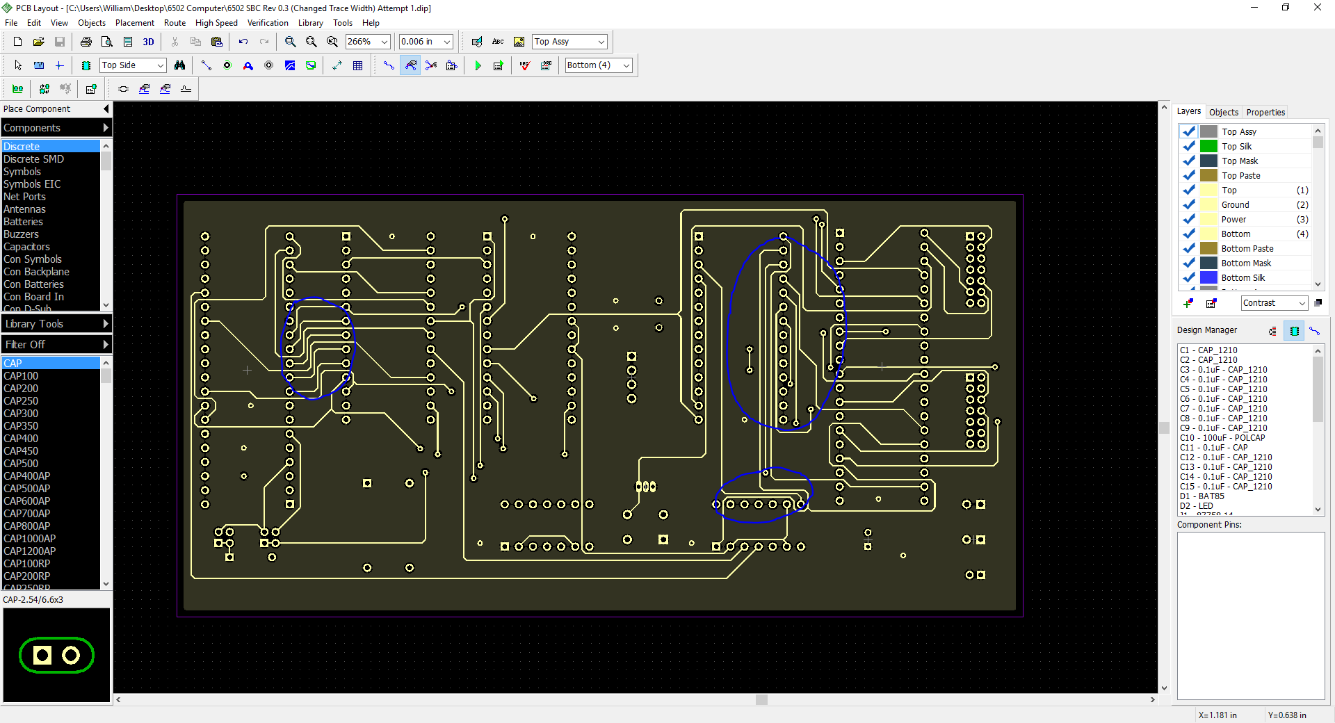

I have made a few changes to the top layer that should put all of the traces a safe distance from each other (see attached):
I had a few concerns about these regions on the bottom of my board, but I figure that 15 mil spacing is probably fine (and I am pretty good at soldering so I don't think I'll be breaking through the soldermask):
- Billy
