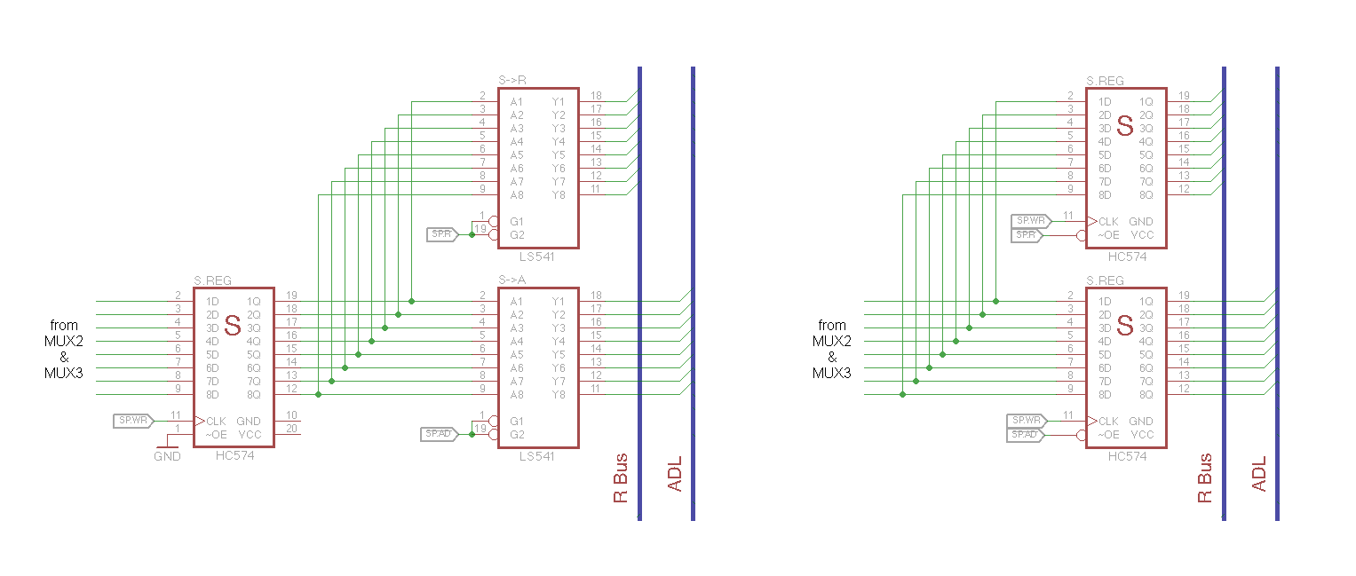

The left side of the diagram below shows the S register and two tri-state buffers that allow its contents to be driven onto the R bus and the ADL bus. On the right we see the job done with 2 chips rather than 3. This same pattern appears in two or more places in your design.
Love this. I simply would never have thought of it - every instinct as a programmer would argue against having two copies of the same data, but here there is no risk of sync issues here, it saves a chip and lowers propagation time as well. Nice.
