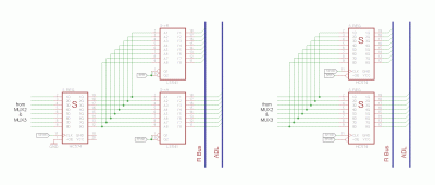

The left side of the diagram below shows the S register and two tri-state buffers that allow its contents to be driven onto the R bus and the ADL bus. On the right we see the job done with 2 chips rather than 3. This same pattern appears in two or more places in your design.

Two little footnotes. Earlier in the thread you mentioned initializing S to $FF upon reset. That's probably harmless but it's not authentic -- a real 6502 doesn't do that . Also:
A few other instructions take fewer cycles to complete than in a standard 6502 (e.g. LSR absolute-indexed instruction takes 6 cycles rather than 7 when a page boundary is not crossed - the microcode can easily be adjusted to add dummy cycles
Yes, 7 cycles when there's no page crossing means the standard NMOS 6502 wasted one cycle. It makes sense that your machine is capable of doing the job in 6.
Interestingly, the wasted cycle of a Read-Modify-Write instruction combined with absolute-indexed mode, no page crossing, got "fixed" in the 'C02 CMOS CPU -- but only partially! ROL ROL ASL & LSR got fixed but INC & DEC didn't. And the partial fix is inaccurately documented by both Rockwell and WDC.
Agreed. Once the circuits are complete, I intend to tidy up the microcode and should do this then. BigEd made some good suggestions for legibility which I want to follow-up on as well - like using PCL and IR rather than PCl and I.
Oh my ... I'll need to check all this carefully. My objective is to be authentic relative to the NMOS 6502 I think, so I'll want to add the "wasted" cycles. Again, a job for the microcode tidy-up to come.
