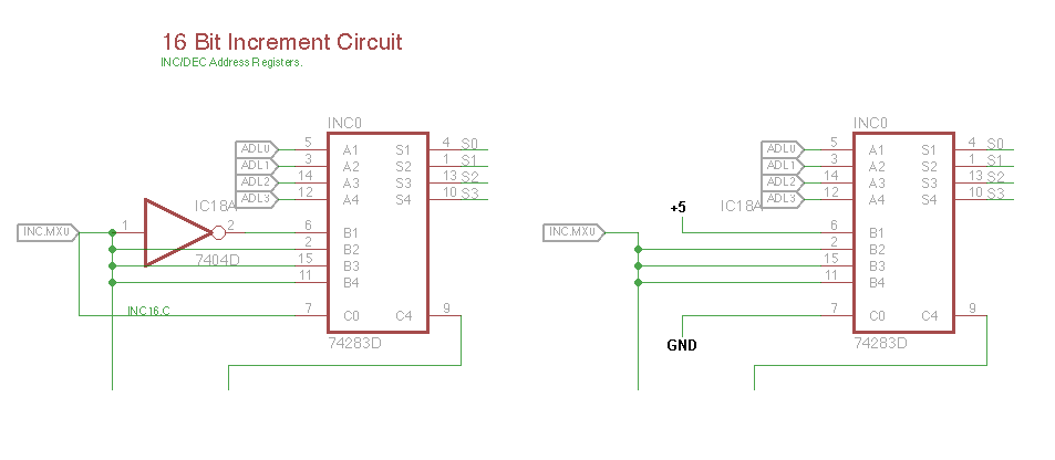

The next mod is minor. It saves a 74xx04 inverter section and may be slightly easier to understand. Below we have the least-significant section of a 16-bit adder, whose job is to take the A operand and increment or decrement it. The B operand is hardwired. The revised version is slightly simpler, and directly establishes the B operand as either 1 or $FFFF -- ie; -1.
Two little footnotes. Earlier in the thread you mentioned initializing S to $FF upon reset. That's probably harmless but it's not authentic -- a real 6502 doesn't do that . Also:
The original INC16 circuit was designed to work in units of 2 also by manipulating the input carry. I managed to re-write the microcode to no longer need this but didn't realize the inverter is also no longer required.
