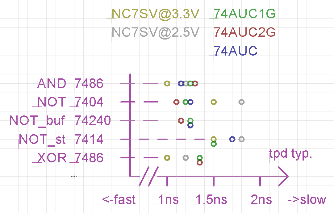

Now for some boring statistics: Fairchild\Onsemi NC7SV versus TI 74AUC.
Propagation delays of different logic chips, load = 30pF parallel 500 Ohms to GND, 25°C.
Format is "min. / typ. / max." in ns.

Sorted for speed, based on typ. propagation delay:
NC7SV08@3.3V:1.0 > 74AUC08:1.15? > NC7SV08@2.5V:1.2 > 74AUC1G08:1.25? > 74AUC2G08:1.3?
NC7SV14@3.3V:1.5 = 74AUC1G14:1.5? > 74AUC14:1.7? > NC7SV14@2.5V:1.8 //74AUC2G14 not available.
NC7SV86@3.3V:1.0 > NC7SV86@2.5V:1.2 > 74AUC1G86:1.35? = 74AUC2G86:1.35? //74AUC86 not available.
And the winner for Schmitt trigger inverters, AND and XOR is +3.3V powered NC7SV.

The winner for inverters is +2.5V powered 74AUC2G04.

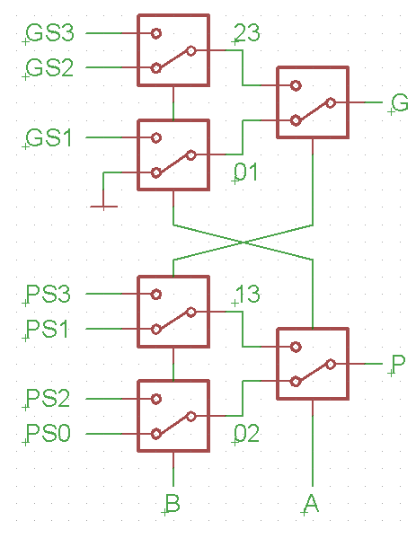

Since 74AUC2G53 is part of the game, now a slightly different concept for building LUs (logic units) with 2:1 multiplexers.
There are two LUs per Bit in a (multiplexer based) ALU, one generating the P (propagate carry) and the G (generate carry) signal.
Basically, a LU is a 4:1 multiplexer "turned by 90 deg.": data inputs fed by a lookup table, select inputs working as data inputs 'A' and 'B' of the ALU.
One could build a 4:1 multiplexer from three 2:1 multiplexers.
Usually, one then would have 4 TTL input loads on 'A' and 2 TTL input loads on 'B' or such.
In the picture below, the 2:1 multiplexers are wired a bit different than usual to have 3 TTL input loads on 'A' and 3 TTL input loads on 'B'.
//Not sure if it finds use in the 100MHz CPU, it's just another Gedankenexperiment.

Re: 100MHz TTL 6502: Here we go!
Very nice Dieter, this FET LU looks very economical and fast. It’s good to have one in AUC logic.
One consideration is that using ranks of gates for logic functions doesn’t require an LUOP as an input. That means control signals can be generated in the same pipeline stage as the ALU itself (as opposed to having to register them in the prior cycle). That said, the LUs switch-times may be fast enough to process an LUOP that arrives late in the cycle. That is almost certainly the case if we use horizontal microcode, but microinstruction bits are also at a premium in this design!
There will likely need to be a little decoding involved, and therefore some delay.
For an all gate design, 74AUC08s and 74AUC32s are about the same size as 74AUC2G53s. However, there does not appear to be any 74AUC86s available, so an XOR function would require “1G” ICs if done in gates. Looks like the FET LUs may have the edge in terms of chip count.
