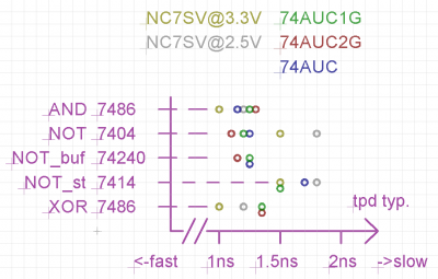

Now for some boring statistics: Fairchild\Onsemi NC7SV versus TI 74AUC.
Propagation delays of different logic chips, load = 30pF parallel 500 Ohms to GND, 25°C.
Format is "min. / typ. / max." in ns.
When typ. was not specified, I assumed typ. = (min. + max.) /2 and added a question mark.
//1 gate per chip
NC7SV08: 2.3V..2.7V: 0.8 / 1.2 / 2.6, 2.7V..3.6V: 0.7 / 1.0 / 2.3
NC7SV14: 2.3V..2.7V: 0.8 / 1.8 / 3.7, 2.7V..3.6V: 0.7 / 1.5 / 3.3
NC7SV86: 2.3V..2.7V: 0.8 / 1.2 / 3.6, 2.7V..3.6V: 0.7 / 1.0 / 3.3

Sorted for speed, based on typ. propagation delay:
NC7SV08@3.3V:1.0 > 74AUC08:1.15? > NC7SV08@2.5V:1.2 > 74AUC1G08:1.25? > 74AUC2G08:1.3?
NC7SV14@3.3V:1.5 = 74AUC1G14:1.5? > 74AUC14:1.7? > NC7SV14@2.5V:1.8 //74AUC2G14 not available.
NC7SV86@3.3V:1.0 > NC7SV86@2.5V:1.2 > 74AUC1G86:1.35? = 74AUC2G86:1.35? //74AUC86 not available.
And the winner for Schmitt trigger inverters, AND and XOR is +3.3V powered NC7SV.

The winner for inverters is +2.5V powered 74AUC2G04.
Nice work! I particularly like the graph.
One thing that really jumps out is the laggardly performance of the inverters with Schmitt trigger ( NOT_st ). It would be helpful if you could expand the graph to include inverters without Schmitt trigger. I expect these will be substantially faster... and, in an actual CPU, a non-Schmitt inverter ought to suffice. :!:
(It won't suffice for the test PCB, of course. Attentive readers will notice there's a DC feedback path from the inverter's output back to its input... meaning that a non-Schmitt inverter would eventually go linear and self-bias to roughly 50% of Vcc).
PS to Drass: yes, of course you're right: the output of the AND expresses the same logical equation as the output of the XOR you soldered on top. However, I have a fuss-budget streak that makes me nervous about any timing skew between the two nominally identical outputs. Since the dice are non-identical there may indeed be a little bit of skew, and since the outputs are in parallel skew translates to current spikes, and this makes me a bit queasy. But, in the heat of the night when the solder is flowing, anything goes!! :twisted: :lol:
Done, the fastest 7404 type inverter appears to be 74AUC2G04.

Well, a 74AUC2G53 switch seems to have 4.5pF of capacitance.
Considering the capactiance of the input pins fed by the switch, for an 8 Bit ALU
I think that would be more than 30pF of capacitance on the PS3..PS0 and GS3..GS1 signals.
That capacitance will add to the propagation delay of the little decoding.
However, there does not appear to be any 74AUC86s available
74AUC1G86 (1 gate) and 74AUC2G86 (2 gates) are available.
Took a look at the TI homepage... and indeed TI does not manufacture the 74AUC86 (4 gates).
Jump over to the TI support forum and start complaining ! :mrgreen:
But better not tell them that you only want to buy just two chips.... yet.
OnSemi 74VCX86 is available, but propagation delay for 30pF\500Ohm is 0.6 / 1.8? / 3.0, that's slow.
74AUC1G86 propagation delay for 30pF\500Ohm is 0.7 / 1.35? / 2.
If we don't count ECL, DigiKey doesn't list a chip with 4 XOR gates faster than the 74VCX86.
But it's interesting that 74VCX datasheets seem to specify the output skew...
PotatoSemi PO74G86A has 1.5ns max. at 15pF load, that's not impressive:
74AUC1G86 has 1.3ns max. at 15pF load.
