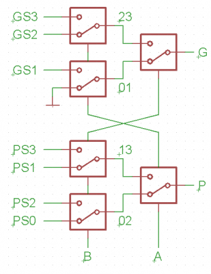

For SBC (Q = A - B), we would have to invert one of the ALU adder inputs.
Drass's idea was putting XOR gates between RAM data output and ALU B latch input.
A nice idea would have been hiding that part in the pipeline by wiring two registers with three_state outputs in parallel:
one with non_inverting outputs, one with inverting outputs... replacing the ALU B latch.
The fastest register with inverting three_state outputs I was able to find is the 74AC534,
propagation delay is 2.5ns .. 16ns at 3.3V, that's way too slow.
//74ABT534 propagation delay is 3.4ns .. 6.7ns, but it's 5V only, and it's still way too slow.
Noticed that there is a buffer containing 8 XOR gates (the chip has a control pin for inverting or non_inverting a Byte):
In theory the 74AHC8541 could simplify the PCB layout,
propagation delay is 15ns typ. at 3.3V, that's way too slow.
Was unable to find a chip with that functionality in logic families other than 74AHC.

I had a chance to run the 16-bit FET incrementer test. I first tried a 16-bit FET carry chain in series just to see what kind of delay we might see. (For reference the test board is configured as follows: R2, R4, R5, R9, R11, R12, R14 and R8 are open and R1, R3, R6, R7, R10, R13 and R15 are closed .. schematic here). Here are the results:
@ 2.5V, 2.2MHz ==> 14.2ns
@ 2.7V, 2.4MHz ==> 12.9ns
@ 2.8V, 2.5MHz ==> 12.5ns
@ 3.3V, 2.9MHz ==> 10.7ns
As expected, a serial 16-bit FET carry chain is much too slow. The incrementer result in the CPU will be fed directly to the synch RAM (when incrementing PC for example), so the setup time of 1.5ns applies here as well. Add to that the tpd for the source register, some transit time, clock skew, etc. and we're pretty much left with about 6.5ns for the incrementer (just like with the adder).
So, the next step was to try carry lookahead. Four levels of AND gates on this board simulate carry lookahead for the first 12 bits of the incrementer. In the test circuit, the lookahead carry is then fed to four FET switches to simulate incrementing the final four bits. In this case, we don't have to include the switch time in the circuit since that happens concurrently with the carry lookahead.
So, I configured the board accordingly (as above, except that R13 is moved to R12 and R15 is moved to R14) and ran the test. Here are the results:
@ 2.5V, 4.9MHz ==> 6.4ns
@ 2.7V, 5.2MHz ==> 6.0ns
@ 2.8V, 5.4MHz ==> 5.8ns
@ 3.3V, 5.9MHz ==> 5.3ns
All good results! -- so we now know we can make a 16-bit incrementer that will be fast enough. Happy day. :)

Since 74AUC2G53 is part of the game, now a slightly different concept for building LUs (logic units) with 2:1 multiplexers.
There are two LUs per Bit in a (multiplexer based) ALU, one generating the P (propagate carry) and the G (generate carry) signal.
Basically, a LU is a 4:1 multiplexer "turned by 90 deg.": data inputs fed by a lookup table, select inputs working as data inputs 'A' and 'B' of the ALU.
One could build a 4:1 multiplexer from three 2:1 multiplexers.
Usually, one then would have 4 TTL input loads on 'A' and 2 TTL input loads on 'B' or such.
In the picture below, the 2:1 multiplexers are wired a bit different than usual to have 3 TTL input loads on 'A' and 3 TTL input loads on 'B'.
//Not sure if it finds use in the 100MHz CPU, it's just another Gedankenexperiment.

Very nice Dieter, this FET LU looks very economical and fast. It’s good to have one in AUC logic.
One consideration is that using ranks of gates for logic functions doesn’t require an LUOP as an input. That means control signals can be generated in the same pipeline stage as the ALU itself (as opposed to having to register them in the prior cycle). That said, the LUs switch-times may be fast enough to process an LUOP that arrives late in the cycle. That is almost certainly the case if we use horizontal microcode, but microinstruction bits are also at a premium in this design! :roll: There will likely need to be a little decoding involved, and therefore some delay.
For an all gate design, 74AUC08s and 74AUC32s are about the same size as 74AUC2G53s. However, there does not appear to be any 74AUC86s available, so an XOR function would require “1G” ICs if done in gates. Looks like the FET LUs may have the edge in terms of chip count. :)

Well, a 74AUC2G53 switch seems to have 4.5pF of capacitance.
Considering the capactiance of the input pins fed by the switch, for an 8 Bit ALU
I think that would be more than 30pF of capacitance on the PS3..PS0 and GS3..GS1 signals.
That capacitance will add to the propagation delay of the little decoding.
