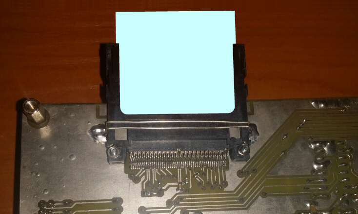

Well, if you've verified that all the connections are correct for the CF card (not an inverted socket, etc.), then I suppose it's possible that you have two defective cards. Do you have the option to try the CF cards with a modern PC via something like a USB adapter? Or even an older CF to IDE adapter (I have a couple of these which are useful from time to time).
Not two cards. Like I said before, later I tested my computer with several more. Including 4GB Seagate microdrive (HDD in CF format).
And what do you mean by "inverted socket"? I used Eagle PCB library for specific part. Sockets I used are not this part (I ran out of my supply of those) but I've checked and pins are exactly the same.
Can you show me propper pinout for CF card? Materials I found using Google are inconsistent. For example this site claims that pin 1 (GND) is at the top left corner, but this one claims that it is bottom left corner. Which one is right?
And of course I tested my cards with USB reader. They are fine.

One last bit of interest is the pin lengths of the CF socket. Note that both ground and Vcc pins are longer than the others. This means that Pins 13 and 38 are Vcc and always in the center of the connector, regardless of whether your have a normal or inverse socket. The ground pins (1 and 50) are also longer pins, and can be used to determine if your socket is inverse or normal, as they swap top to bottom. Pins 25 and 26 are CD1/2 and simply grounded within the CF card, which can be used as an indicator that the card is fully inserted... these swap with the ground pins for an inverse socket.
Finally, Pin 1 is generally marked on CF media with a triangular pattern (just like on IDE sockets, etc.) and the CF socket generally has the same Pin 1 marking. It seems to be in the first picture of the socket, which is mounted on the bottom on the PCB, albeit it is quite faint. It would be useful to take a picture of the CF card inserted into the socket.

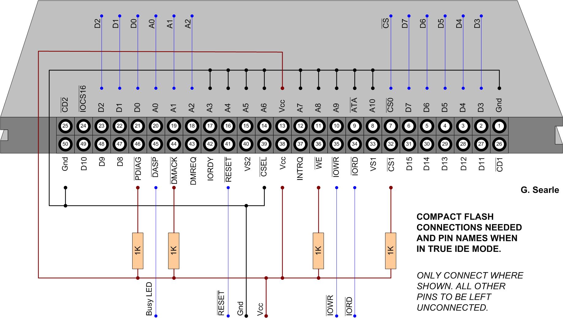

Here's an image I found on Grant Searle's site ( searle.wales ). It very helpfully shows a CF card as it appears in real life. There's no ambiguity about orientation, and the fat and thin slots are clearly visible.
Atlantis, if you imagine this card plugging into the CF socket on your project (after mentally spinning the card around as required to match the fat and thin ridges on your socket) then you should be able to tell whether or not the signals end up where they're expected to be wrt the traces on your PCB. If you're still unsure then please do as suggested and post a picture of your CF card inserted into the socket.

Ok, CF card already works. The weirdest part is that I still don't know what was wrong, but it wasn't card orientation, however I was unaware of the existence of two types of connectors.
I simply used another socket - identical with the first one - and the thing "magically" started working. I don't know, maybe some microscopic spec, bridging pads, which somehow survived first desoldering and cleaning?

It's great to hear the machine is working! But it's hard to imagine any microscopic bridging of pads which would always cause trouble when a card is present but would never cause trouble when the card is absent.
Other explanations could be suggested, I admit. Over the years I've occasionally seen astonishing things -- flukes I never would have predicted or given credence to. :shock: But flukes are rare, and what's perhaps more likely is that this inverse socket business isn't fully understood. The thing has been slippery to describe right from the start. (And thanks, floobydust, for bringing attention to the matter.)
With the theory that one socket is inverse and the other isn't, here are some "before" and "after" images I whipped up. The new socket looks pretty much the same as the old one, and it mounts in the same orientation. But the CF card itself needs to be flipped over (I've used different colors for the top & bottom of the card) or else the socket won't allow it to be inserted. That's because the positions of the thin and thick ridges (mentioned upthread) are swapped. The ridges are the only thing NOT identical between the two sockets. :!:
