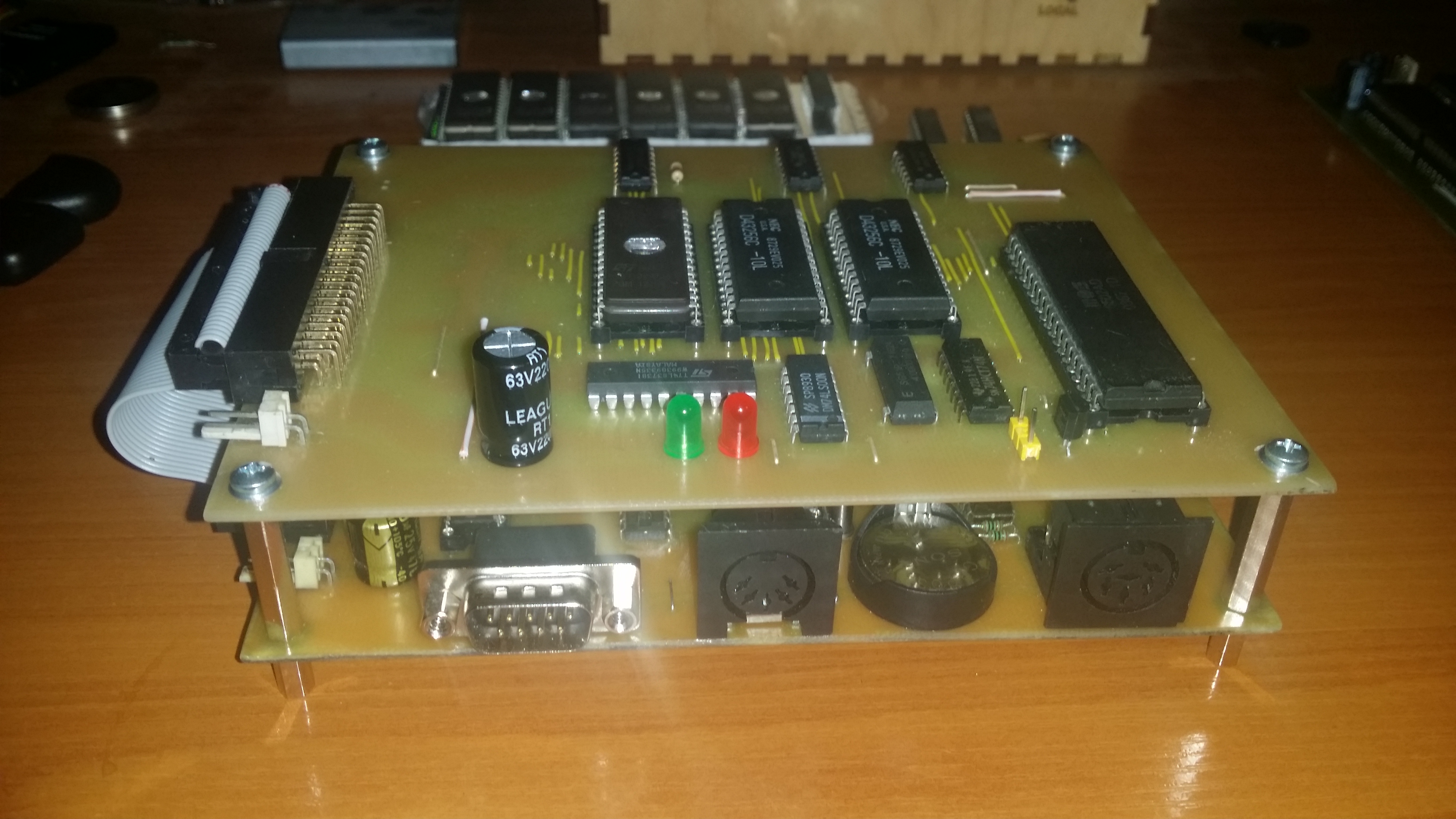

Currently I am building simple, modular 6502 computer. At this point it runs EhBasic using serial terminal.

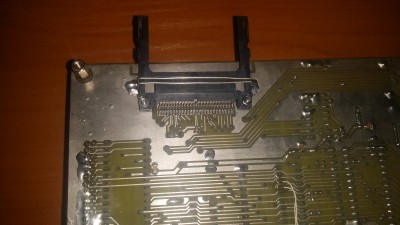

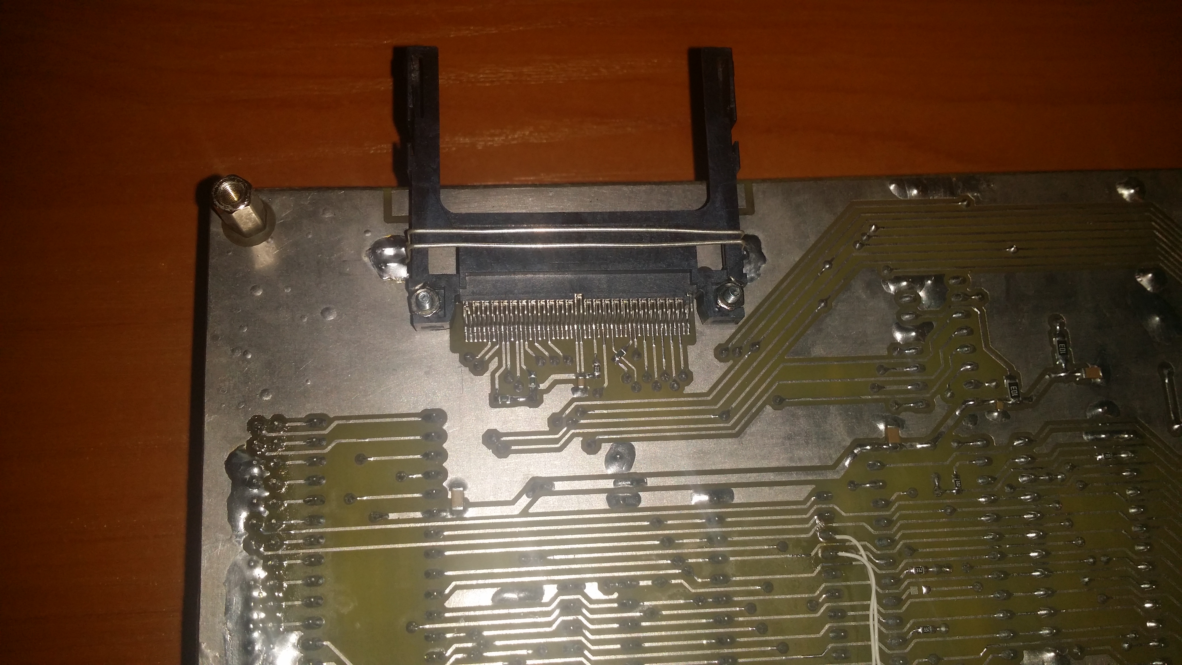

At this point my main goal is to configure and run peripherals on my I/O board - beside UART there is a GPIO, timer, 8242 keyboard controller and CF card slot. Yesterday I decided to try with a Compact Flash card.
Card socket is connected directly do the system bus (I have an additional logic generating !RD and !WR signals for Intel bus devices), according to schematic from this page. Everything works fine when the card slot is empty. But when I try to power the computer with the card inserted, it doesn't work. There is either nothing or some random characters on my terminal, instead of standard EhBasic cold/warm boot message.
At first I thought that it might have been because uninitialized card, so I put proper code (initializing card in 8bit mode) at the beginning of EhBasic init section. I didn't change anything.
I checked it with two SanDisk cards. First one is plain 1GB model. The second one is an industrail grade 32MB model. Neither of them works.
Any idea what may be the cause of this weird behavior?

Hi, Atlantis. Congrats on getting EhBasic running!
As for the Flash problem, the behavior you describe could be caused by improper chip-select to pin 7 of the Compact Flash card, resulting in it being active at the same time ROM or RAM is active, and thus interfering. What sort of address decoder have you provided to generate the chip-select? And do you have a 'scope or logic probe with which to observe the chip-select signal?
There are other possible causes, of course. What's the clock rate of your computer? Have you provided bypass capacitors? And what's the construction technique -- are you using a solderless breadboard, for example?
A schematic and some photos would be helpful. (And this is a good time to remind everyone that when you post on this forum you're allowed to attach images.
This is a more convenient solution than posting the images on a third-party site, and it's also more permanent.)

Following Jeff's idea... you could easily tie /CS0 high (bypass your select logic) and see if you still have a problem. This would simply have the CF card on the data and address bus, along the WR and RD signals. If your computer still doesn't power on, then you likely have a problem with the data and/or address lines.

Can you reset your board? It's possible power-on reset is broken with the CF card in, but a re-reset will work. On similar lines to above, check your power rail voltage and your bypass capacitors - the CF card might be very demanding or very noisy on the rails.

I measured voltage at CF CS line when card should be inactive. It is 5V.

Could it be the NMOS CPU and a CMOS CF disagreeing about voltage levels ?
Re: Computer doesn't work with CF cart
1) There are 74HCT245 chips buffering address bus just before system bus connector (memory chips are connected directly do CPU).
2) Address decoding is done with HCT chips.
3) !RD and !WR signals are also generated with HCT logic.
So only data bus is not buffered.
Memory chips are also CMOS, there is no problem.
I am not the first person who uses CF card with retro hardware...

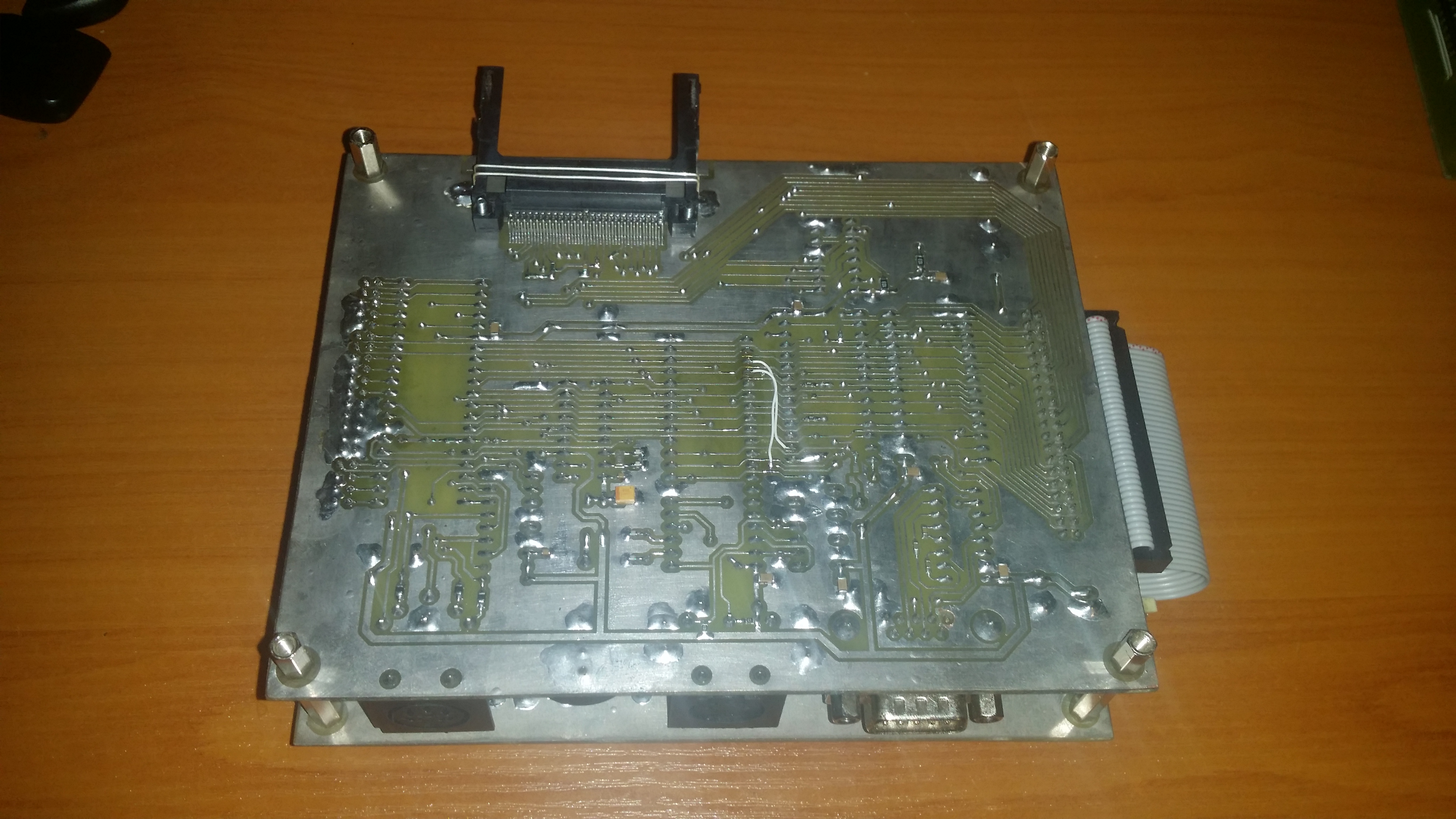

I already tried several different solutions:
1) Trying yet another CF cards, including 1GB Kingston and even 4GB Seagate Microdirve HDD.
2) Adding 10uF monolithic + 22uF tantalum capacitors near card slot.
3) Using fuse rated for larger currents (in case if there was a voltage drop)
I've found article which mentions similar problem:
https://ciernioo.wordpress.com/2015/02/ ... face-card/
Maybe it is in fact caused by the lack of buffer on the data bus? Maybe I should design CF card module with proper buffering?
