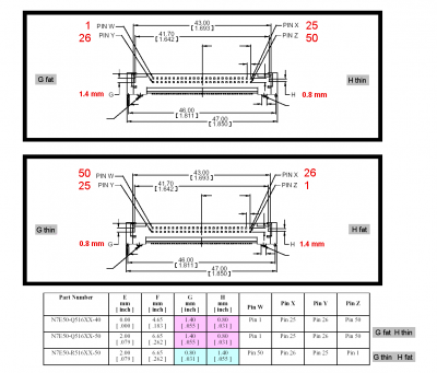

Maybe this datasheet from 3M will help determine which socket is being used.
ts2082-64084.pdf [408.66 KiB]
Downloaded 79 times
The bottom drawing on Page 2 shows the key slots... "G" and "H" (left - right) and the dimensions are listed in the table on the next page, as either 1.4mm or 0.8mm. Note that they are reversed between the "Q" and "R" style sockets.

PostPosted: Sat Nov 09, 2019 6:55 pm
Atlantis wrote:
For example this site claims that pin 1 (GND) is at the top left corner, but this one claims that it is bottom left corner. Which one is right?
Because the whole deal may be rotated 180 degrees, top-left and bottom-right aren't reliable indications. Instead we need to pay attention to which end of the socket has the fat ridge (engaging the fat slot on the card) and which end has the thin ridge and slot.
I've been reviewing the 3M datasheet floobydust provided, and here are the two interpretations intended for the diagram. I've shown the diagram twice, marked using info from the chart.
We can summarize by saying, "The end with the fat ridge has pins 1 and 26. The end with the thin ridge has pins 25 and 50." And bear in mind that each orientation is a 180 degree rotation of the other -- NOT a mirror image.

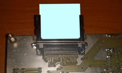

PostPosted: Thu Nov 14, 2019 5:50 am
Atlantis wrote:
I simply used another socket - identical with the first one - and the thing "magically" started working. I don't know, maybe some microscopic spec, bridging pads, which somehow survived first desoldering and cleaning?
It's great to hear the machine is working! But it's hard to imagine any microscopic bridging of pads which would always cause trouble when a card is present but would never cause trouble when the card is absent.
Other explanations could be suggested, I admit. Over the years I've occasionally seen astonishing things -- flukes I never would have predicted or given credence to. :shock: But flukes are rare, and what's perhaps more likely is that this inverse socket business isn't fully understood. The thing has been slippery to describe right from the start. (And thanks, floobydust, for bringing attention to the matter.)
With the theory that one socket is inverse and the other isn't, here are some "before" and "after" images I whipped up. The new socket looks pretty much the same as the old one, and it mounts in the same orientation. But the CF card itself needs to be flipped over (I've used different colors for the top & bottom of the card) or else the socket won't allow it to be inserted. That's because the positions of the thin and thick ridges (mentioned upthread) are swapped. The ridges are the only thing NOT identical between the two sockets. :!:
