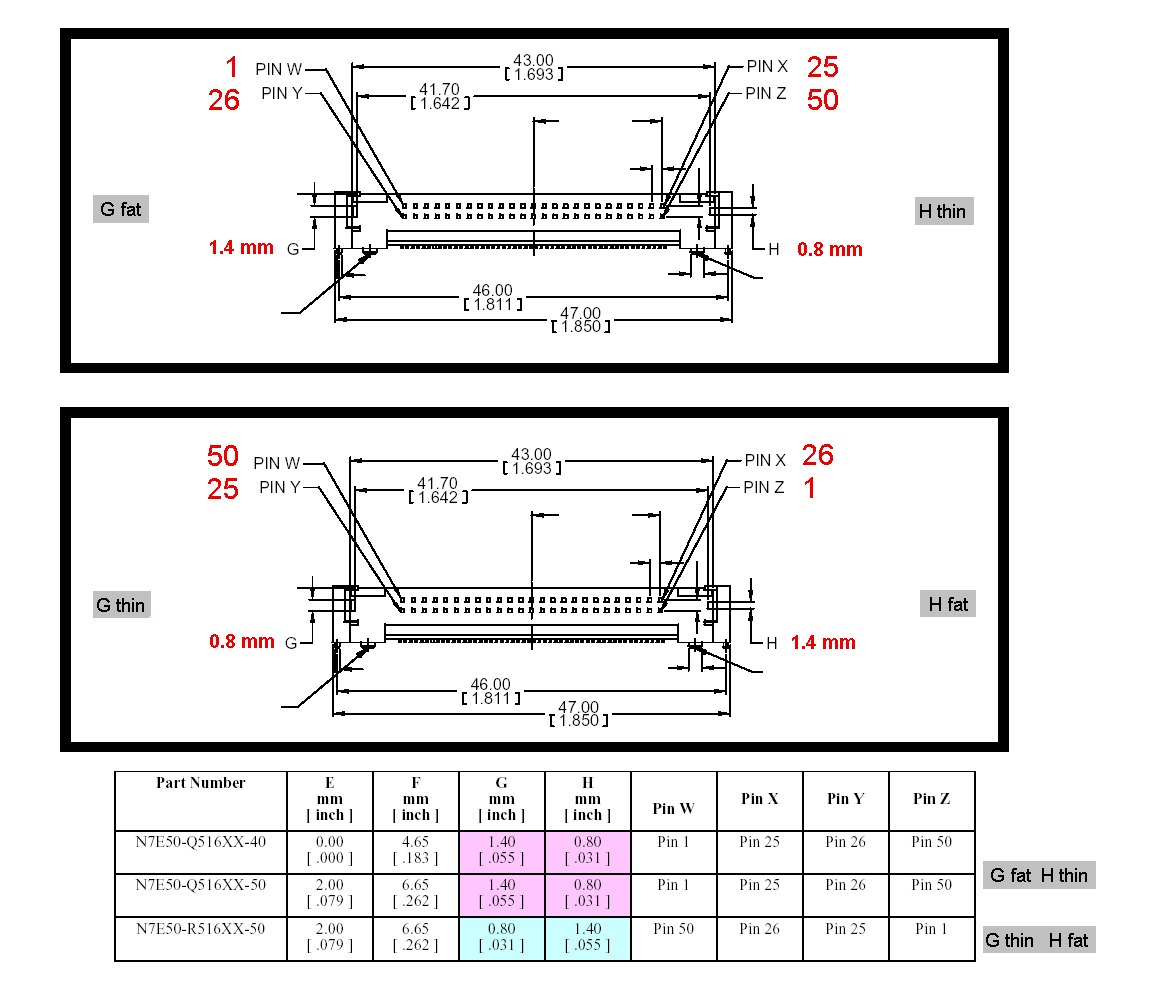

Maybe this datasheet from 3M will help determine which socket is being used.
ts2082-64084.pdf [408.66 KiB]
Downloaded 79 times
The bottom drawing on Page 2 shows the key slots... "G" and "H" (left - right) and the dimensions are listed in the table on the next page, as either 1.4mm or 0.8mm. Note that they are reversed between the "Q" and "R" style sockets.

And what do you mean by "inverted socket"? I used Eagle PCB library for specific part. Sockets I used are not this part (I ran out of my supply of those) but I've checked and pins are exactly the same.
Can you show me propper pinout for CF card? Materials I found using Google are inconsistent. For example this site claims that pin 1 (GND) is at the top left corner, but this one claims that it is bottom left corner. Which one is right?
Because the whole deal may be rotated 180 degrees, top-left and bottom-right aren't reliable indications. Instead we need to pay attention to which end of the socket has the fat ridge (engaging the fat slot on the card) and which end has the thin ridge and slot.
I've been reviewing the 3M datasheet floobydust provided, and here are the two interpretations intended for the diagram. I've shown the diagram twice, marked using info from the chart.
We can summarize by saying, "The end with the fat ridge has pins 1 and 26. The end with the thin ridge has pins 25 and 50." And bear in mind that each orientation is a 180 degree rotation of the other -- NOT a mirror image.

One last bit of interest is the pin lengths of the CF socket. Note that both ground and Vcc pins are longer than the others. This means that Pins 13 and 38 are Vcc and always in the center of the connector, regardless of whether your have a normal or inverse socket. The ground pins (1 and 50) are also longer pins, and can be used to determine if your socket is inverse or normal, as they swap top to bottom. Pins 25 and 26 are CD1/2 and simply grounded within the CF card, which can be used as an indicator that the card is fully inserted... these swap with the ground pins for an inverse socket.
Finally, Pin 1 is generally marked on CF media with a triangular pattern (just like on IDE sockets, etc.) and the CF socket generally has the same Pin 1 marking. It seems to be in the first picture of the socket, which is mounted on the bottom on the PCB, albeit it is quite faint. It would be useful to take a picture of the CF card inserted into the socket.

Ok, CF card already works. The weirdest part is that I still don't know what was wrong, but it wasn't card orientation, however I was unaware of the existence of two types of connectors.
I simply used another socket - identical with the first one - and the thing "magically" started working. I don't know, maybe some microscopic spec, bridging pads, which somehow survived first desoldering and cleaning?
It's great to hear the machine is working! But it's hard to imagine any microscopic bridging of pads which would always cause trouble when a card is present but would never cause trouble when the card is absent.
Other explanations could be suggested, I admit. Over the years I've occasionally seen astonishing things -- flukes I never would have predicted or given credence to. :shock: But flukes are rare, and what's perhaps more likely is that this inverse socket business isn't fully understood. The thing has been slippery to describe right from the start. (And thanks, floobydust, for bringing attention to the matter.)
With the theory that one socket is inverse and the other isn't, here are some "before" and "after" images I whipped up. The new socket looks pretty much the same as the old one, and it mounts in the same orientation. But the CF card itself needs to be flipped over (I've used different colors for the top & bottom of the card) or else the socket won't allow it to be inserted. That's because the positions of the thin and thick ridges (mentioned upthread) are swapped. The ridges are the only thing NOT identical between the two sockets. :!:
