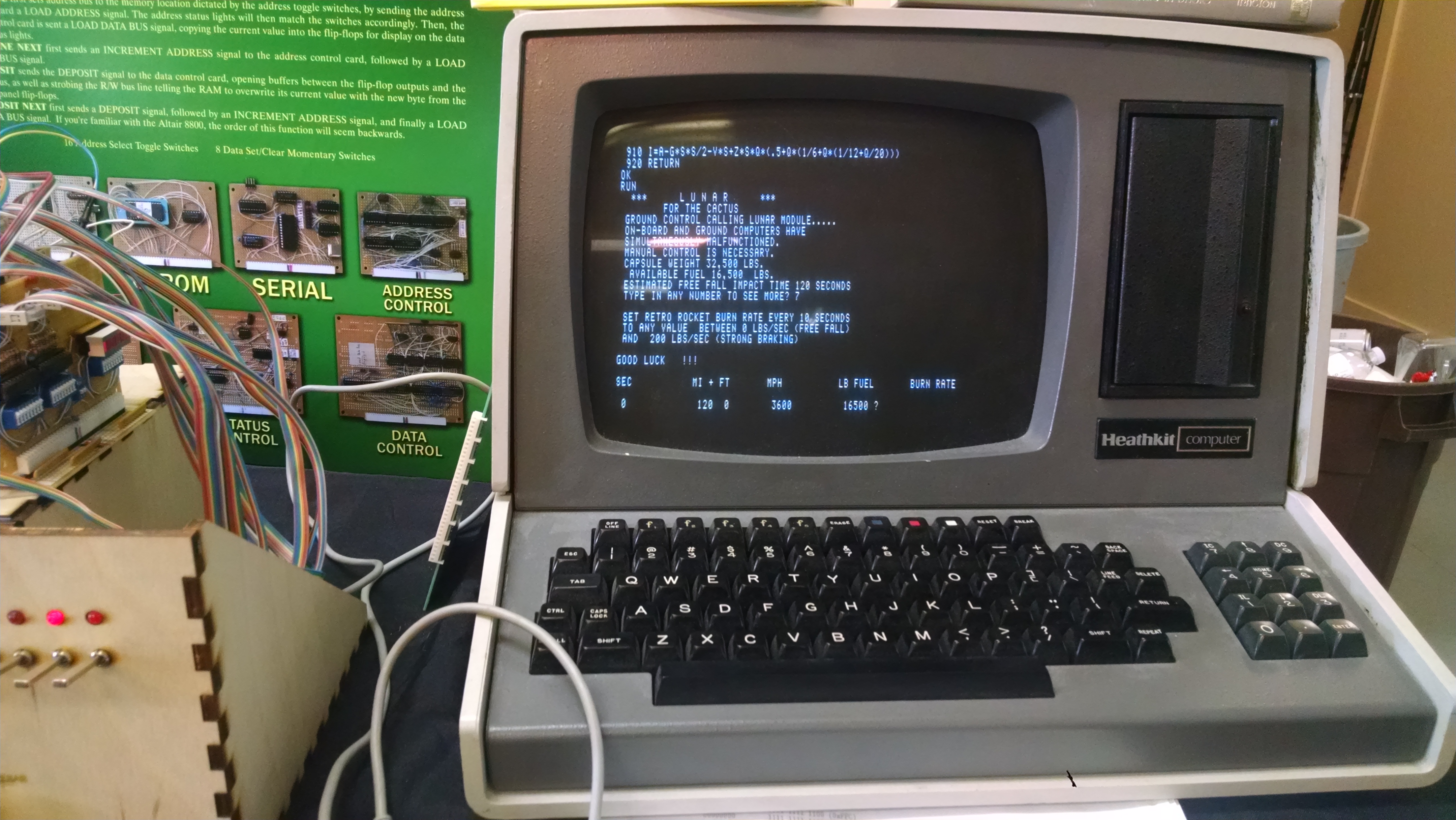

I've got a long to-do list here... but atleast I can say I've played Lunar Lander in BASIC on hardware I built!

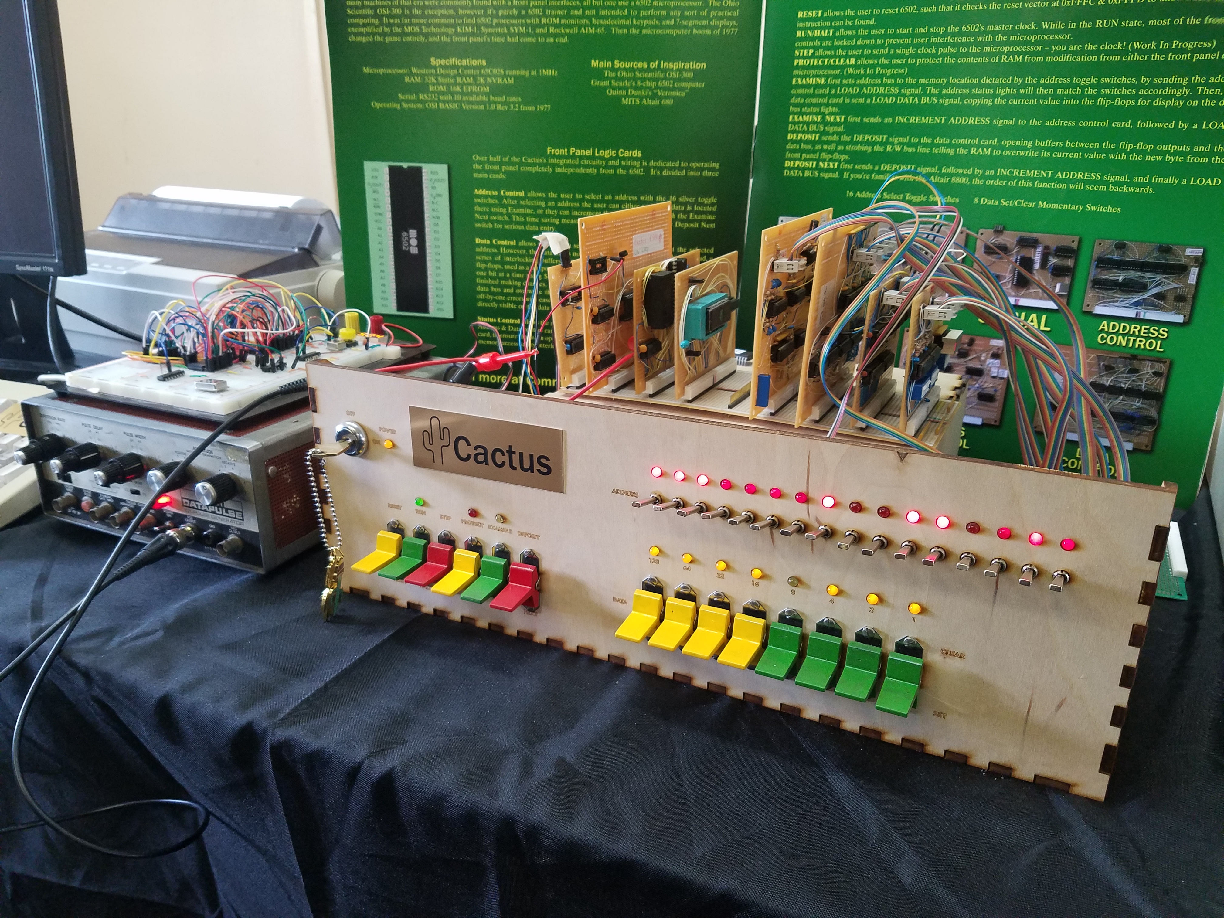

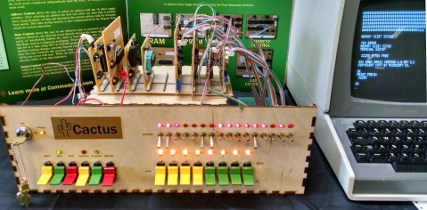

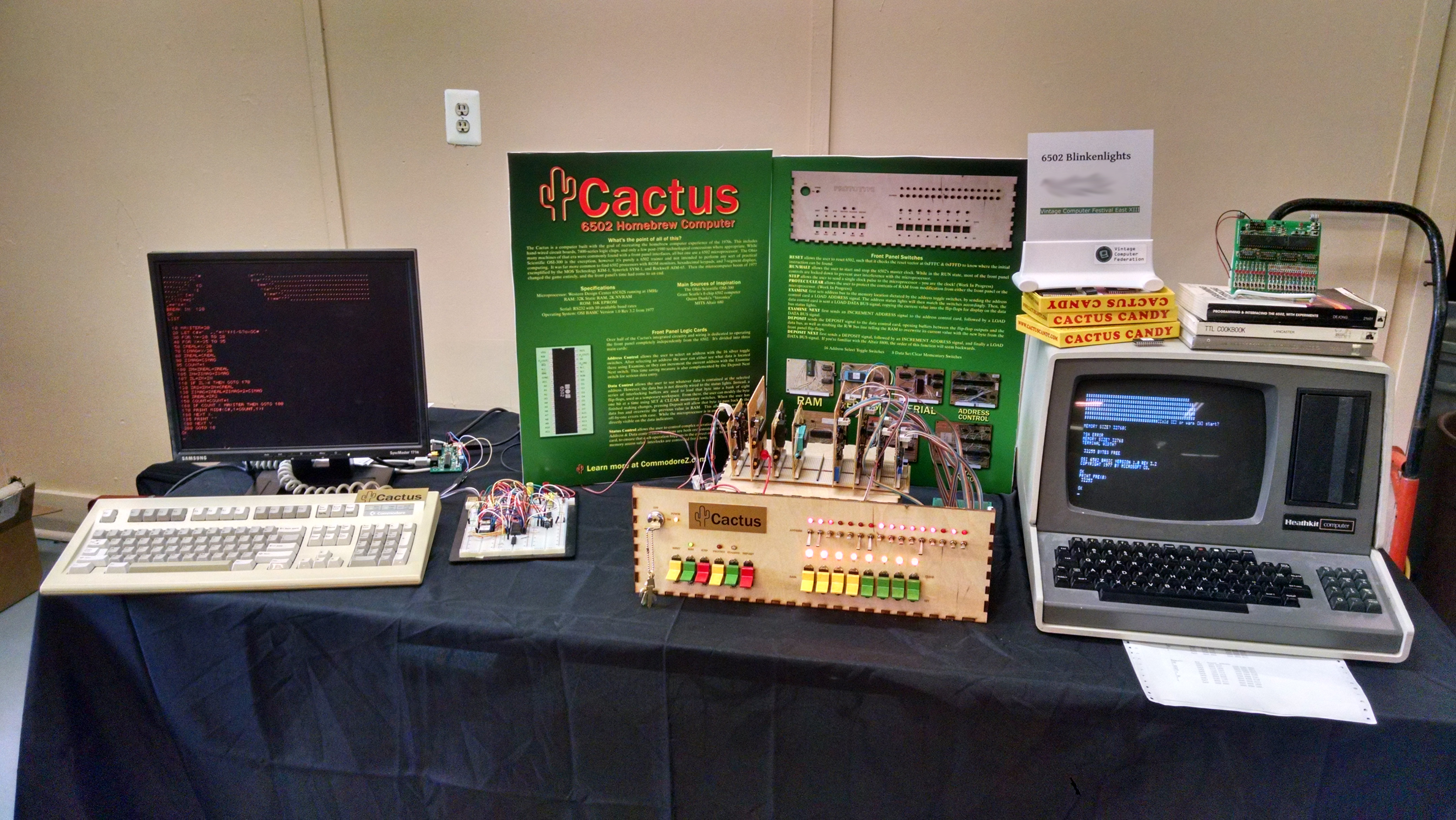

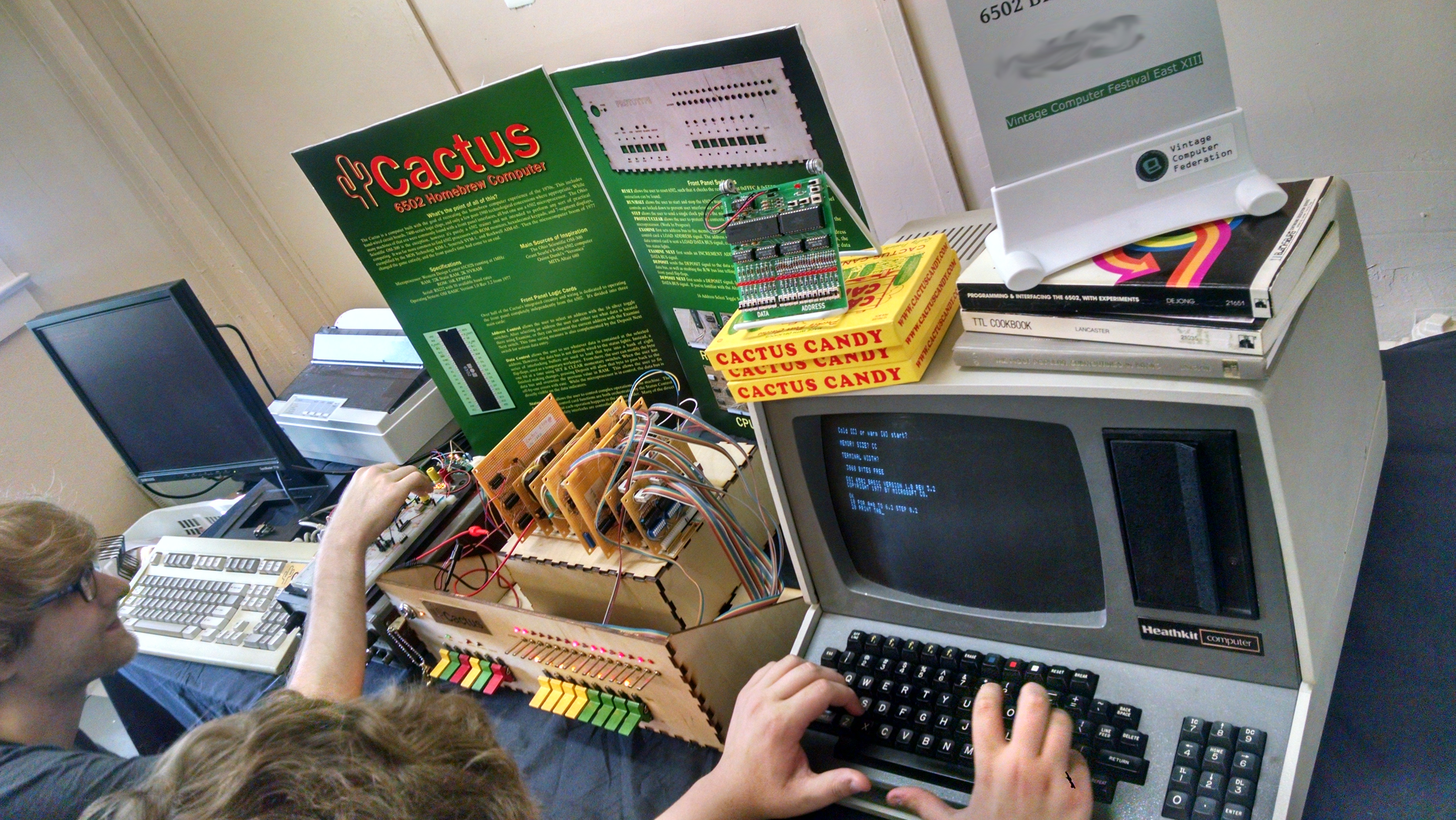

I've been slacking on making updates here, so I might as well.
Exhibit front and center
VCF East XIII was a blast. People really liked the Cactus, despite it not being a vintage computer.
Exhibit with visitors
I ended up just swapping EPROMs as the day went. If I had 32K EPROMs on hand, I would have used the upper/lower bank switching jumper to move between BASIC and direct user data entry. For a time on the second exhibit day, I hooked up an external pulse generator in as a replacement for the 1MHz clock, and slowed down the 65C02 down to the point where you could watch individual opcodes go by. That was fun.
I didn't have any hardware faults from the Cactus itself for the duration of the weekend. My H89 (acting as an H19) stood in as my era-appropriate terminal, and it blew a few fuses from the extended use. I had too small of a fuse value in there anyway, so it's not like anything on the H89 failed.

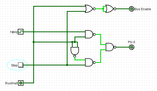

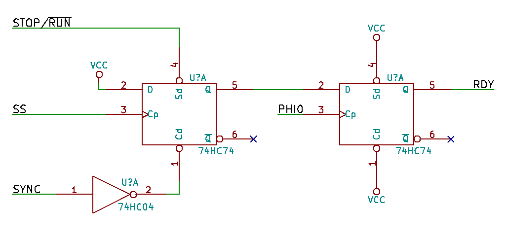

After coming back, I started overhauling the single step circuitry. I was trying to implement what I was provided by Thrashbarg a few months ago, while integrating my bus arbitration logic to keep the CPU and front panel from causing contention. After hitting a few snags in re-arranging stuff to accommodate the new bus signal, I was able to get 1MHz mode running again, but single stepping just wasn't panning out.
Step select logic
Step select logic
step select logic.PNG (7.93 KiB) Viewed 6649 times
So I did something drastic. I threw together my original idea from late last year of how I figured single step might be done, and bypassed the previous approach by putting READY at +5v. This includes my bus enable + CPU asset lockout logic. Admittedly, it's crude, but it does seem to work... sometimes. 1MHz selection is fine, but single step only works on programs that don't involve using 6850. It starts working and then gets lost part way through as if it lost it's place, if that makes any sense. If I was using an NMOS 6502, I would immediately suspect that the registers were degrading and losing their place, but I'm not so that can't be it.

CommodoreZ wrote:
So I did something drastic. I threw together my original idea from late last year of how I figured single step might be done, and bypassed the previous approach by putting READY at +5v. This includes my bus enable + CPU asset lockout logic. Admittedly, it's crude, but it does seem to work... sometimes. 1MHz selection is fine, but single step only works on programs that don't involve using 6850. It starts working and then gets lost part way through as if it lost its place, if that makes any sense. If I was using an NMOS 6502, I would immediately suspect that the registers were degrading and losing their place, but I'm not so that can't be it.
The NMOS 6502 cannot handle a stopped clock. It was only guaranteed down to 100kHz. At some lower frequency, the registers begin to lose their contents, similar to DRAM which needs constant refreshing. Don't forget about the single-cycling we talked about on page 1 of this topic though.

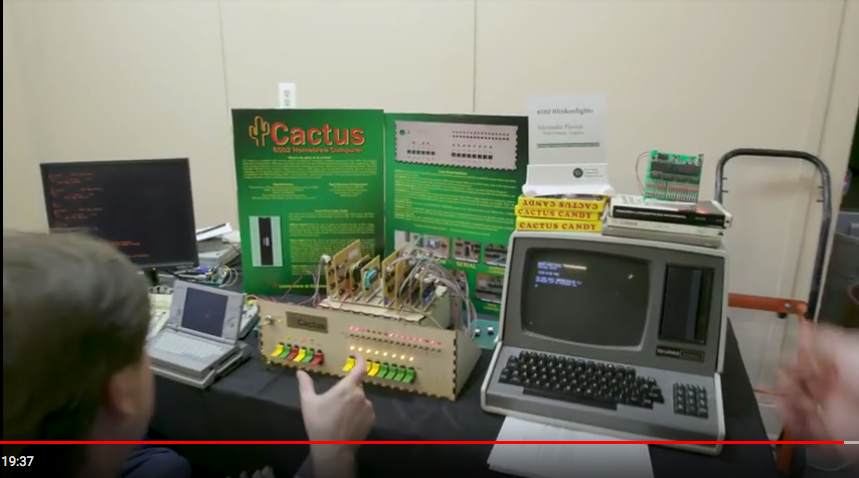

Re: The Cactus, A Starting Point
Cactus spotted in this VCF East video - see 16:30 mark here:
https://youtu.be/dOVYrucHBSg?t=16m29s

The NMOS 6502's clock threshold is precisely why I opted for the CMOS version with the static core.

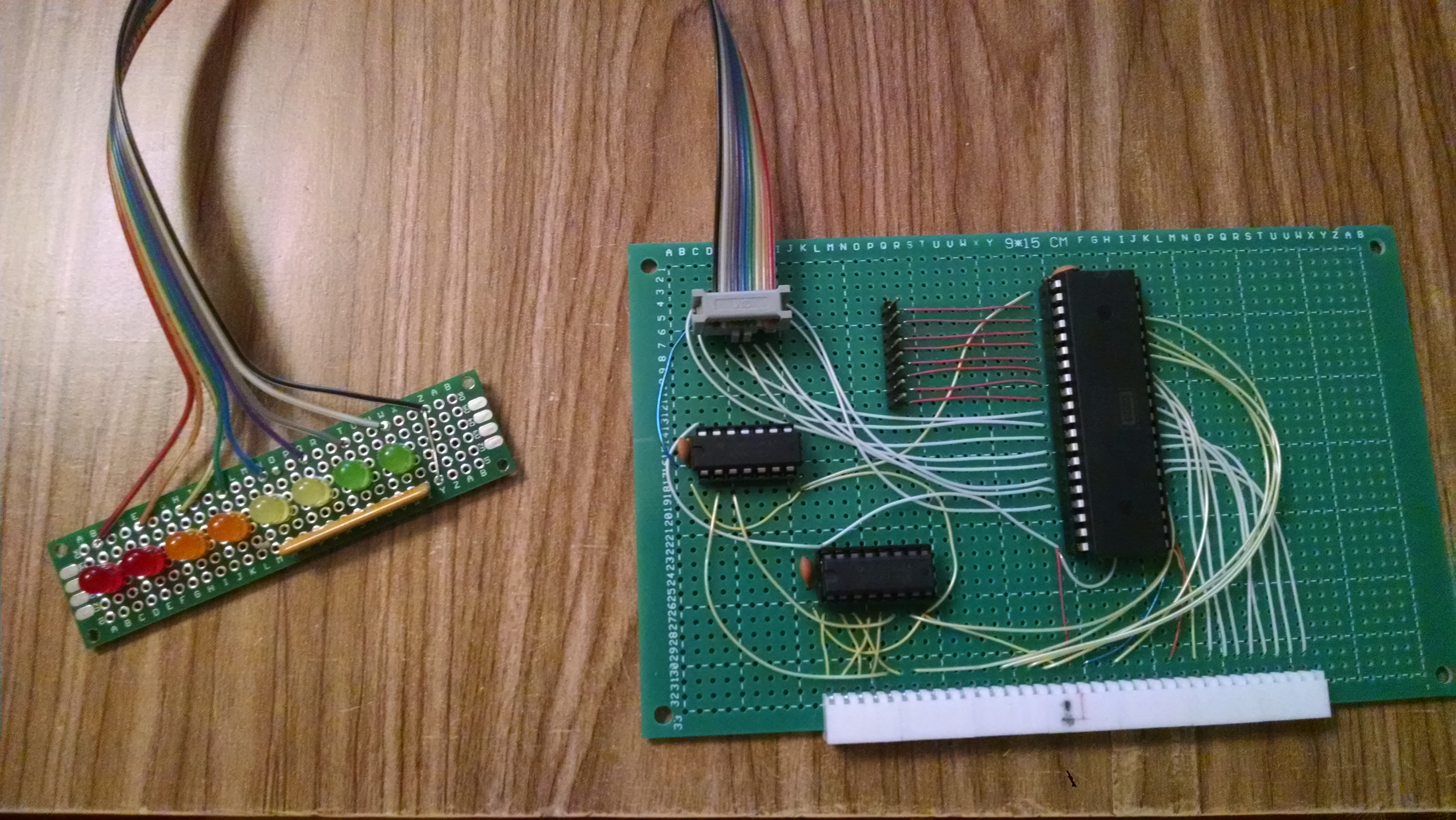

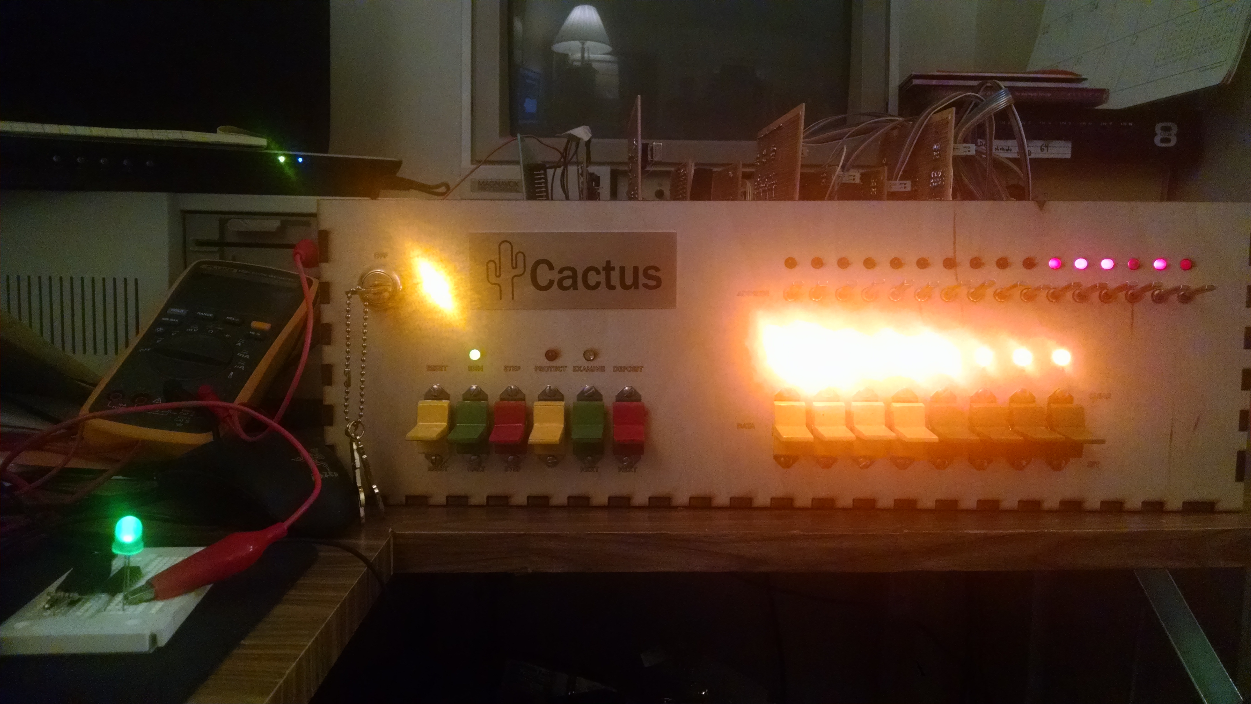

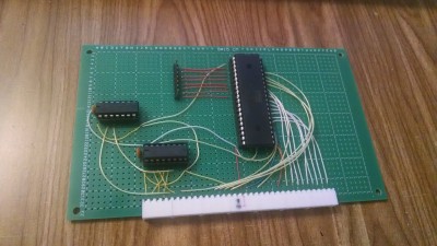

I've made a bit of progress here and there...

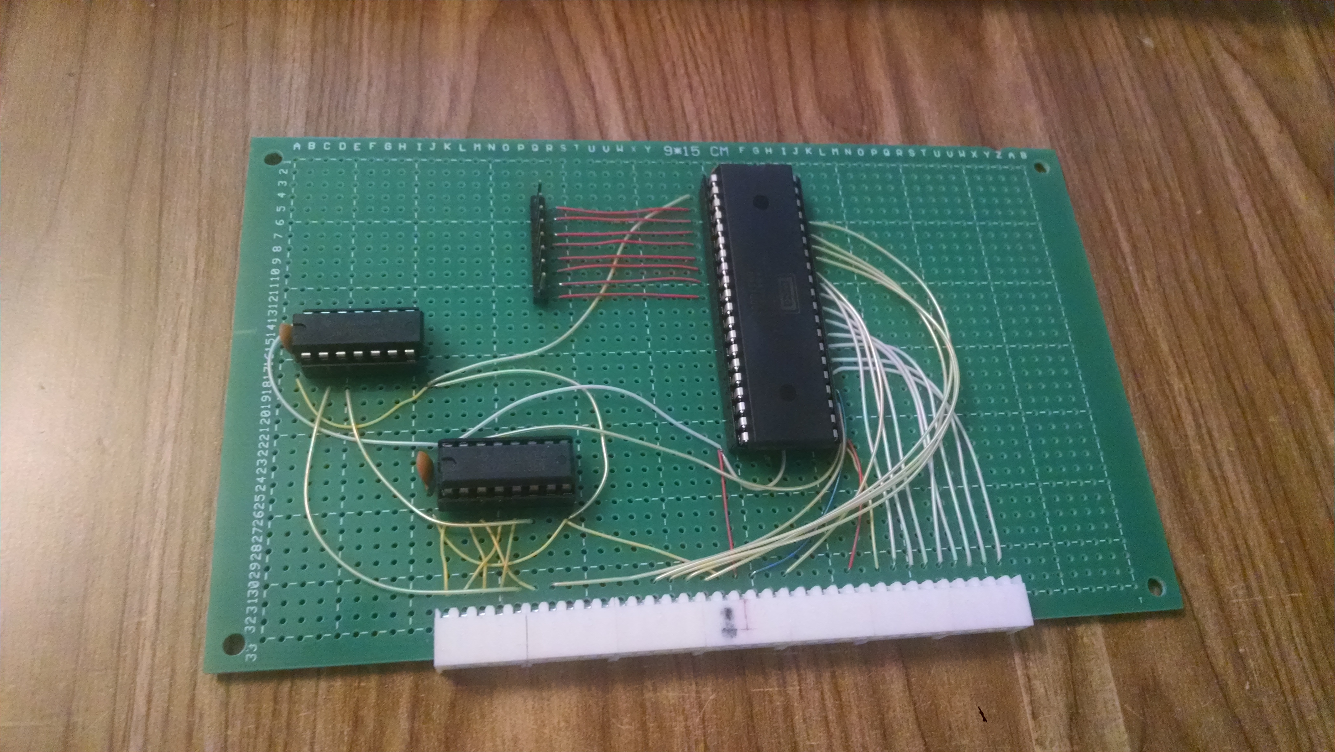

65C22 board
65C22 board
I decided it was time I took a crack at adding a VIA into the mix. Specifically, a 65C22 (although I do have some NMOS ones on hand too). I figured it would be easiest to start simple, and wire up just wire up Port A. I threw an LED on there, and after reading through someone's code on their first steps with a 6522, I was able to devise a simple little test program to get it to blink -- nothing fancy.
0000        LDA #$FF        A9 FF
0002        STA $A603       8D 03 A6
0005        LDA #$00        A9 00
0007        STA $A601       8D 01 A6
000A        LDX #$C8        A2 C8
000C        LDY #$00        A0 00
000E        DEY             88
000F        BNE $0E         D0 FD
0011        DEX             CA
0012        BNE $0C         D0 F8
0014        LDA #$FF        A9 FF
0016        STA $A601       8D 01 A6
0019        LDX #$C8        A2 C8
001B        LDY #$00        A0 00
001D        DEY             88
001E        BNE $1D         D0 FD
0020        DEX             CA
0021        BNE $1B         D0 F8
0023        JMP $0005       4C 05 00
By the way, I find it really fun to toggle in a program like this. Sure, it does take a bit of time, but it makes me happy to see an LED controlled by something I built up from scratch.
blinking
blinking

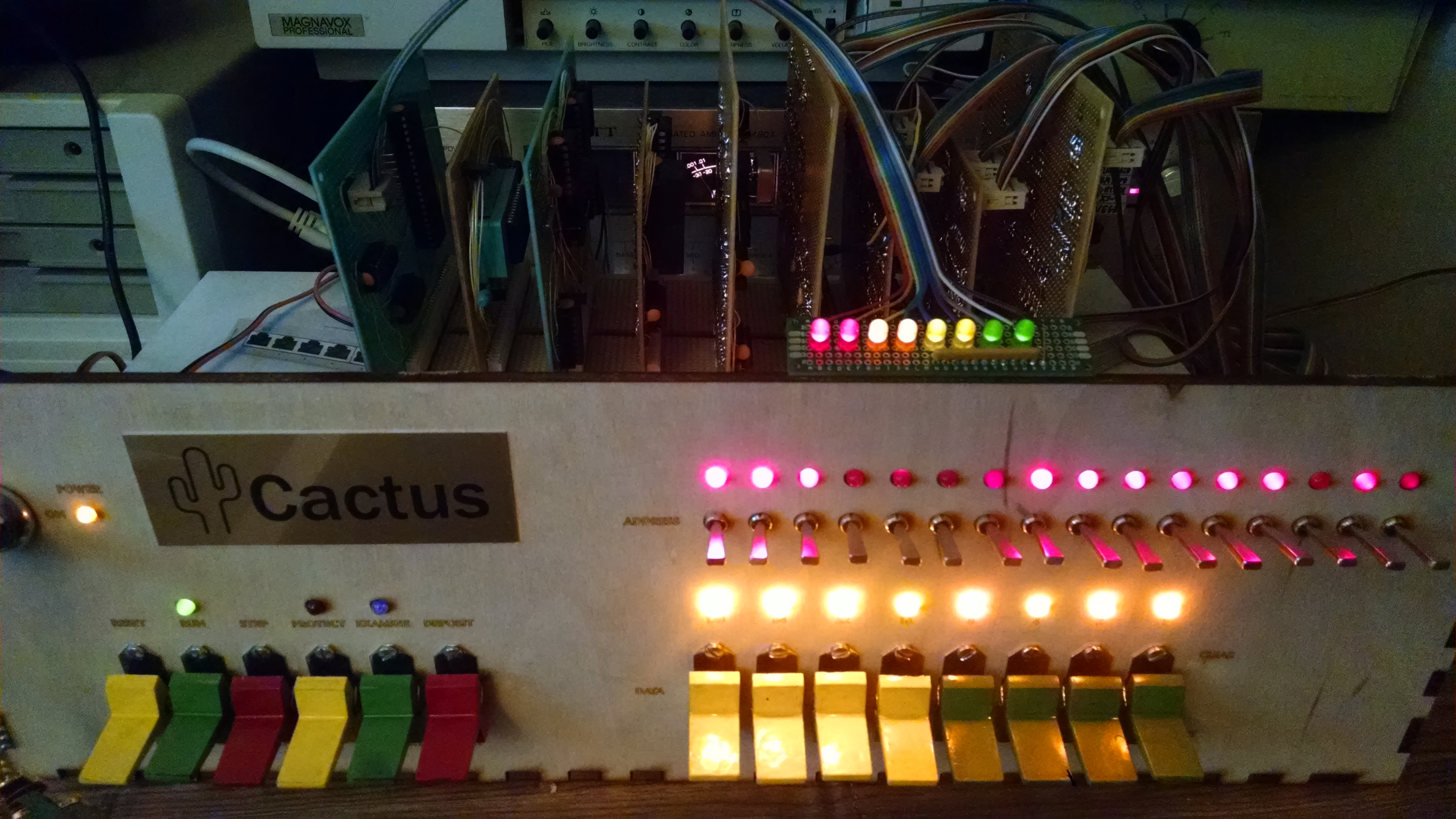

I've decided that I need to add a bank of 8 programmable LEDs, and find a way to connect up the SET side of the data switches to an input bank on the VIA. I want to program in the classic "kill the bit" game, like you might find on an Altair 8800 or IMSAI 8080. The way the front panel logic was designed on the Cactus, there are lockouts that prevent user interaction with data or address control switches while the CPU is running. I need to make sure inputs like this aren't going to interfere with the data control card, but the concept seems like it will be worth while to implement. I don't know where I'm going to put the LEDs on the panel though... that will probably have to wait until the next revision.

So I've made a few tweaks to the 6522 board. I've added a second set of headers, and made a little LED test connector. Next I've got to try my hand at using it for inputs.
6522 board
6522 board
It's fun, and useful! I didn't expect it to be that easy to control, either in BASIC or in machine language. I tested it first with assembly, and I'm slowly getting my feet wet in a realm I've never truly felt comfortable in. It's been like 9 years since I did any sort of assembly programming. Up until now, I've just been copying what I see, but this marks a turning point.
blinkenlights
blinkenlights

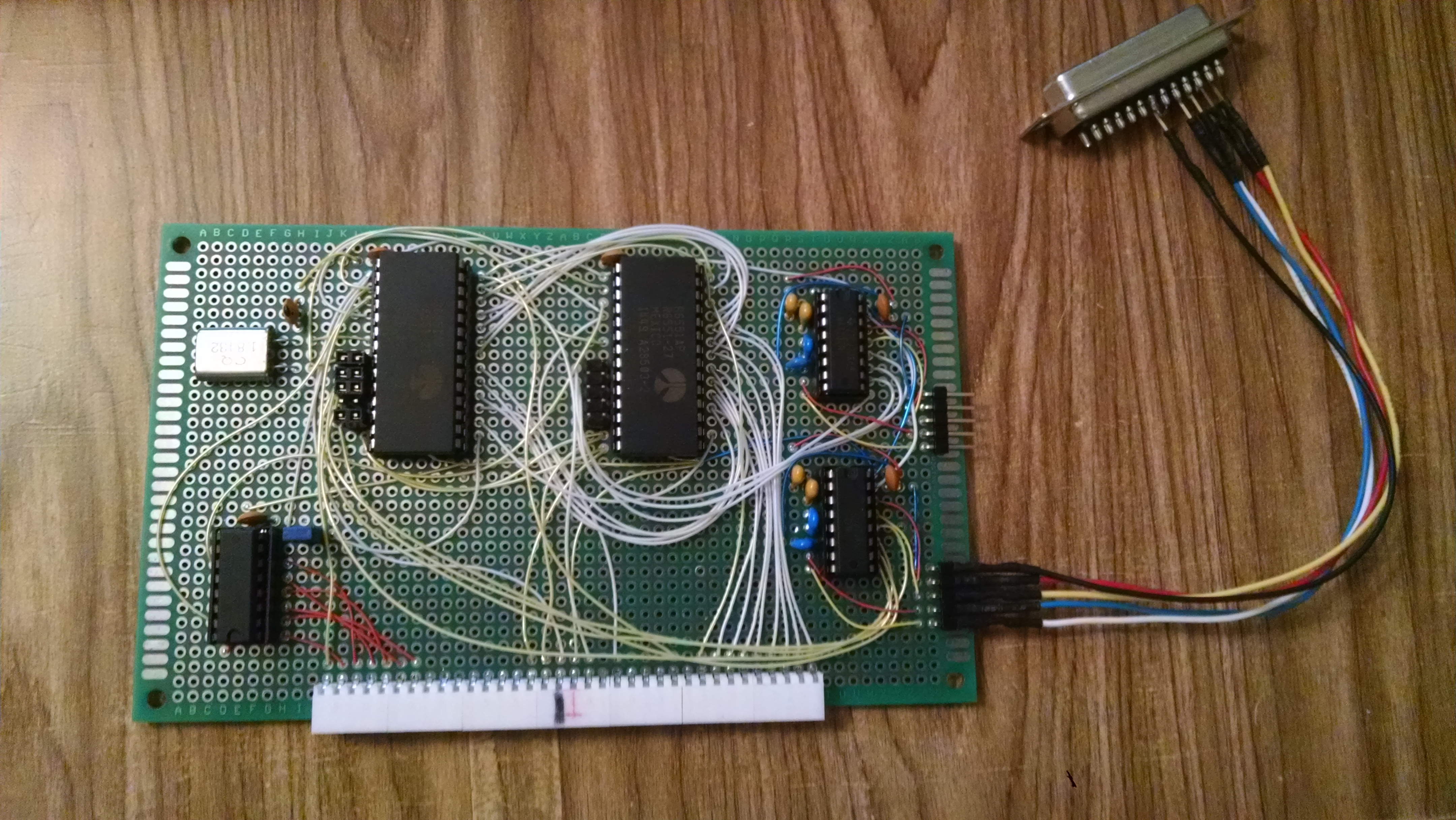

Having this kind of programmable output was essential in debugging my 6551 implementation.
dual 6551 board
dual 6551 board
It took a little while to find that the source of the issues I was having was a combination of DSR and DCD lines that were not tied to ground, and a terminal that doesn't want to obey 9600 8-N-1. Had to find other devices the Cactus could talk to. It was rather frustrating, I spent a few days on the 6551 issues, and wasn't making any headway until I had some help from Thrashbarg.

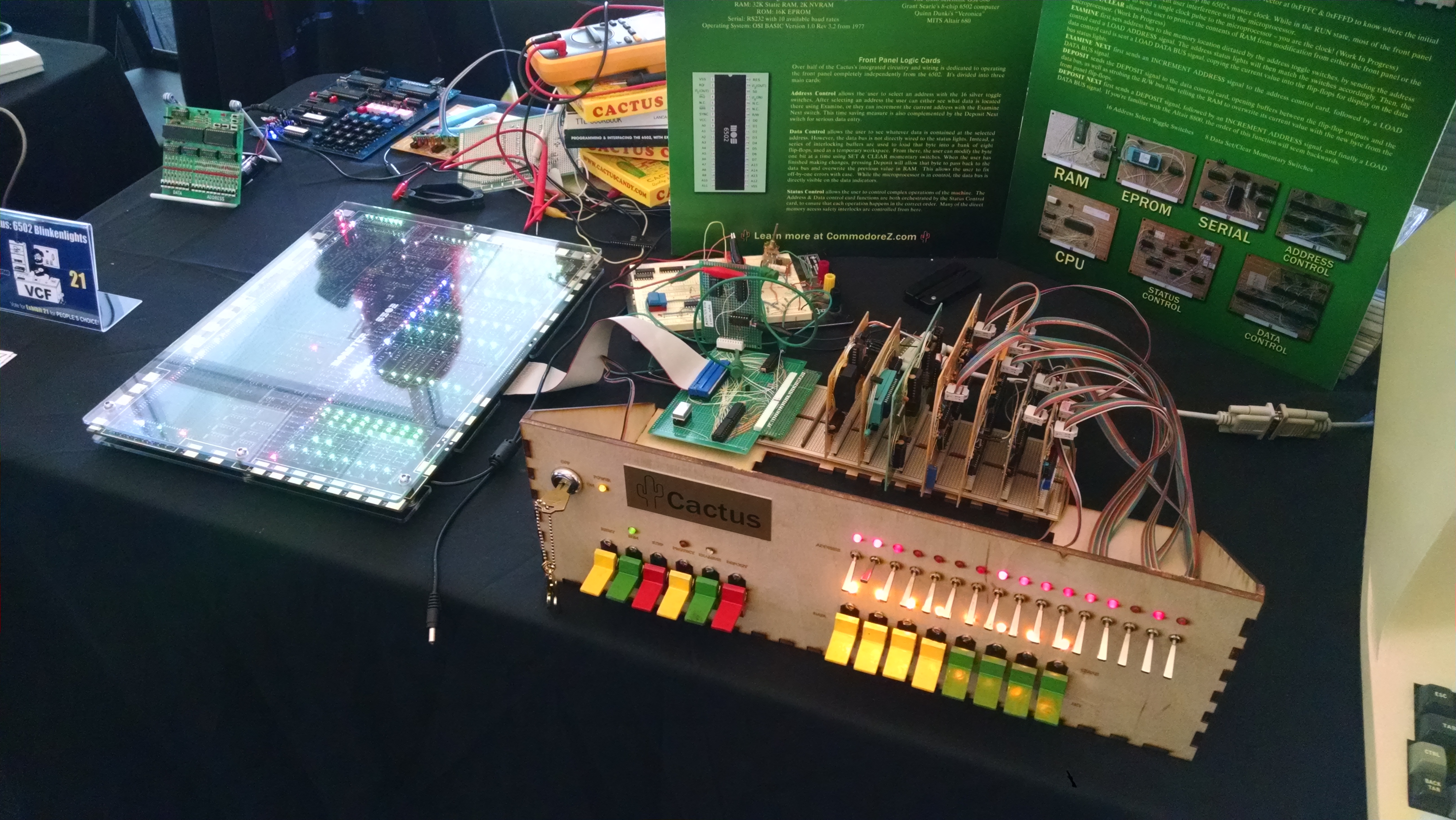

I exhibited the Cactus at VCF West on August 4th & 5th in Mountain View California, at the Computer History Museum. This was my first time at VCF West, and the atmosphere made for a different experience compared to VCF East. The Cactus was transported in a customized flight case to ensure it arrived intact. However, due to poor packing on my part, the contents shifted on its 3000 mile journey. The Deposit switch and a pair of header pins on the Status Control card were damaged in transport, and required on-site repairs before the show began. Fortunately, I was able to effect repairs, and the rest of the weekend's demonstrations went smoothly.
A few weeks prior to the show, I discovered that the MOnSter 6502 would be in attendance, along with the good folks at Evil Mad Scientist Laboratories. I reached out to its creator, Eric Schlaepfer, and asked if he would be willing to combine our two machines in an experiment. He was interested, letting me know that as long as I adhered to the NMOS specification and clocked down to 50KHz, the two should be able to work together. Normally, the Cactus relies on the 65C02's Bus Enable pin to halt the CPU and allow the front panel logic to take over to provide the user with direct memory access. I built a new processor card with additional buffers to account for the lack of such a pin on the NMOS variant, and tested it with an original Commodore 6502 from 1983.
Once at VCF West, our first attempt on Saturday pointed out that I had neglected to buffer the Read/Write line, resulting in bus contention. On Sunday, Eric brought me a breadboard, some additional jumper wires, and a few tristate buffers from his stockpile. After splicing an additional 74LS245 into the NMOS card, and testing with an NMOS 6502, we decided to try again. Lo and behold, the Cactus and the MOnSter 6502 successfully booted into BASIC, and ran at 50KHz for about half an hour, creating a spectacular fusion of blinkenlights. That makes the Cactus the third machine to use the MOnSter 6502, and the first one that wasn't made by Eric. Needless to say, this was the highlight of my weekend.
closeup
closeup
Better yet, I video evidence of the event!
