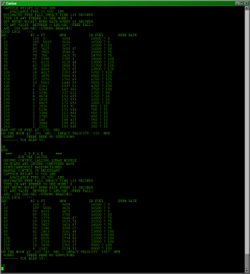

I've got a long to-do list here... but atleast I can say I've played Lunar Lander in BASIC on hardware I built!
