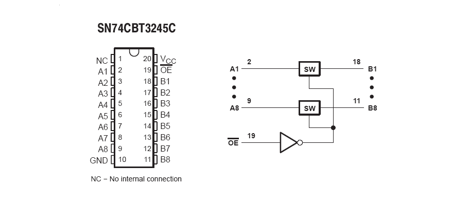

Here's some detail regarding a '245 bus "transceiver" implemented using MOSFET transmission gates similar to those in the 4066. Pin 1 -- which, on an ordinary '245, is the Direction input -- is a No-Connect. When enabled, the device behaves as a set of eight low-value resistors -- and resistors don't care about direction.
For typical applications the appeal of these products lies in their ability to connect two buses so data passes between them with virtually no propagation delay. But their similarity to 65xx internal logic makes them worth considering for your project.

Drass wrote:
e.g., 74HC541 Octal Bus Buffer Enable Time = 32ns vs. the virtually instantaneous 74CBT3245
The usual notion of propagation delay (implying active internal circuitry) doesn't apply. But inevitably the bus being driven has some amount of capacitance to ground, and putting 3 ohms in series means it'll take longer to charge or discharge that capacitance. The delay is proportional to R*C, and the delay cited in the datasheet pertains to a 15 pF load IIRC -- which is probably less than the capacitance in your application, since you presumably have the inputs of several chips attached to each bus. (Each chip that's driven contributes 5 or 10 pF, as a ballpark figure.)
For this and other reasons you can't expect the propagation delay cited in the datasheet to apply in your application. But the FET switch's bidirectional nature makes it directly equivalent to what's under the hood of an actual 6502. Perhaps it's something that'll offer you some advantage.
Re: TTL 6502 Here I come
I hope it's clear that FET bus switches drastically slash propagation delay only -- ie; not the enable/disable times

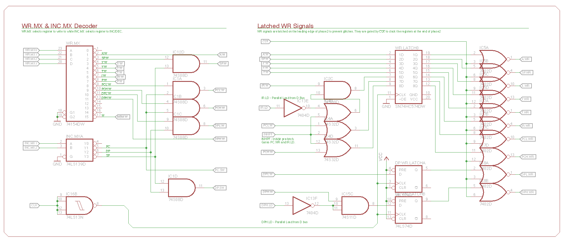

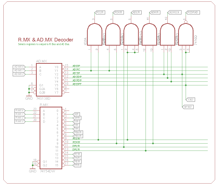

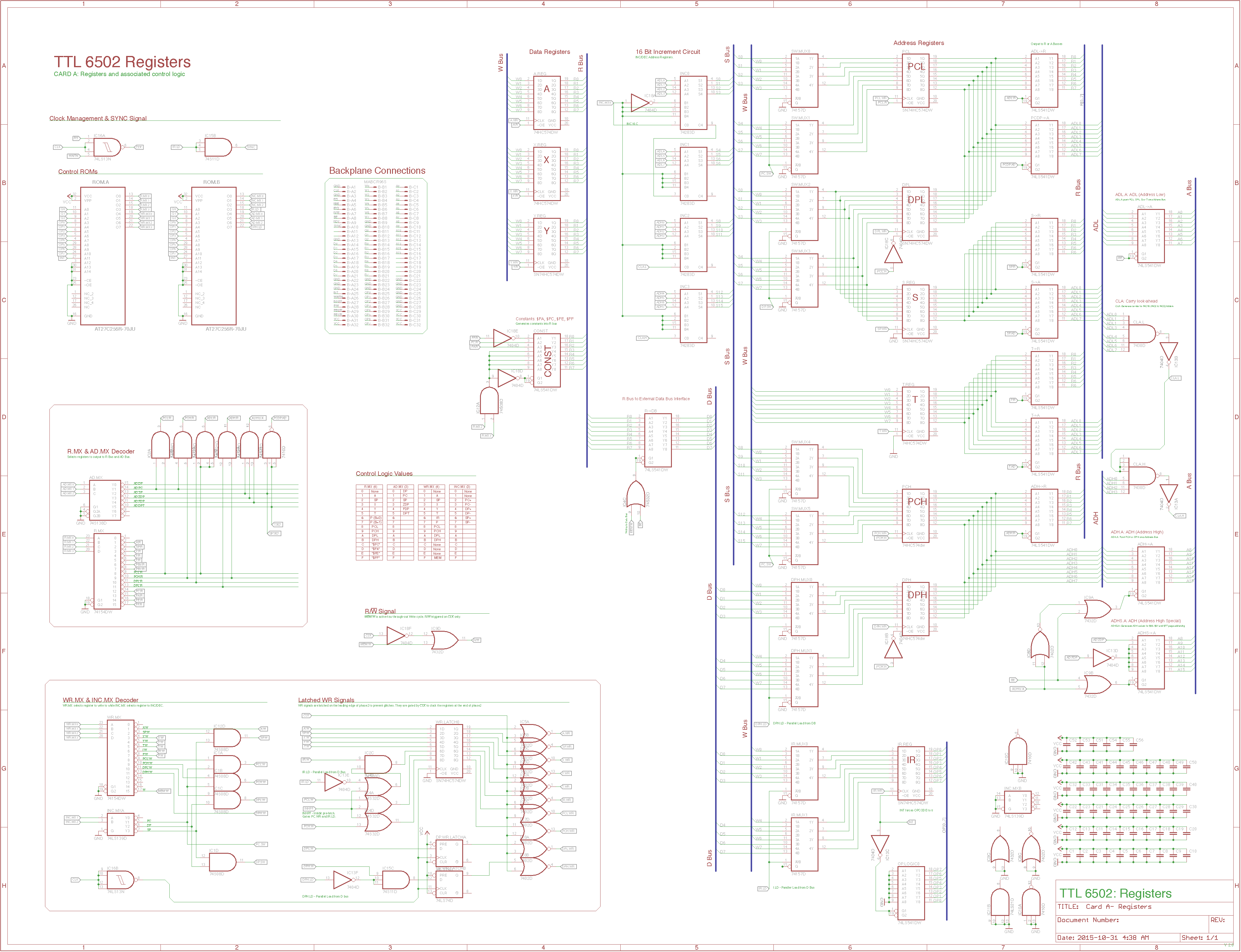

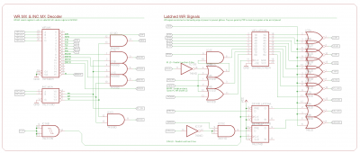

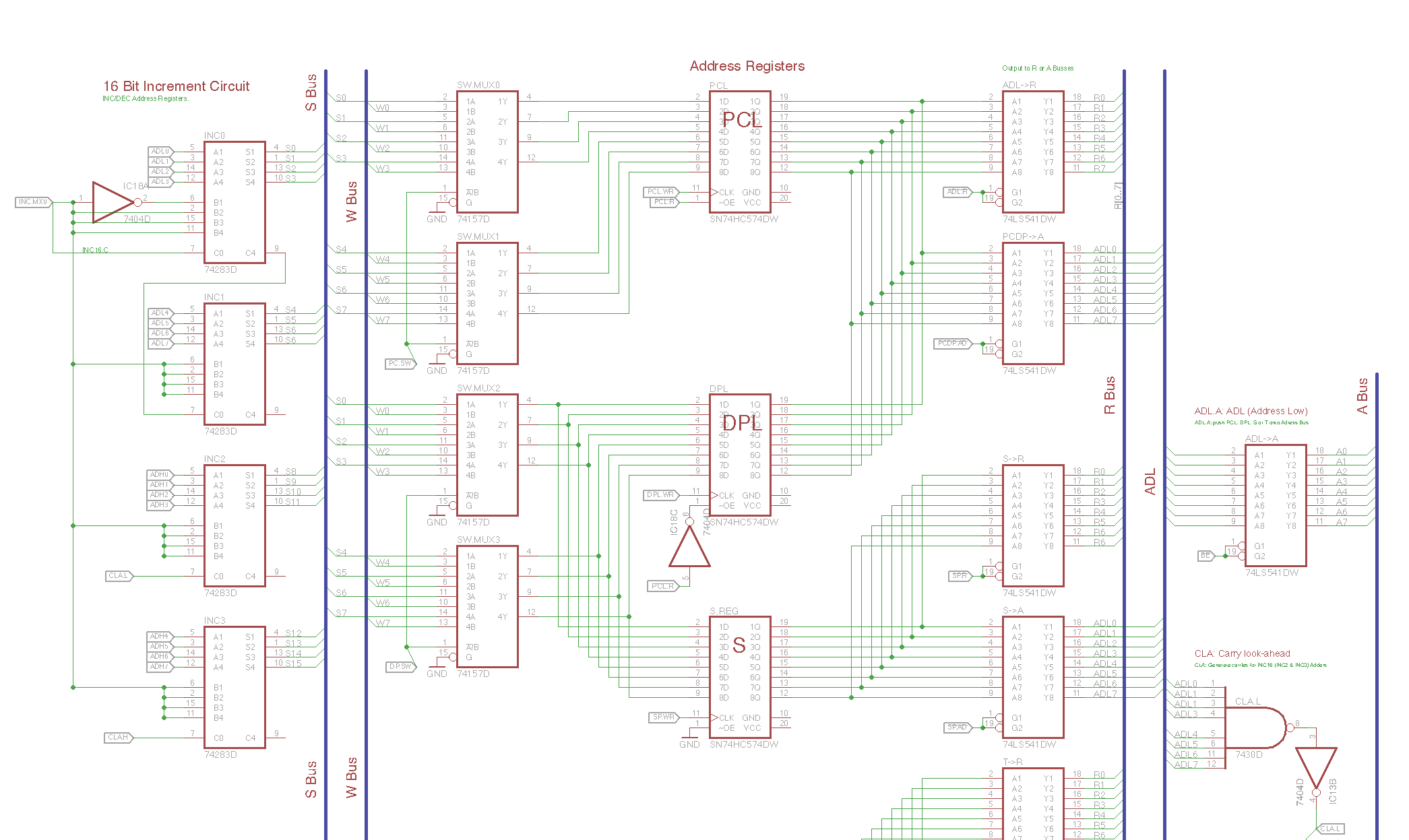

I finally finished a schematic which I'm excited to share. Apologies in advance for the long post. I've tried to provide a thorough overview to try to make this as easy as possible to follow even for relative beginners like myself.
The schematic attached is for the CPU registers and associated logic. You might note the complete absence of 74CBT3245 ICs in the schematic. In the end, I felt I had not made very good use of these chips after all and decided instead to share the design as it was before, leaving in place unidirectional busses and the ICs I had selected previously. No doubt it will make sense to revisit this but I'll press on for now and learn as we go.
Looking at the schematic attached, the data path reflects the block diagram fairly closely and has the registers between the W Bus on the left and R Bus on the right. Each register is a 74HC574 with an “R” signal to output-enable them and a “WR” signal to clock them. To the right are the address registers (PCL/PCH, DPL/DPH, SP and T). Their outputs can be routed to the R Bus or to the the internal address bus “ADL/ADH”. Similarly, their inputs can come from the W Bus or the S Bus. The S Bus is the output of the INC16 circuit. See below. On the far right are a pair of Carry Look Ahead NAND gates which feed the four 74HC283 INC16 adders. Addresses move from ADL/ADH to the external Address bus (“A Bus”) via /BE controlled 74HC541 buffers. In addition, the /ADHS.A signal sets the high-byte of the address to either ADH or a fixed value of $00, $01 or $FF depending on the address mode (ZDP, SP, FDP respectively).
DPH can be loaded directly from the external Data Bus by “DPH.LD” but it's not connected to the S Bus. Incrementing DP in fact only increments the lower 8 bits in DPL. The consequence is that DP will “warp-around” the same page if a page boundary is crossed when resolving the high-byte of an indirect address. This is also the NMOS 6502 behaviour.
IR is also loaded in parallel from the Data Bus during Fetch-Opcode operations ("IR.LD" selects that), or from the W Bus during interrupt processing. IR outputs directly to the Opcode lines (OP0 - OP7) which in turn feed the Control ROMs. The “INT” control signal is high during the first cycle of interrupt processing and thereby forces the Opcode to zero through the OP.LOGIC0 buffer.
The final item on the data path is the “R->DB" 74HC541 buffer which connects the R Bus to the external Data Bus for memory write operations. /MEM.W and /BE signals together enable this buffer for the full write-cycle.
The control circuitry is driven by two Control ROMs. Each ROM is addressed by a 3-bit “Q” state, the current 8-bit Opcode and an INT control flag. Each of the 256 possible opcodes therefore has up to 8 micro-instructions (Q values 0 to 7). The output from these ROMs is decoded to produce all the control signals according to the following table:
Finally, there is also a 96 pin connector. My plan is to put this schematic on one “Registers” card connected to a backplane. I will need at least a second card for the ALU & CU, a third for memory and I/O and a final one for video.
Ok, that pretty much covers it. Now for some questions:

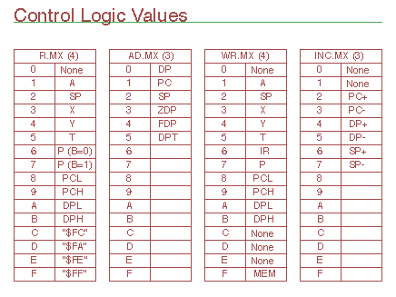

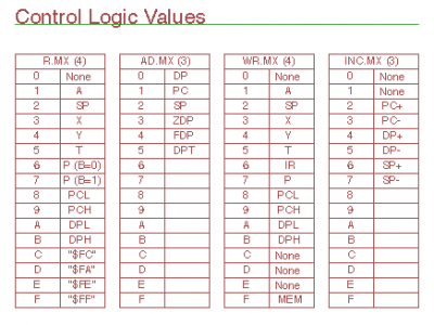

- R.MX (4 bits) selects the register to read from and various constants on the R bus. The P register can be read either with a “0” or “1” in the “B” flag.
- AD.MX selects the address register being used to drive ADL/ADH: DP, PC, SP ($01/SP), ZDP ($00/DPL), FDP ($FF/DPL), and DPT (DPH/T).
- WR.MX (4 bits) selects the register to write to. $F selects external memory (decoded as "MEM.W").
- INC.MX controls the INC16 circuit and selects which register will receive the result.
- IR.LD and DPH.LD are taken directly from the control ROMs without decoding
- Any tips to improve the schematics?
- Are there any obvious electrical problems evident, either with on-board or backplane connections?
- Are there more efficient ways to deal with the various addressing requirements (PC, DP, SP, ZDP, etc.)?
- I could use a wider control word and eliminate the MX decoding logic entirely. There are clear speed advantages to that, but as it stands, I am using 16 bits to encode 38 control signals. Any thoughts or suggestions with respect to this arrangement?
- I have left the busses active as Garth had suggested, using /BE to tri-state them under external control. Any issues now?
- I am using Schmitt-trigger gates for the clock signal. All other signals are taken from 96-pin header directly . Is that ok? Should off-board signals be buffered in some way?
Best,
Drass

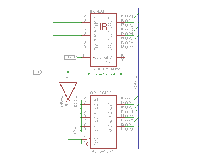

Thanks for the detailed info, Drass. I haven't yet had a close look but one little improvement did jump out at me. If it works it'll slightly reduce the package count.
In Card A-Registers.png the signal called INT causes $00 to replace the opcode applied to OP[0:7]. If a 74xx273 replaced the '574 (both are octal edge-triggered registers) then the '541 at the bottom of the excerpt below would no longer be required. '273 features an asynchronous Clear input, so that'll give you the $00 when you need it. But there's less tolerance for glitches on INT because the Clear is irreversible, so that needs consideration.
There may be other changes like this that'll reduce package count. But, now that I see what you're doing, it doesn't seem those bidirectional switches would be of much use!
BTW I wonder whether microcode changes might be all that's required to support new instructions of your own creation. I know your initial plan is for undefined opcodes to be NOPs but maybe later you could revisit that...

Great suggestion Jeff! I'm just not familiar enough with the 7400 chips and these kinds of subtleties elude me. Really appreciate you taking the time to have a look. Thank you!
