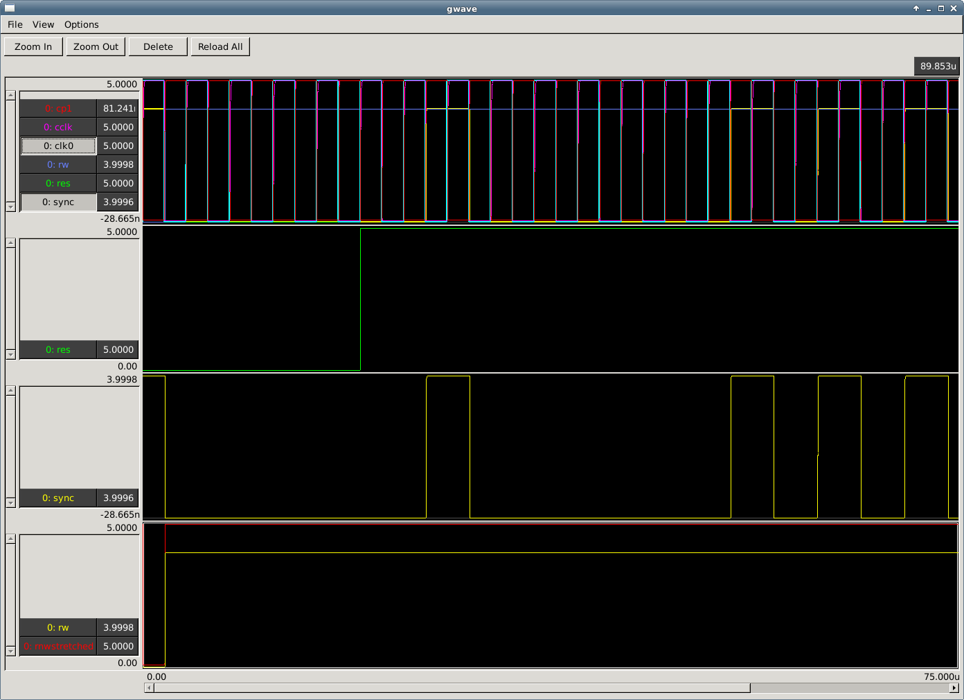

I was able to run a short test simulation - it took about 30 mins to run through reset and then 20mins to do 10 cycles of instructions.

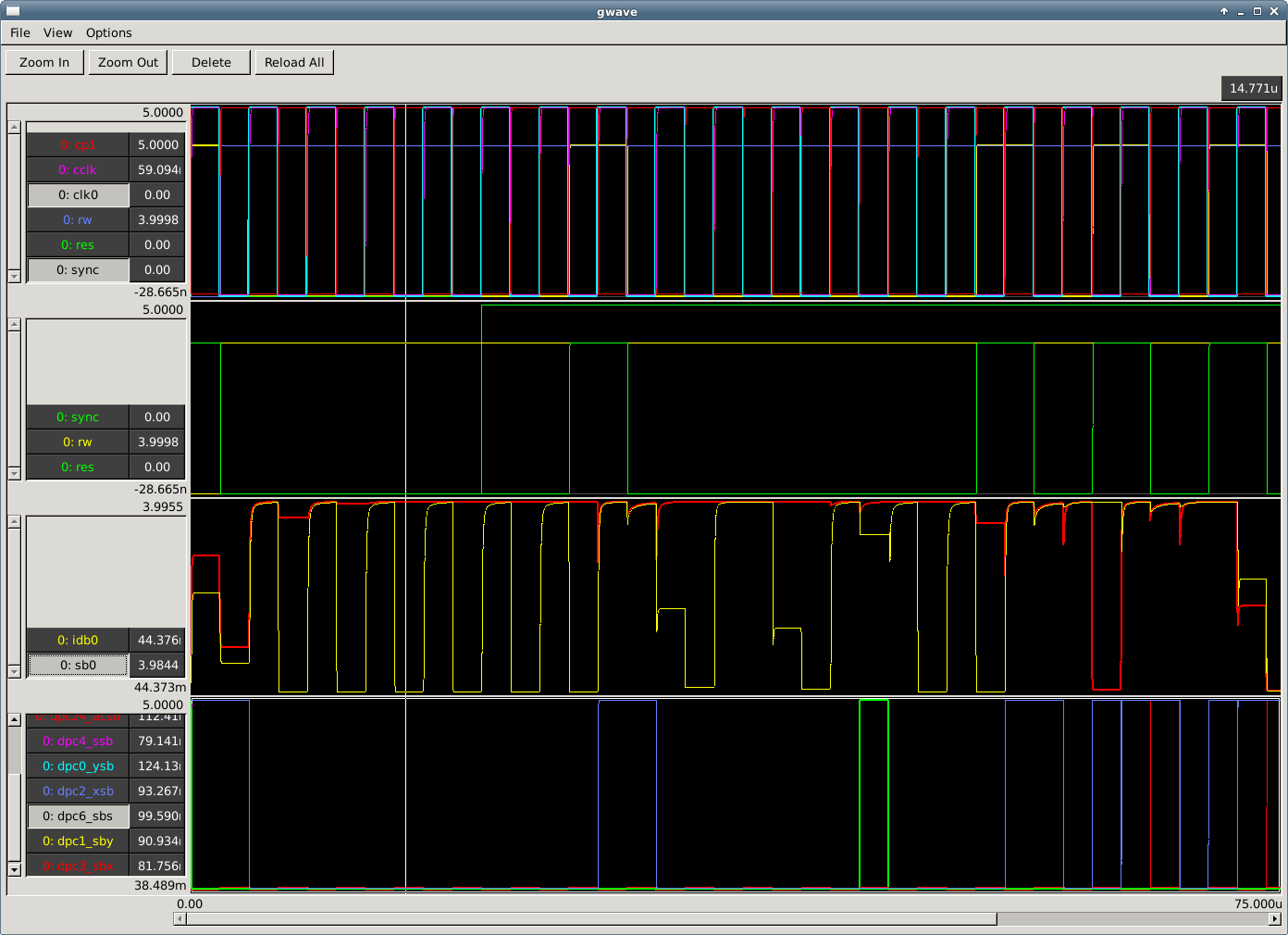

Of interest in these traces:
    - internal busses only rise to 4V or so due to NMOS threshold drop
    - the so-called precharge often fights against pulldowns during phi2 rseulting in an intermediate voltage
    - sometimes a bus will rapidly drop by a small voltage as it charge-shares with another bus

Edit: uploaded a new image of the waveforms, as the old one had rotted away. You can see the reset signal rising, and the sync signal showing activity. You can also see the voltages on the special bus and internal databus not always being full-rail.
