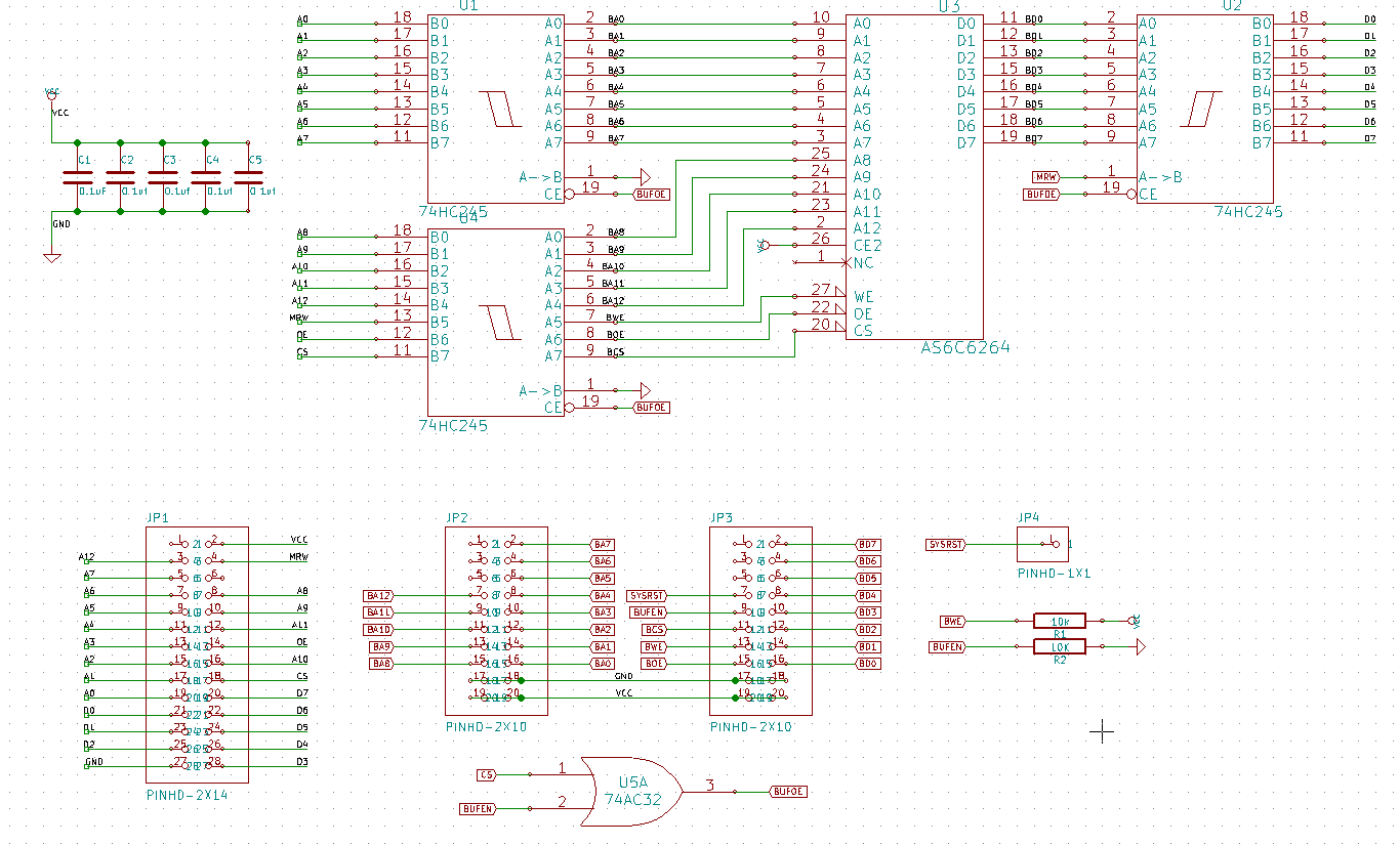

I made mine using an SRAM, Buffers and an OR gate
While programming the buffers isolate the SRAM and hold the system in RESET
JP2 & JP3 plug into my raspberry pi, JP1 connects to a ribbon cable with one of these on the other end.
It would be pretty simple to attach to an AVR instead.
