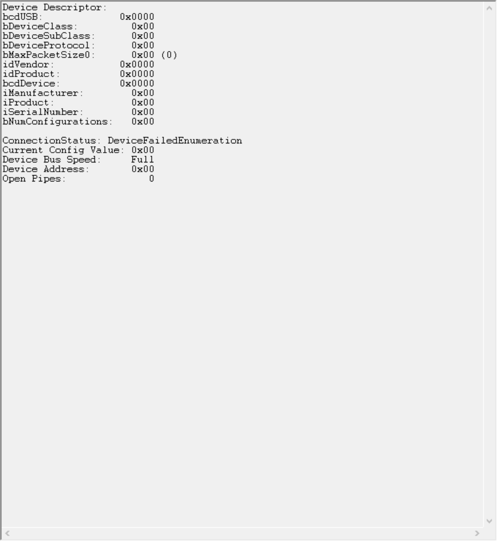

Proxy wrote:
what doesn't works is the FTDI USB Chip. my PC sees that there is a USB Device but it aparently cannot read what it is from the device... which is strange
Proxy wrote:
Either way I likely have to redesign the USB part of the board anyways so sadly I have to reorder new boards and wait even longer...
Looking at the device data sheet, I notice two things.
First, it's not a particularly high-speed device, even by '80s standards. It uses USB 2.0 full speed, 12 Mbps. I'm not convinced that a slightly suboptimal layout of it would cause serious problems. (I suspect that the document you were looking at about layout etc. may be more about USB 2.0 high speed, which at 480 Mbps is something where I'd imagine those kinds of layout techniques do make a noticable difference.)
Second, it looks as if it may not be implementing any of the standard device classes that would allow most OSes to immediately let you start using the device. The data sheet says, "FTDI’s royalty-free Virtual Com Port (VCP) and Direct (D2XX) drivers eliminate the requirement for USB driver development in most cases." Given that they supply their own drivers for "com port" and bulk data transfer, it would be reasonable that they wouldn't bother also to implement other standard protocols that are either less suitable (USB block storage device) or annoyingly slow (USB serial) for the application.
I would carefully debug the existing board before ordering a new one. (It would be particularly frustrating to re-spin the board only to find the same problems!)
  • If you're using Windows, make sure the correct drivers from FTDI are installed. Use any debugging tools they supply.
  • You can plug the board into a Linux box and see what the kernel messages say about it. If it successfully attaches a generic device, you can use command line tools such as lsusb to get more details about exactly what it found, including device and endpoint descriptors.
  • If Linux fails to attach even a generic device, try different cables and, if that fails, get a 'scope on to the D+ and D- lines (both ends!) to see what's going on there.
  • Using either Linux or Windows, you can write small programs using libusb to poke at and probe the device to see how far you can get with communicating with it.
Obviously all of this is going to require some knowledge about how USB works. I have seen a great set of pages on this that could get someone at your level up to speed in no time flat, but I can't find the darn things now. :-( But this article is short and might be fairly useful, and it also is probably worth at least scanning through the info on Wikipedia. I'll try to find better resources as we go along.
hmm, i did read about that on StackExchange, i still thought my design would be a problem because the traces are around 3cm long and go through a TH Resistor each.
I did install the FTDI drivers before connecting it, it still gave the "device descriptor request failed" error message.
i assume if the chip wouldn't respond/work at all it just wouldn't show up in the device manager. (like any non data transfering USB device does)
Which is the reason I think that there is a problem on the PCB as even without drivers it should still show up as an unknown device (with Hardware ID and everything) without any errors.

the USBView program from FTDI shows strange stuff.
here is what my keyboard looks like in it:
and here what the FT240X looks like:

Posts: 3526
Re: Starting with my first SBC Project, Plans and Confusions
Proxy wrote:
i tried multiple cables, and currently i'm used the same cable i use for my TL866 II plus Programmer, so i know it's not the cable.
I would consider trying a different computer in case there's a defect on its USB port or something associated.
That may seem impossible, given that your TL866 II (presumably) works using that port. But it's possible for a USB port to be semi-defective -- I have witnessed this. I have a laptop with two USB ports. One of the ports isn't right -- it communicates properly with some devices but not others. It caused me some head scratching at first!
