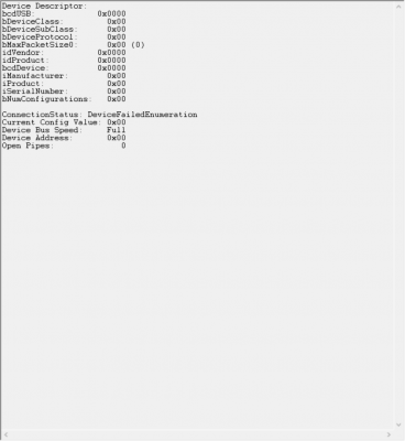

I did install the FTDI drivers before connecting it, it still gave the "device descriptor request failed" error message.
i assume if the chip wouldn't respond/work at all it just wouldn't show up in the device manager. (like any non data transfering USB device does)
Which is the reason I think that there is a problem on the PCB as even without drivers it should still show up as an unknown device (with Hardware ID and everything) without any errors.

I checked all pins twice, with help of the datasheet, and all connections look and measured correctly (also no shorts between pins), I made sure the D+ and D- lines are correct and not switched around.
if this picture is accurate then i got the D- line connected to Pin 14 (USBDM) and D+ connected to Pin 13 (USBDP), which should be the right way around (acording to the datasheet)

I know next to nothing about linux so i don't know how to do any of those things... and google isn't really helpful either sady...
i tried multiple cables, and currently i'm used the same cable i use for my TL866 II plus Programmer, so i know it's not the cable.
plus i sadly don't have an oscilloscope. i only got a simple logic probe (which is enough to tell that there is activity on both the D+ and D- bus)
the USBView program from FTDI shows strange stuff.
here is what my keyboard looks like in it:
and here what the FT240X looks like:
I would consider trying a different computer in case there's a defect on its USB port or something associated.
That may seem impossible, given that your TL866 II (presumably) works using that port. But it's possible for a USB port to be semi-defective -- I have witnessed this. I have a laptop with two USB ports. One of the ports isn't right -- it communicates properly with some devices but not others. It caused me some head scratching at first!
