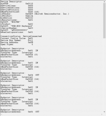

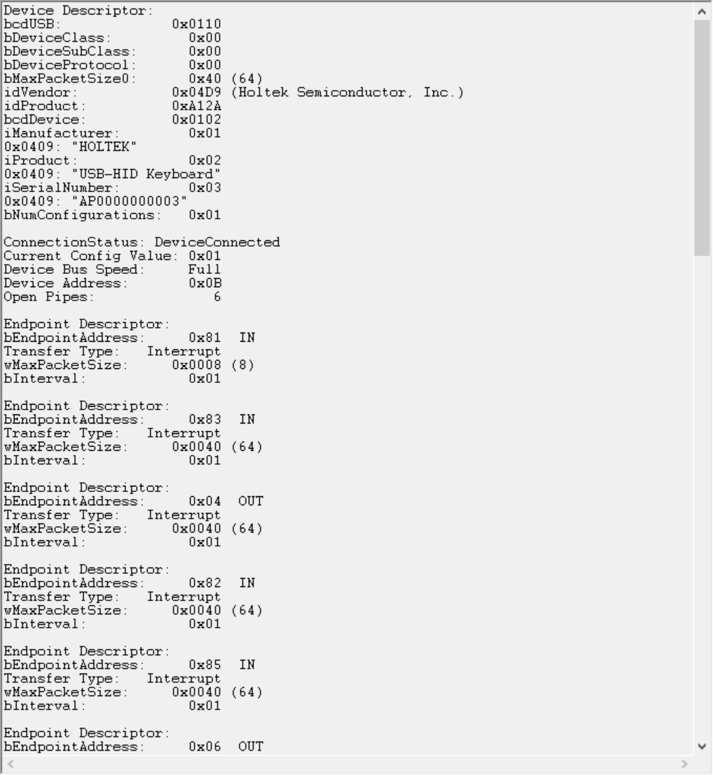

the USBView program from FTDI shows strange stuff.
here is what my keyboard looks like in it:
and here what the FT240X looks like:
