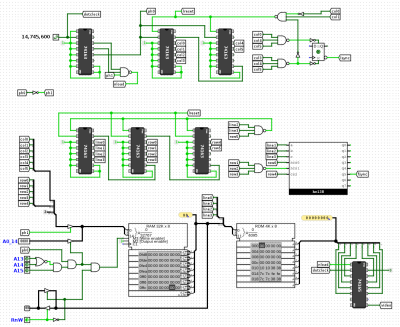

One caveat: the TTL implementations provided by default in Logisim Evolution are missing some (to me) obvious parts (e.g. 138, 374, 541) and I have a vague memory of finding one part which didn't behave as the datasheet suggested it should (and I can't recall which!).
I haven't been able to find a reference to create new parts or edit existing ones, so I often need to use gate-level simulations of TTL parts.
Attached is a simulation for a simple VGA output extension for a computer based on Grant Searle's minimal system - it's currently untested as I haven't built it yet, but the PCB is pretty.

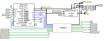

I've used Logisim Evolution pretty extensively to simulate a computer using a W65C816 and 74 series ICs. And met with mixed results.
Logisim is amazing as a logic gate simulator and also one of the most intuitive editors I've used in terms of just being able to draw up a circuit. Logisim Evolution takes Logisim (actually Logisim Holy Cross) and adds a lot of missing features, performance and general quality of life improvements. But. Also includes some very verilog related restrictions and introduces some pretty bad bugs*.
I'd recommend Logisim Evolution to start with but it becomes fragile with large circuits. And as barnacle has said it is also missing a lot of the common 74 series ICs.

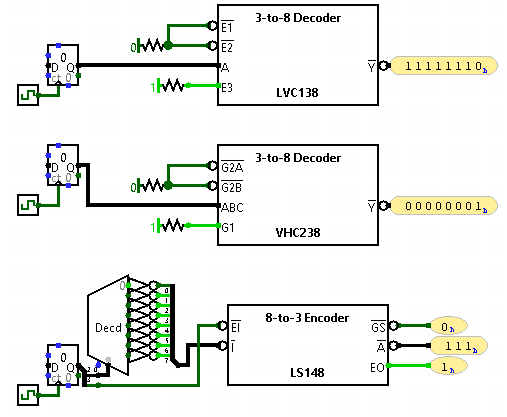

I've coded up a bunch of them myself (including the 138, 374, 541)
And they are all publicly available with an unfortunate caveat. To simulate the W65C816 I had to make a change to the Logisim Evolution source. That pull request was accepted into 3.7.1 but was then overwritten by someone else's bad merge and lost.
