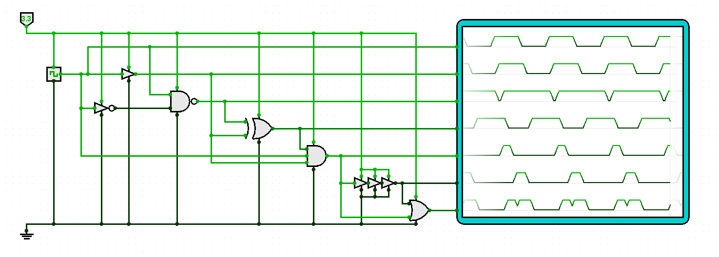

Now that would be nice. Analog's ltspice ... simulator available in KiCad
I found them both way overkill for what I want (a logic simulator) and a mission to setup.
And with all of that said...
don't hold your breath, but
I'm working on simulator specifically for building a computer around the 65816 that does understand propagation delays, voltage levels, 74 series ICs, has a similar interface to Logisim and is simpler (and thus faster) than a proper Spice simulator. (and has enough detail that it can export a complete KiCad schematic*)
There's still a lot of work ahead before I can really post about it in its own thread but I'm hoping it will be tool that can simulate most of the designs I've seen on this forum.
