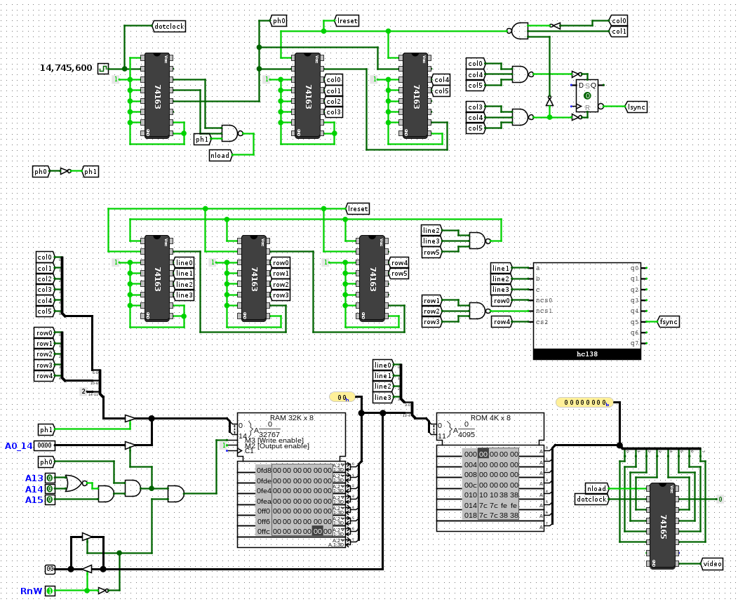

Attached is a simulation for a simple VGA output extension for a computer based on Grant Searle's minimal system - it's currently untested as I haven't built it yet, but the PCB is pretty.
