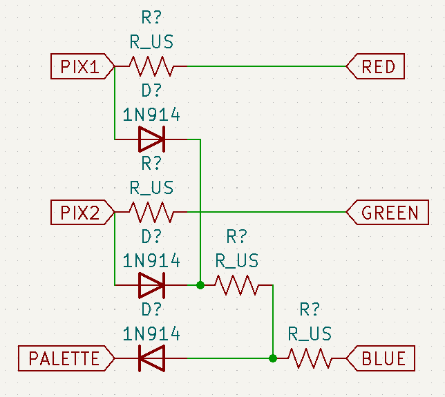

Been trying to configure my new color scheme for VGA output. Nothing new there for me. I use resistors to bring 5V down to a range of 0V to 0.7V, super straight forward.
What I never considered was the current. I am using falstad.com for simulation purposes, and I'm seeing that even my most basic circuit to display a white color is taking around 25mA. All of this coming from a single 74HC166. Here is a link to the datasheet, https://assets.nexperia.com/documents/d ... HCT166.pdf. According to the datasheet (if I'm reading this correctly) it is only able to supply 25mA of output current. Is this correct?
So then, I'm barely within margin! That is not good.
My new planned configuration that is more complicated and using diodes seems to take around 40mA. If I am understanding all of this correctly, then that would not work at all. Right? Not just to a monitor, but what in general are the effects of not having enough amps to power something? Sporadic behavior? "Always off"?
Likewise that would be 40mA going through a 1N914 diode. I see on it's datasheet that it is rated up to 200mA, I think, so this shouldn't be a problem, correct? If I am pushing margins on current supplied to a diode, would it just get hot? Could it explode?
I am not an electrical engineer, obviously. This is 101 material for most of you. Any help and clarification is much appreciated.

Can you post a schematic of your "resistor" and your "diode" versions of your circuit? The monitor has 75 Ohm resistors to ground on the signal lines, so to get 0.7V you shouldn't be sending more than about 9mA into the monitor on any given signal line.
-SamCoVT

Attached is a picture of my 'diode' setup. I ran that through falstad.com as well, but I didn't save a link.
Thank you!
Chad
EDIT: I realize that I don't have resistor values on that picture. I found some configuration to make it work, but again it was showing 40mA of current usage on falstad.

That simulation is helpful as it shows the resistor values (470 Ohms series resistor on each line). In that simulation, I see the TOTAL current from the 5V supply in your simple simulation is about 25mA, however the 74HC166 will only be driving one of the three paths (eg. you will need one '166 for PIX1, another for PIX2, and a third for PALLETE (unless you want to use something simpler like a latch to control the pallete). In your simulation, you can see there is only 9.2mA going down a particular branch, and that's what the '166 will be sourcing for current (probably a tiny bit less, if you were to measure). That is comfortably within the limits of the part.
For your dioded version, having values on your schematic (even if you aren't sure if they are right) will allow a more thorough analysis. It looks like PIX1 and PIX2 will have to source a bit more current if PALLETE is low, but you should be looking at the branch currents rather than the total from the supply because that's what the IC driving that line will have to source (or sink, in the case of PALLETE with the diodes).
-SamCoVT

Actually that particular simulation is using a single '166 for all three lines. On my current board, I have the monochrome display setup like falstad is set up there. BUT, as you are looking ahead, yes, the PIX1 and PIX2 will be driven individually, along with PALETTE. Correct.
-SamCoVT
Exactly, I remember seeing a lot of load going through PIX1 and PIX2 when PALETTE was grounded. Like, 40mA was going through the system, and it was coming all from a pair of '166s. But when only one PIX is high and the other low, that 40mA has got to come from a single '166 which is just too much!

Here is the link to the diode version in falstad.
http://falstad.com/circuit/circuitjs.ht ... vi3uxBWFAA
I turned off PIX2 and PALETTE, so that makes PIX1 needing to drive 45mA! I can adjust the resistor values some to minimize this, but then that affects my intended colors which I'm hoping to not do.
