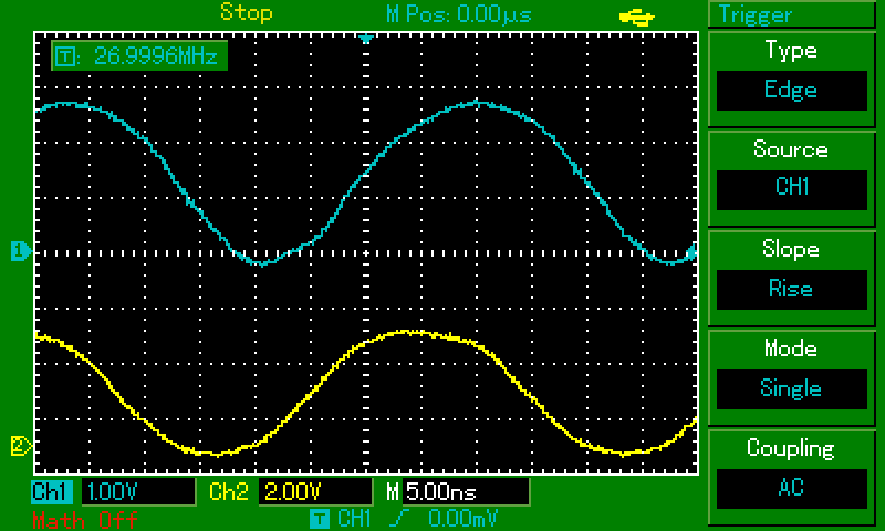

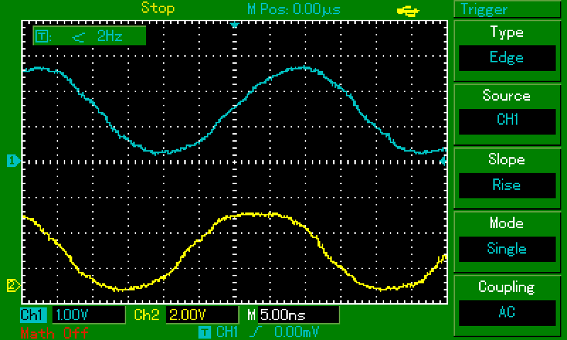

Re: Voltage and Current
Well, here it is and it's not very promising.
This trace is using the 2N2222. The input signal (yellow) is 27MHz @ 5V p-p and the output is 2.5v p-p into 47 ohms. Base is being driven through 360 ohms.
This trace is using a 2N3904. A tad better with an output of 3V p-p.
A better transistor will be needed to get closer to your goal.

But if you are saying there would be signal loss at 25 MHz, then indeed I would need a better transistor. I am sure I can handle delay, but I cannot handle signal loss.
@Garth: Yes, square wave. So are you saying it could only operate at 2.5 MHz with a square wave?
Chad
