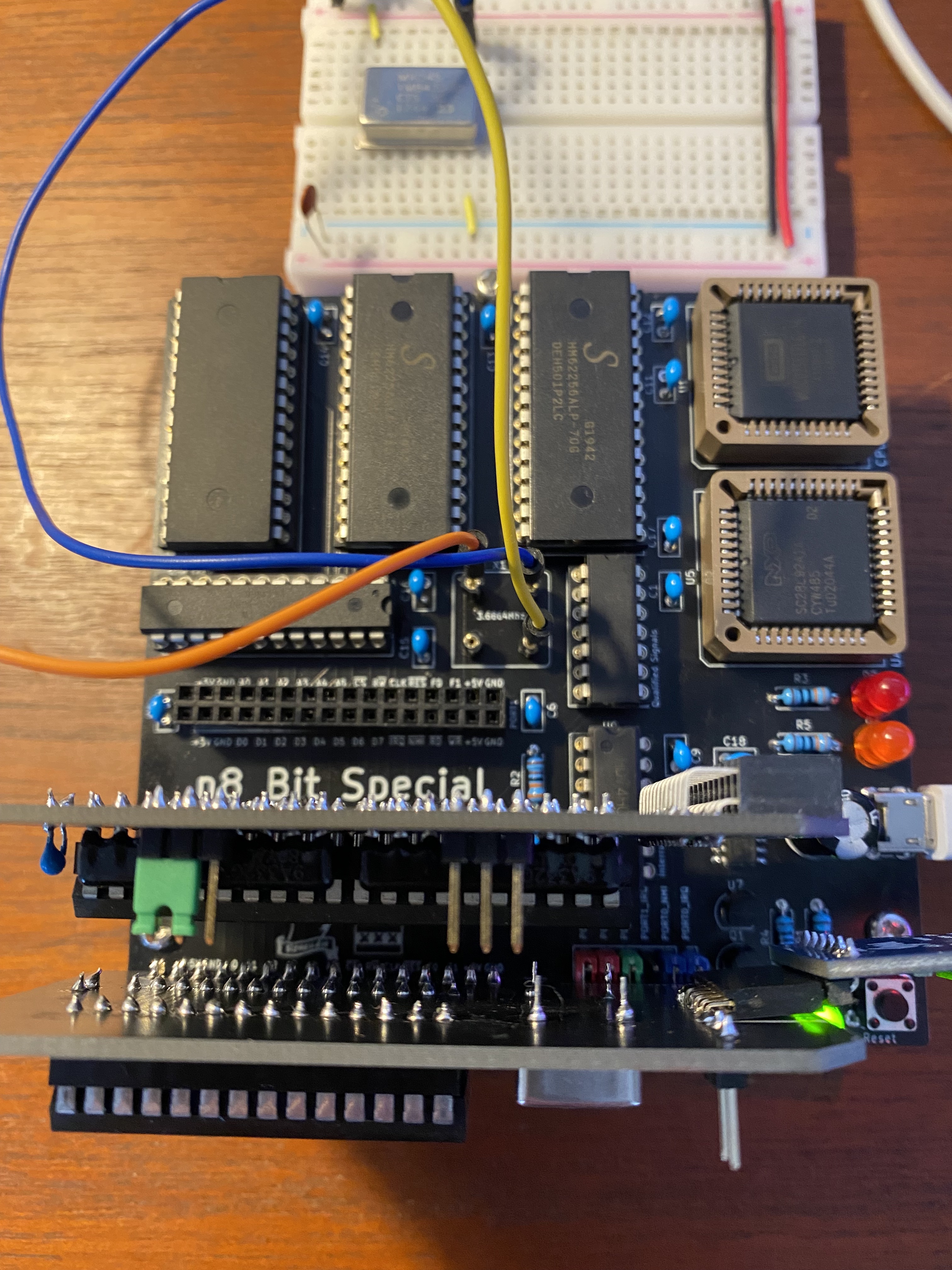

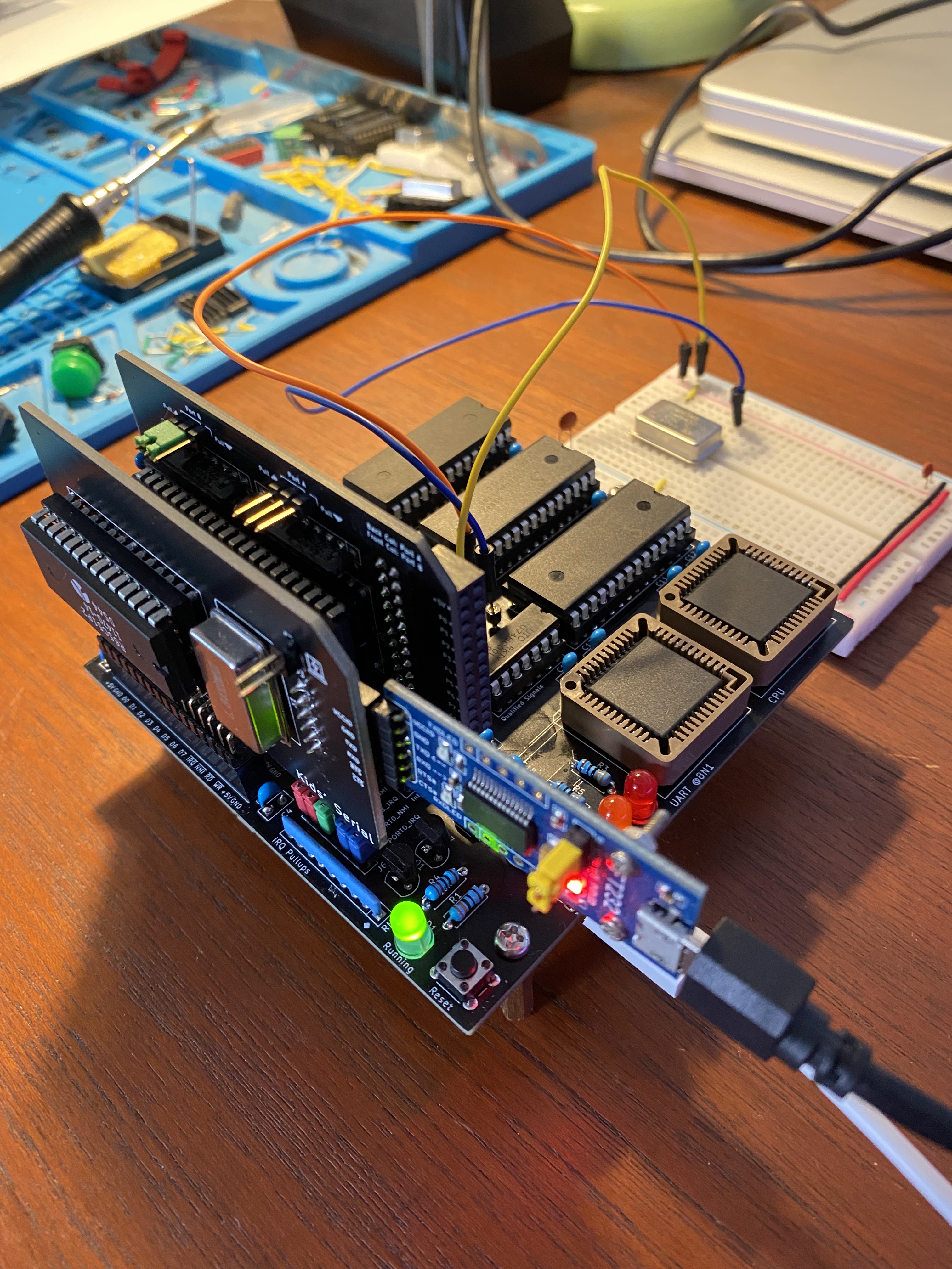

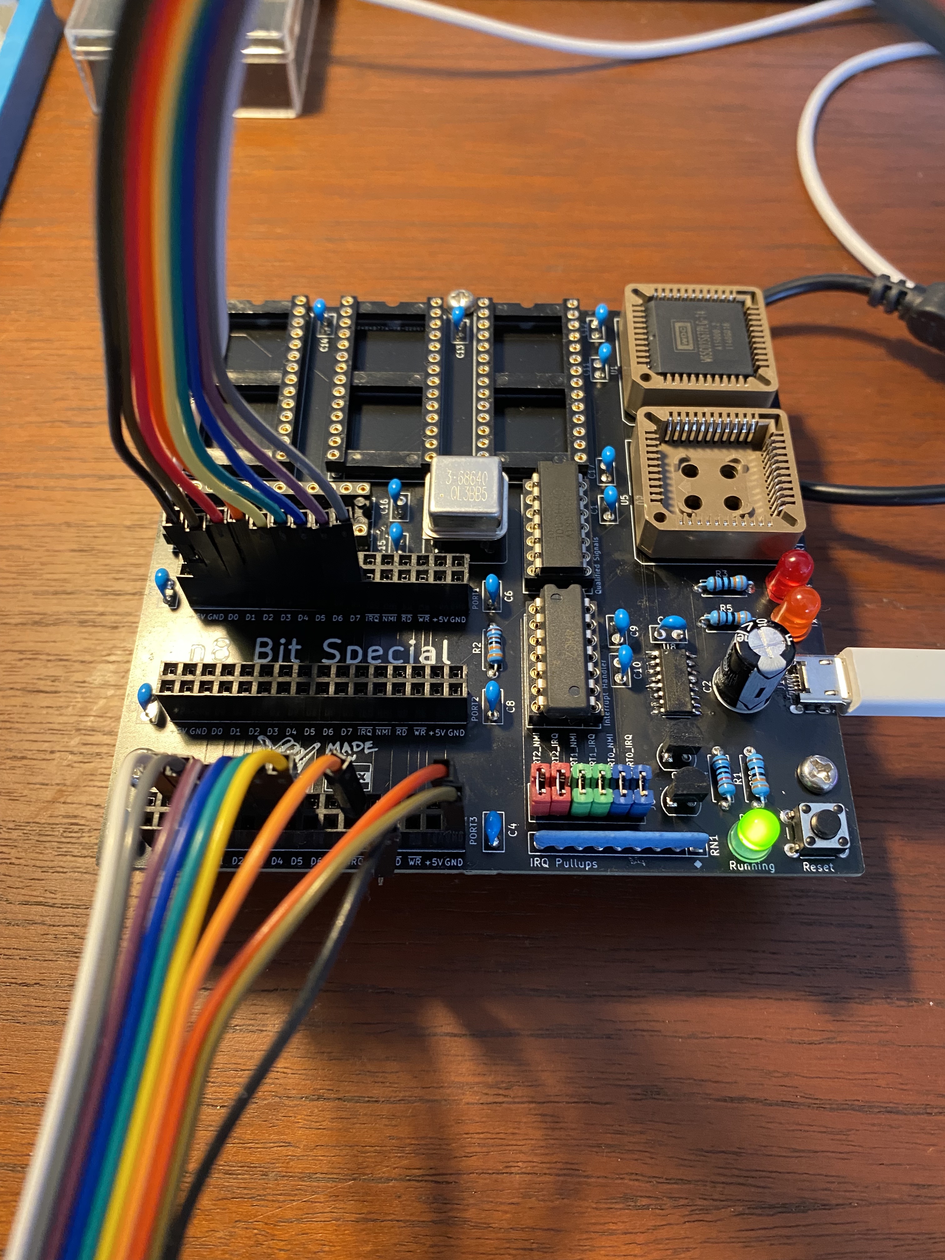

As promised here are some real-world photos of the n8 Bit Special in action! My first test was a free-run test. I hardcoded $EA on the databus and observed the low 6 address bits from an expansion port. A very complicated clock divider!
File comment: n8 bit v2 free run test
Next I hooked up RAM (x2), ROM, a VIA and an ACIA. It's running an old version of the ROM that isn't SC28L92 aware. Here i have both the ACIA and SC28L92 hooked up to my computer so I can bootstrap an SC28L92 driver.
File comment: overhead of n8 bit v2
File comment: side of n8 bit v2
