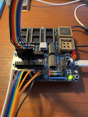

As promised here are some real-world photos of the n8 Bit Special in action! My first test was a free-run test. I hardcoded $EA on the databus and observed the low 6 address bits from an expansion port. A very complicated clock divider!

Congrats on the SBC V2... looks nice... tidy layout. A few things to note:
- It would have been more flexible to have separate the clocks for the CPU and the SC28L92.
- Looking at your WinCUPL config, you shouldn't qualify RAM selects with Ph2 of the clock, only the Read/Write lines, which you did. It might create some odd timings and put things on the edge.
- If you were to just connect A15 to the /CS line of the lower RAM, you could free up a line on the 22V10 and generate the Read and Write signals for ROM/RAM, I/O without the 74HC00.
Of course, the last comment states that the first 32KB will always be RAM.
Lastly, feel free to look at my GitHub page... I have BIOS code that configures and runs the SC28L92 for both serial ports and the counter/timer used as a jiffy clock.
Yes it would, but one of my major goals was to just make it as compact as possible to get that sweet JCB PCB price point, $8 for 5 4-layer boards as of this writing. In the future, if things go well, I can double the clock to 7,something (not going to do the math right now :D ) and just change some DUART settings
I no longer qualify them on the GAL. I need to upload my latest (there are some changes made to GAL and ROM that aren't reflected in the repo right now)
This is an intriguing idea for the future. I did pipe CLK and R~W into the GAL for these exact kinds of reasons. Will play with this but maybe in a month or two. The high of a working new design hasn't worn off yet.
I will do this. I am running into trouble where interrupts aren't firing!

As flooby said, you should drive your 28L92 with its own oscillator (3.6864 MHz for standard bit rates). In my POC units, I use a 50 PPM part for that, since the system clocks are ultimately driven by a jiffy IRQ from the L92, and I'm a bit of a fuss-budget when it comes to clock stability. :D The oscillator that powers the MPU is a standard 100 PPM unit run through a flip-flop to strengthen the signal and assure it’s symmetric. Ø2 symmetry at low clock rates isn't important, but becomes so as you close in on the MPU’s maximum clock rating.
The other thing, as flooby noted, is to not use Ø2 to qualify chip selects. Doing so not only creates the potential for weird timing problems, it grossly narrows the window in which reliable device access is possible, which will lower the Ø2 frequency ceiling.
Which interrupts?
Aside from reviewing flooby's code, do a search on the 28L92 here. There's a fair amount of stuff to be found that might help you. The attached might also be of some help, although it was written for the 28L91 and is not complete.

It turns out the interrupts weren't firing because I was writing to $05 (the IMR offset) instead of DUART_BASE+$05 :( All cleared up now. So far no problems running both the system and 28L92 from same 3,6Mhz main clock source.
I also pushed actual GAL PLD code which does not qualify CLK with any CS signals.
