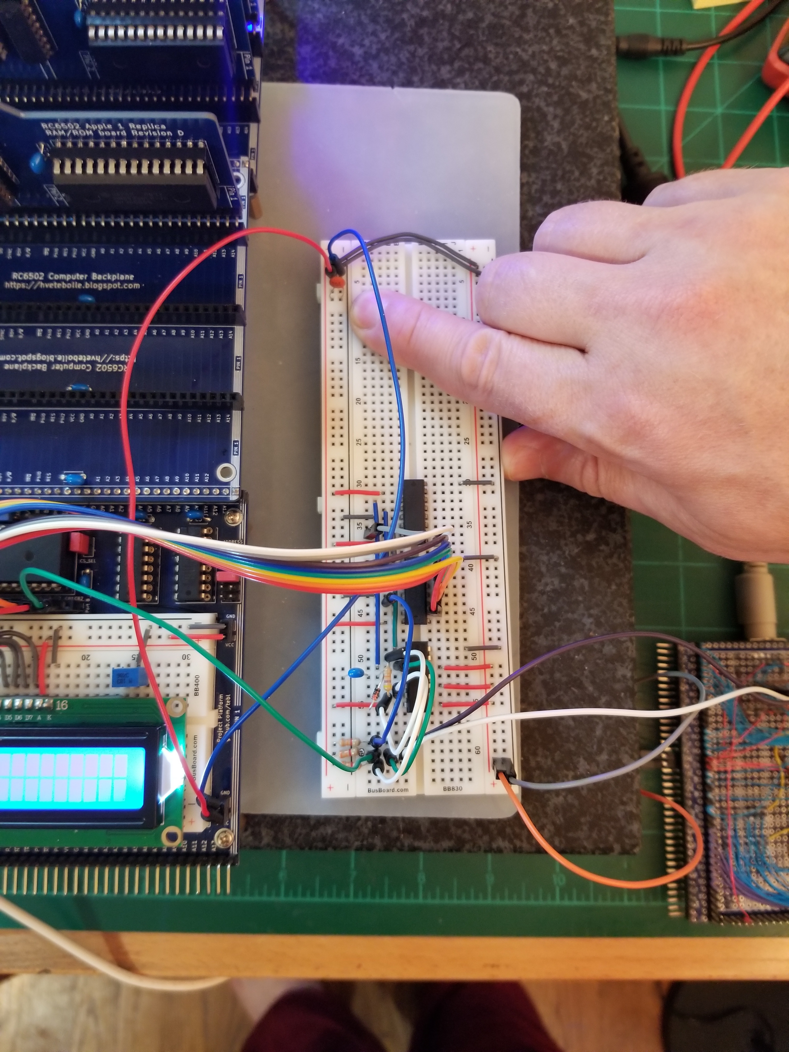

Next I think I will have another try at making a more permanent keyboard circuit on my perf-board. I ordered some better wire-wrap wire (I hope!). The wire I was using has PVC insulation that won't fit through my wire-wrap tool the way it does in Garth's primer. I ordered a spool of Kynar wire; hopefully that will work better!
Well, I did that. I tried to make a better ground / vcc network, and be more conscientious about making every wrap be a good quality one. I also rebuilt the whole board, including the LCD part that already worked. Here it is:
Once again, it only kinda works. Just like before, the LCD part works fine, but the keyboard circuit is wonky, as though the RC circuit managing the clock has bad timing, or there is noise on the data line. So, to troubleshoot, I reverse engineered the wire-wrap board. Going point by point with my multimeter, I reconstructed it on a breadboard:
Interestingly, this breadboard version has exactly the same problems as my wire-wrap version: lots of repeated keys, and intermittent incorrect scancodes.

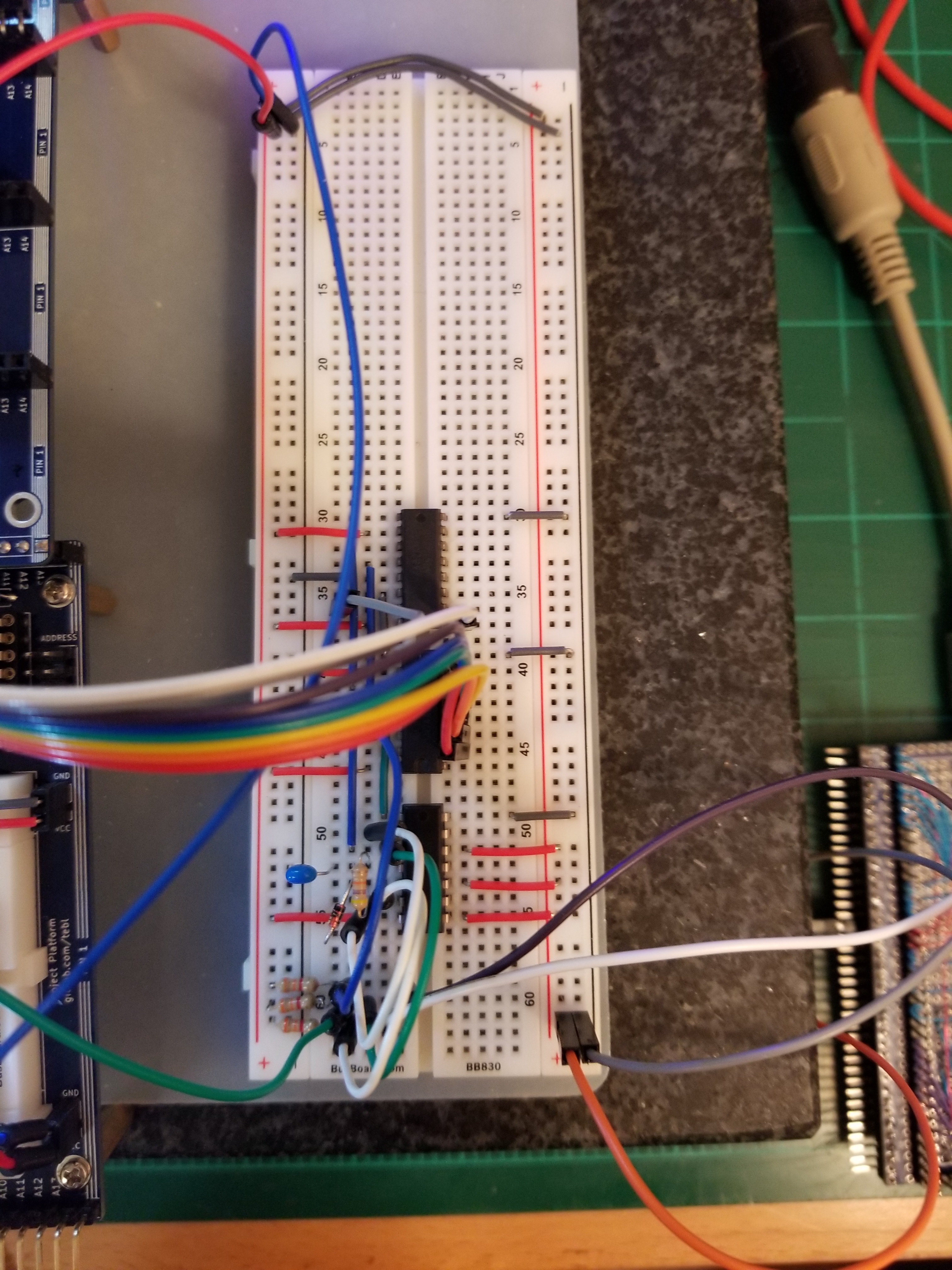

You can see that there is something conspicuously missing from the breadboard reconstruction, though - bypass caps! My wirewrap board does have a bypass cap for each IC, and I did put them on the breadboard during reverse engineering, but I took them back off again for dramatic effect. They don't seem to make any difference. But this one does:
I can put that cap anywhere on that side of the breadboard, and everything immediately starts working. If I put it on the other set of power rails (which is where I initially had all the per-IC decoupling caps) it has no effect.
If I only I can figure out the equivalent "magic spot" on my wire-wrap board and add a capacitor there...

However, I suspect the problem you described earlier is entirely due to poor power/ground distribution (icluding poor use of bypass capacitors). I hate to tell you, but the 'scope probably won't be helpful in correcting this. :| In fact, an inexperienced 'scope user could easily end up misinterpreting what's on screen and end up going on a wild goose chase.
So, I don't wish to discourage you. The scope will certainly be an asset in future. But if your first priority is to fix the problem at hand, I suggest you review and improve the power/ground situation (rather than trying to analytically "pinpoint the problem" using the scope).
No need for hate! :D I expect it will be a while before I can do anything useful with the scope. It has to get here first; then I have to see what, if any, reconditioning it needs, and then I'll have to learn how to use it! Getting a scope right now wasn't really part of the plan; I just happened to get lucky this particular eBay run.
Scope or no scope, if I can get the keyboard circuit to work on a breadboard, I think I ought to be able to get it to work on perfboard. Since the two are logically identical and the only difference is in the construction, I think you certainly must be right about power / ground. The circuit is a pretty simple one - not counting decoupling capacitors, it has only 3 ICs, a diode, a capacitor, and 4 resistors. The protoboard I'm using is specifically for the RC6502 - it has the bus pins along the bottom, a GND rail across the top, and a VCC rail down the right hand side. The majority of the board is a simple grid of plated through-holes; no strips or busing.
My first try I just ran one wire directly from each power pin to the appropriate power rail. My second try I daisy-chained all the VCC pins to each other and all the GND pins to each other, and than ran a few wires from the rails to make connections in various points. I saw some ads in an old magazine (and an old thread here) that showed some IC sockets with integrated decoupling capacitors, so I tried to make some like that - I put the sockets on the board, then soldered the capacitors diagonally across the power / ground pins on the underside. That doesn't seem to be working though...

How they line up won't make much difference. But what will is the the bypass capacitors and the power and ground connections.
(Of course it's possible you have some other problems as well. For example, the intermittent incorrect scancodes you reported could indicate a logic design flaw, rather than a power supply issue. Or it could be caused by both. But my point is, the scancodes are not the only symptom. And proper power distribution and bypassing will be required in any case, so that's the logical place to start.)
Here is a post you might find helpful, based on the following theme: "It's best to avoid thinking of the Power & Ground Distribution network as something for connecting the chips to the power supply. Where high frequencies are concerned, its real job is to connect the chips to one another."
And I could load you up with lots more reading material :roll: but here's another alternative. Share with us a photo or a diagram that reveals the route taken by the ground connections, the route taken by the power connections, and where the chips and caps are attached. And we'll suggest improvements.
