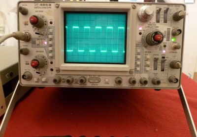

As for used analog 'scopes, about 2 years ago I got a very nice Tektonix 465B on E-Bay for USD 120. (I paid the asking price.) It had a deflection problem but was still usable in spite of that. I repaired the problem anyway, and I've been very pleased with my purchase.

Every so often I troll eBay for one of those used Tektronix analog scopes. I think they're just what I want; the problem is that they're usually "for parts / repair only" and I am not even close to knowledgeable enough to try fixing one. "EEEVBlog" Dave has a talk about people just giving them away, or finding them for $50 on eBay. That doesn't seem to be case any longer, unfortunately.
