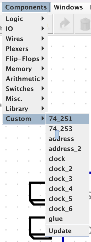

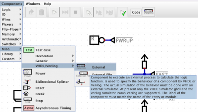

In Digital, you can implement ICs as Digital files, and include them in higher level circuits. They appear in the Custom menu if they are saved next to your current file. I recommend watching rj45's series to learn more about it https://www.youtube.com/playlist?list=P ... I7pCWsy1AO
I believe you can also write external components in VHDL and Verilog, though the documentation is scarce and I have never tried it myself

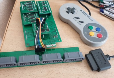

SNES controller
I quite like your SNES circuits and I am very impressed with your soldering. SNES protocol is a good test and SNES protocol can be practically extended to a range of input peripherals which includes keyboard and mouse.
AndrewP on Sun 27 Mar 2022 wrote:
Dang it! I bought four SNES joypads with the 9 pin D connector. I assumed that the socket would be easier to source and that the pins would vary less. Presumably, that's why you have an adapter board.
Thanks! That's much appreciated. I really wish the SNES protocol was the way keyboards and mouses had gone. I've simulated up a PS/2 circuit for a keyboard and mouse but not having the '816 be the master is a huge pain. Really, why can't we just have big shift registers on a single IC? Even better a 128bit shift register addressable over an 8bit port. That would be wonderful.
Kinda, I'm mostly assuming I'm going to have multiple versions of the PCB with all the circuitry on it and don't want to waste (or re-solder) connectors every time I make a change. I ended up buying 40 connectors off of Ebay because the postage to South Africa was the majority of the cost. Yay for living in the middle of nowhere!

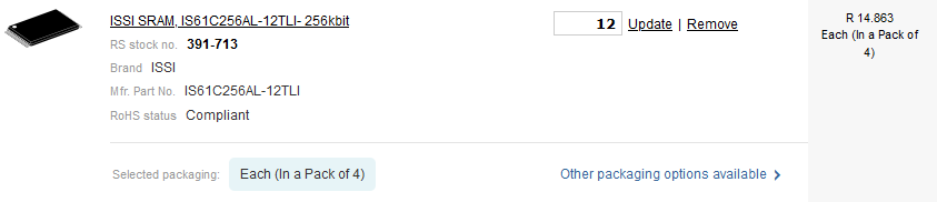

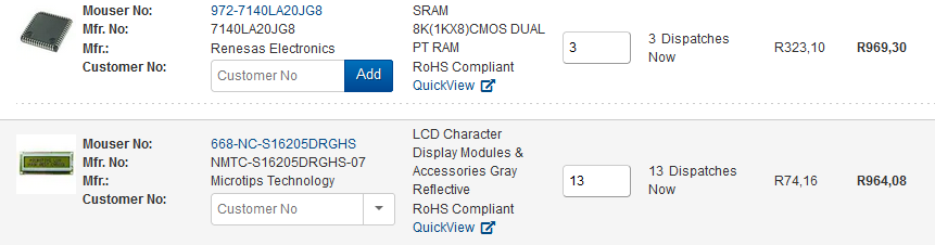

Dual port memory is fast, highly reliable and allows sub-systems of any frequency to be spliced together.... dual port RAM isn't the cheapest option.
Dual port memory would solve so many of my async problems. And so simply. But it's just SO expensive that I can't justify using it. To put it in perspective: I can buy 13 LCD display for the cost of just 3 tiny 1KB dual port ICs.
Or even more in perspective:
I could buy 23 32KB SRAMs for the price of a single 1KB dual port SRAM.
(Why do I have 13 LCD character displays sitting in my cart? I have no idea).

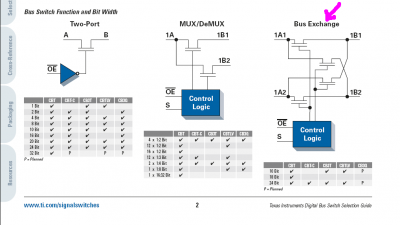

The solution I have found (but not tested at high frequencies) is to have two SRAMS that I can explicitly trigger a swap between. i.e. The MPU writes to memory A while the video DAC reads from memory B and then during a know phase where the video DAC isn't using memory the MPU triggers a swap. It's quite a few ICs (multiplexers and transceivers etc...) to allow the 'swap' - I posted a simpl'ish implementation somewhere else in this forum.

AndrewP wrote:
Dual port memory would solve so many of my async problems. And so simply. But it's just SO expensive that I can't justify using it. [...]
The solution I have found (but not tested at high frequencies) is to have two SRAMS that I can explicitly trigger a swap between. [...]
Perhaps you're already aware, but specialized multiplexers are available for this purpose. Here's some TI doc (and maybe there are offerings from other manufacturers, too). Compared with doing things "the hard way," the Bus Exchange function shrinks the pin count substantially.
bus switch selection scdb006a.pdf [719.31 KiB]
Thanks! That sent me on a learning spree... and to a section of Mouser I've never visited before Digital Bus Switch ICs. Although I may be sternly eyeballed if I order another box of ICs :D

I've harassed utsource quite a bit* trying to find dual port SRAM but with no luck. I haven't tried anything with access times over 20ns so that will need to be my next port of call.
* Looks like I've tried to find 7140LA20JG8, 7140LA20JG, 7140LA20PF, 7140LA20JG8, 7140LA20PF8 and 7140LA20J
