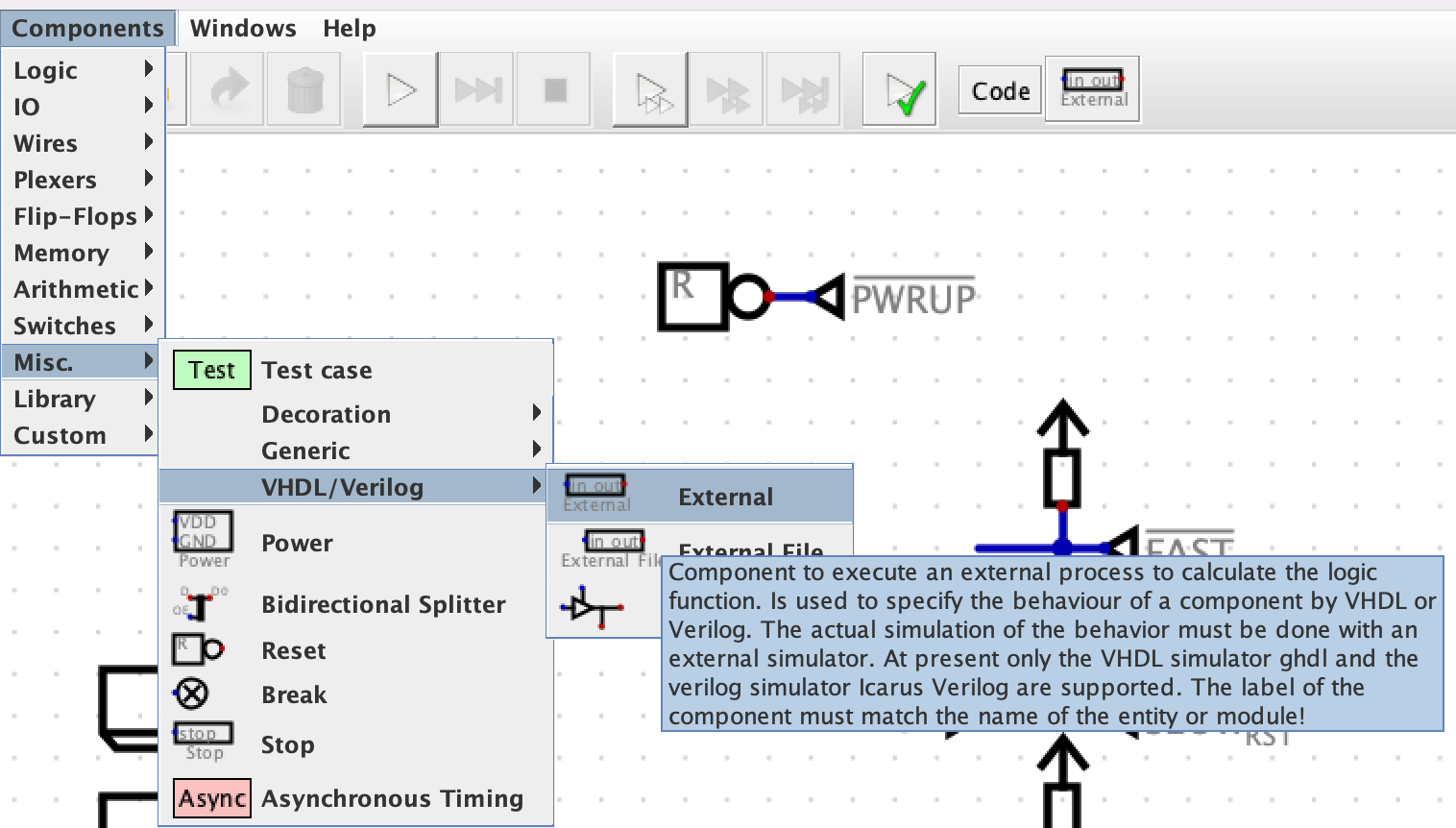

In Digital, you can implement ICs as Digital files, and include them in higher level circuits. They appear in the Custom menu if they are saved next to your current file. I recommend watching rj45's series to learn more about it https://www.youtube.com/playlist?list=P ... I7pCWsy1AO
I believe you can also write external components in VHDL and Verilog, though the documentation is scarce and I have never tried it myself

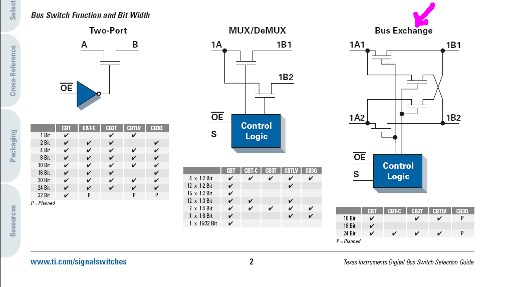

PostPosted: Sun Jul 10, 2022 2:23 pm
AndrewP wrote:
Dual port memory would solve so many of my async problems. And so simply. But it's just SO expensive that I can't justify using it. [...]
The solution I have found (but not tested at high frequencies) is to have two SRAMS that I can explicitly trigger a swap between. [...]
It's quite a few ICs (multiplexers and transceivers etc...) to allow the 'swap'
Perhaps you're already aware, but specialized multiplexers are available for this purpose. Here's some TI doc (and maybe there are offerings from other manufacturers, too). Compared with doing things "the hard way," the Bus Exchange function shrinks the pin count substantially.
bus switch selection scdb006a.pdf [719.31 KiB]
Downloaded 90 times
