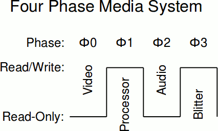

Many of us want our 6502/65816 systems to be relevant - or sufficient to use as our primary computer. Many of us want our systems to be fast and maybe a little flashy in a world where highly visual work gains dis-proportionate attention. And many of us would like like to achieve that with a blitter. Even BigDumbDinosaur (who is best known for multiple alternate pursuits involving the robust fabrication of metal, the development of robust filing systems, serious business applications and a compact no-nonsense approach to operating systems) wants faster block copy:

2D blitting is a special case which is most useful for bitmap graphics. Beyond that, I'm sure what anyone would like in a 65xx compatible blitter. I presume that copying from arbitrary offsets is highly desirable, although, perhaps page alignment is sufficient. I presume that 1D block copies larger than one page are highly desirable. I also presume that alternate cycles should be read and write. I also assume that an interrupt scheme similar to the GameTank is high desirable. Specifically, an interrupt occurs when the blitter is finished.
There is the problem of blitter priority. If a blitter steals all bus cycles then the processor is halted and doesn't respond to interrupts. That is invariably a problem in any system involving, high throughput storage, UART, Ethernet or video. However, if the blitter is bottom priority then it only uses dead cycles. If you are persistently good at avoiding some addressing modes then the guaranteed bandwidth available to a blitter is zero and this easier to achieve when 65816 is in native mode. The halfway hedge of alternate processor and blitter cycles is also undesirable because it increases interrupt jitter. Apart from that limitation, equal priority solves many problems very economically. For example, it is possible to make a discrete or FPGA, one RAM chip, four phase system where:
  • Phase 0: Read-only video cycle.
  • Phase 1: Read/write processor cycle.
  • Phase 2: Read-only audio cycle.
  • Phase 3: Read/write blitter cycle.
In particular, phase 2 or phase 3 can be forfeited. Don't use sound? Have double video resolution. Don't use blitter? Have double processor bandwidth. Using one contemporary 50 cent SRAM, I believe this arrangement approaches or matches the bus bandwidth of a Commodore Amiga 500. Unfortunately, unlike the GameTank which uses dual port RAM to decouple different parts of the system, all of this would be tied to one clock - and that would probably be 25MHz or so for 640*480 VGA or 28MHz or so for NTSC. That means audio may only play at one awkward rate, which varies according to display preference. Also, like the Amiga, it is very good at outputting video and audio but absolutely terrible for inputting video and audio. The main advantage of this arrangement is that it always avoids two sequential writes. Overall, it is a quick hack to get 1990s performance from one SRAM.

four-phase-media0-0-0.odg [5.76 KiB]
Downloaded 40 times
