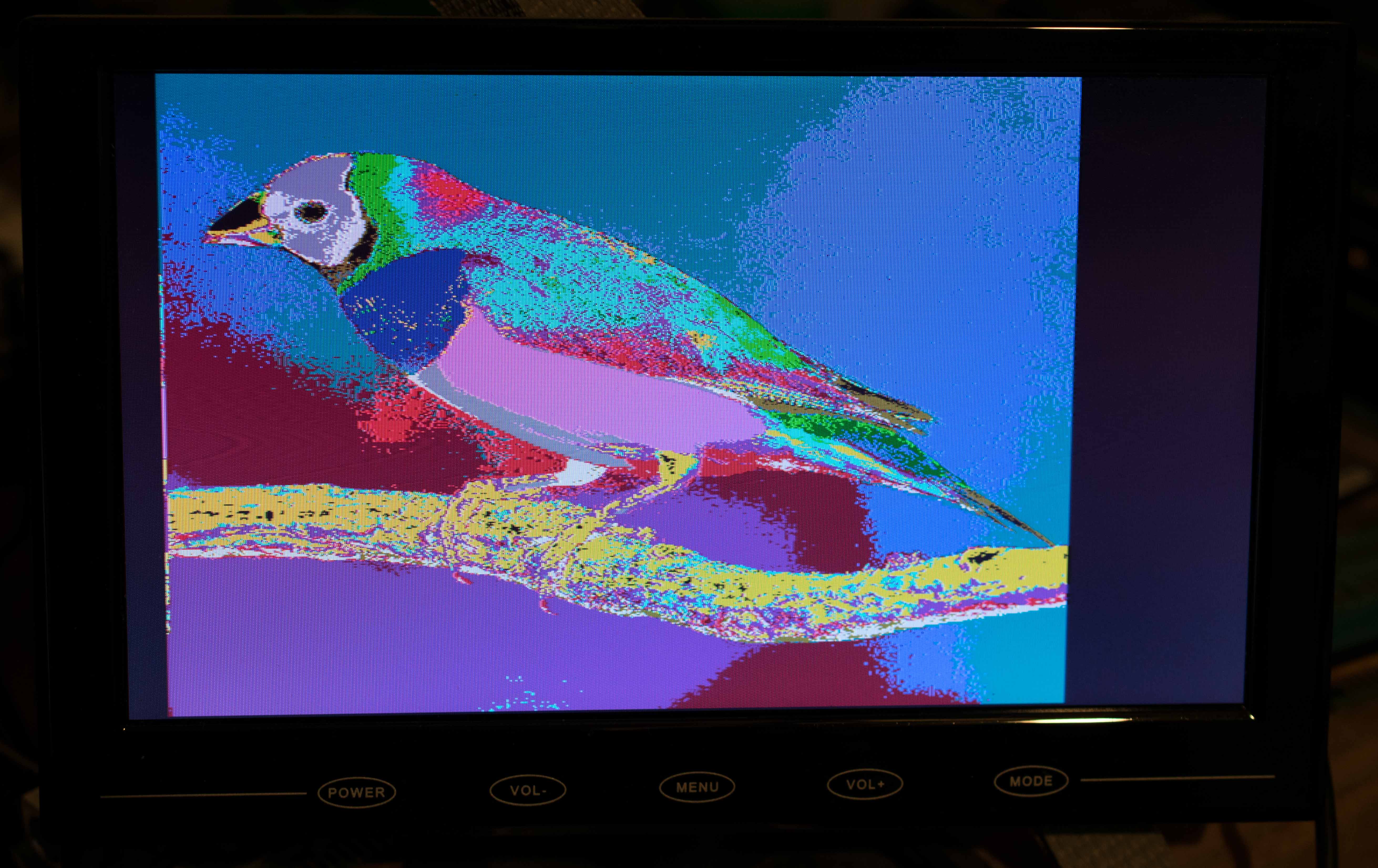

Nice bird! Your resolution makes mine look like a toy :) I really like the 15 color palette, it really "pops" and that's super important. Minus one color seems totally worth it. Which diode did you use in particular? It just says "schottky diode" on the schematic, no other identification.
Great job Bill! Looks great!

The Schotty diode I used is 1N5817, a general diode that's readily available on eBay.
It is hard to take picture that accurately represent the colors on the monitor. The picture posted yesterday was a good representation of what's on the monitor, but many of my earlier pictures were washed out and that may be the case with other's monitor images.

I used Photoshop to convert "finch.jpg", a 512x480 image to 16-color image and save it as 4-bit BMP file. Converted the .BMP file to .HEX file with BIN2HEX. Because the data file is larger than 6502 memory can hold (.BMP data file is 122K), I created a program that reads in .HEX file and saves it directly to graphic memory. Because I can write to the graphic memory anytime, I don't need to worry about buffering up the .HEX data stream and find the right time to transfer data. It all worked out except the color mapping is not right. I'll need to change the color mapping in CPLD.
CRC65 has CF mass storage so now is time to think about a filing system for collection of .BMP files so I can retrieve images from CF disk directly.

Looks good Bill! I think it is a good thing that you can change the color mapping on the CPLD, very easy.
So, I've worked with .bmp files for a long time over the years. I don't think of them as 'binary' files, so much as RGB color values. But hey, if this BIN2HEX works for you, neat!
One last thing: Whenever I am working with .bmp files, for some reason it always reads out as BGR instead. So maybe that's why your colormap is off some? Just a guess.

Yes, I would like to see your Python example. I know there are online image converter as well. I can also tweak the CPLD design to be compatible with the image conversion output.
