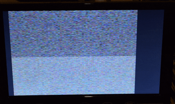

Attached is an animated GIF of three test patterns. I can write the video image anytime, but it still takes a while to fill 128KB of image with 12.6MHz 6502, about 1/2 second per pattern. This is where smaller sprites can produce smooth moving picture.
I'm also looking into the "snowing" effect as the images are updated. I believe the correct image is written into RAM and there are no conflict with VGA controller's read access, but I'm dealing with an analog system so digital noises can cause the snowing effect. This is where 4-layer PC board with separate analog section may be necessary to get best image.

You are correct that each 4K windows will draw 16 lines on the screen. I have not centered the image, yet. I just want to make it work first without muddying the water.
Sprites, layering, mixing text & image, I predict I'll be spending lots of time playing with the video card.

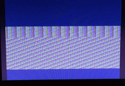

I continue to work on Apple II style of multiplexing video access with 6502 access. This is the pc board version of the prototype board with additional text-to-VGA dual-port RAM (not populated in the picture) and PS2 keyboard connector. I use a larger-than-normal CPLD, EPM7192S, to give me more room for experimentation. I believe I can overlay text over graphic background, but I'm also thinking about using the dual-port RAM as buffer for sprites that overlay the graphic background. The connector at bottom is for RC6502 bus and designed to interface with CRC65 SBC. In this configuration CRC65 is operating at 25.175/2=12.6MHz. The graphic memory is 128K with 512x480 display area. The color depth is limited to RGB plus 50% intensity bit.
Good thing about multiplexing video access with 6502 access is the graphic RAM can be access any time at full 12.6MHz speed. Below is a video of CRC65 @ 12.6MHz writing test patterns to 64KB out of 128KB of graphic memory. I want half of the graphic display stay in blue background while writing, as fast as possible, other half with test patterns to look for "snow effect". I'm happy to report that there is no "snow effect".

The glitch on the left can be fixed by referencing a 1 cycle delayed copy of the pixel clock during the active display area.
